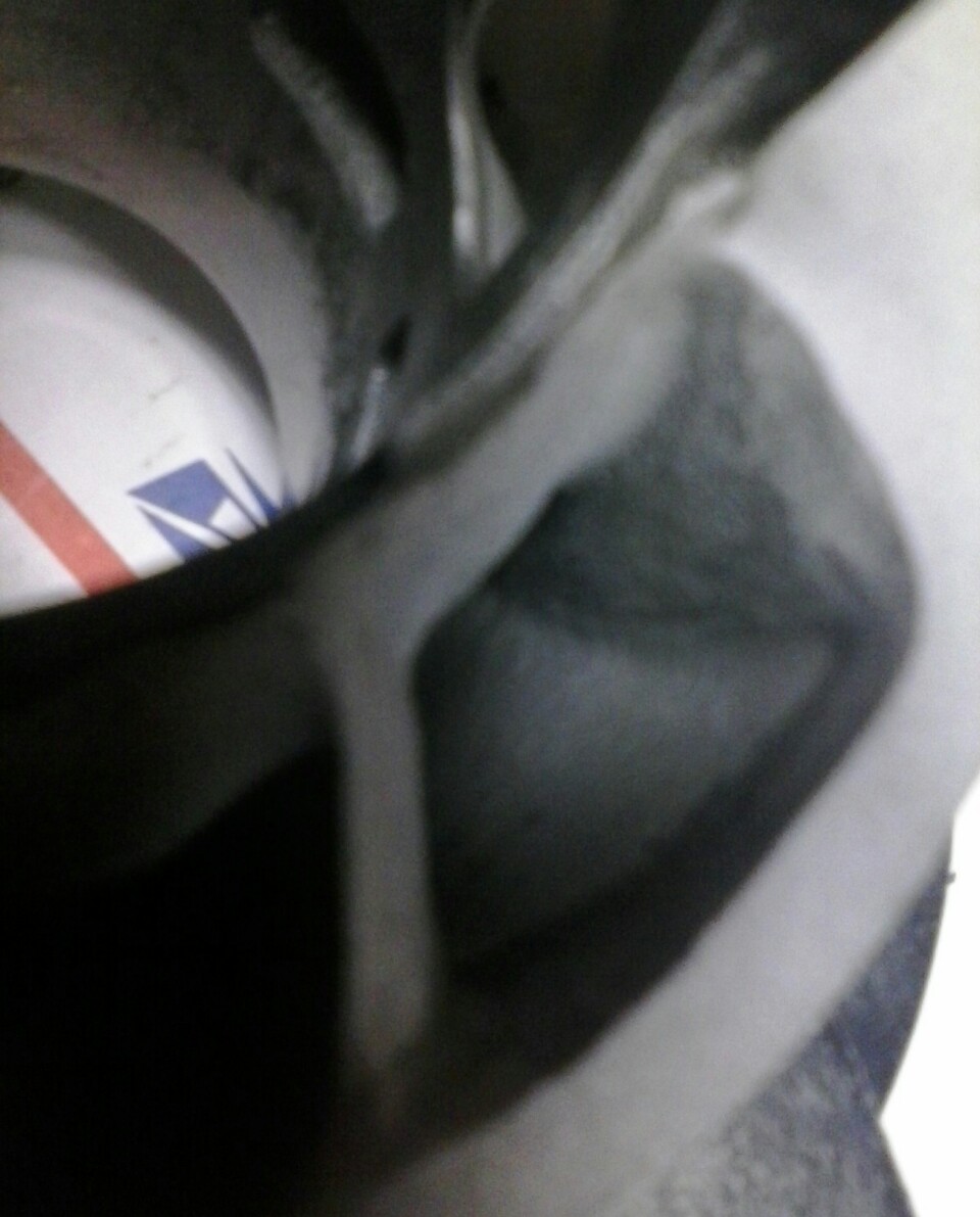

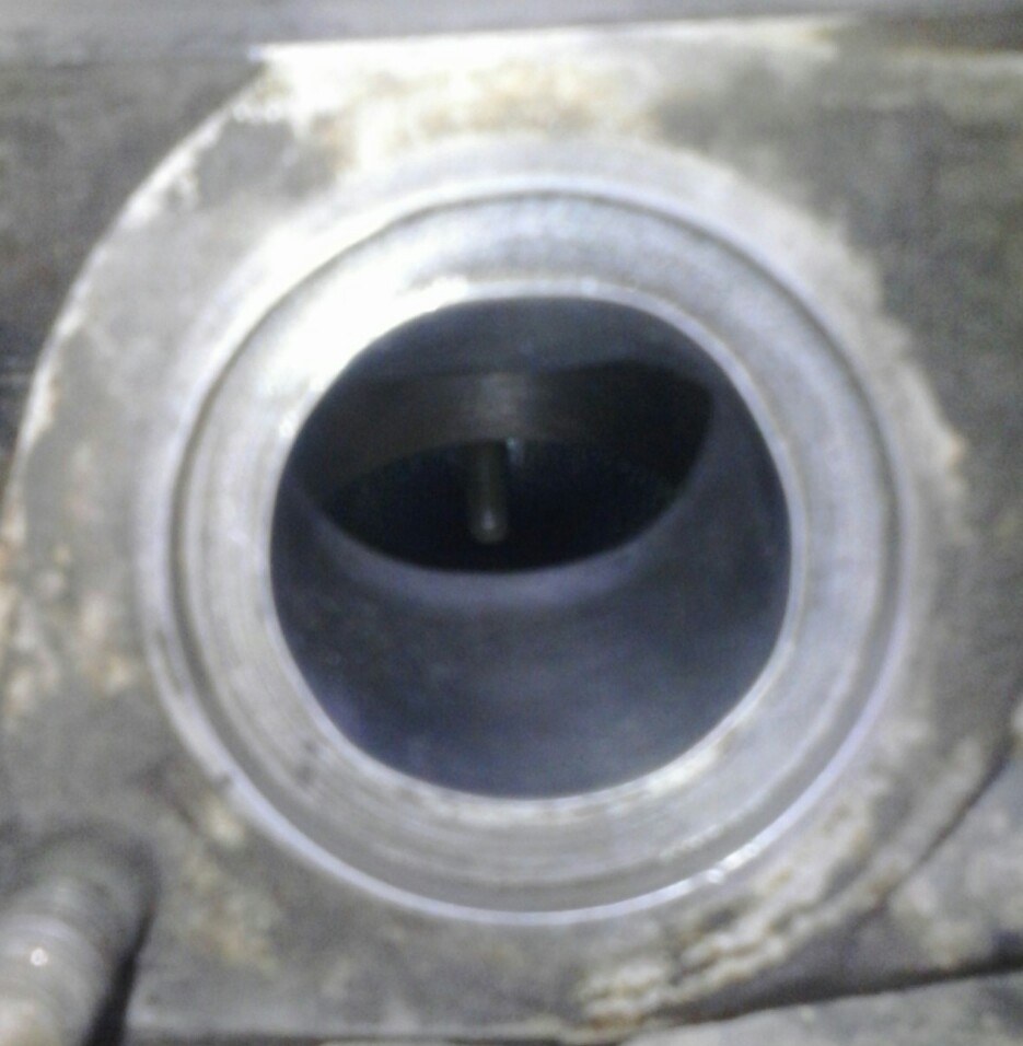

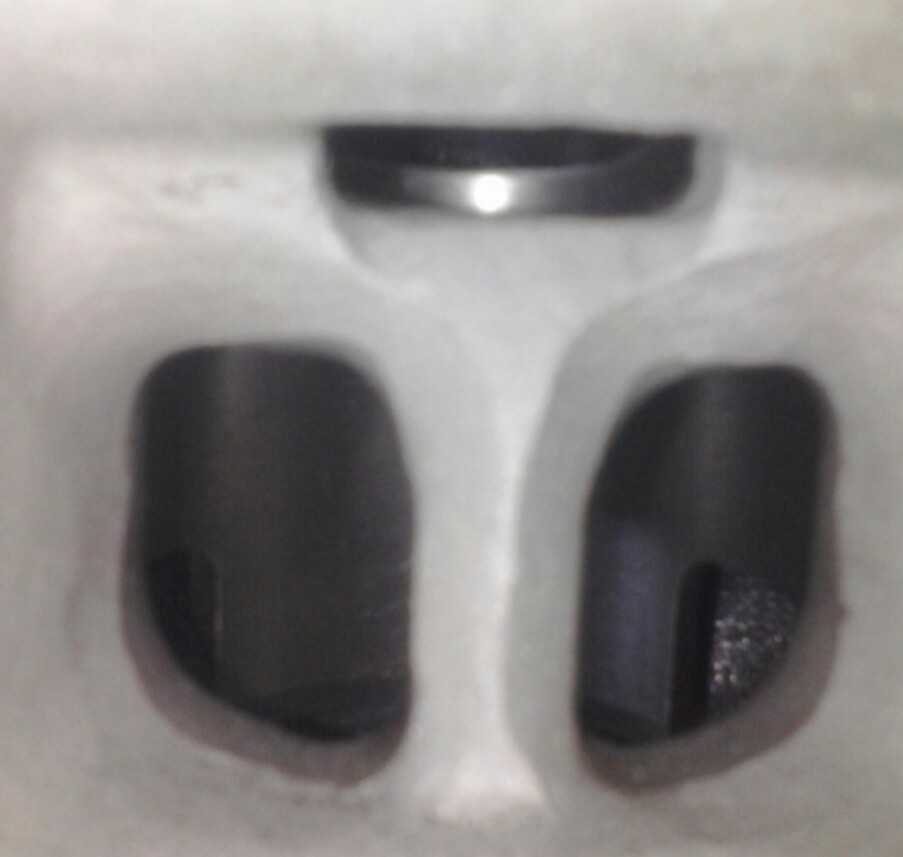

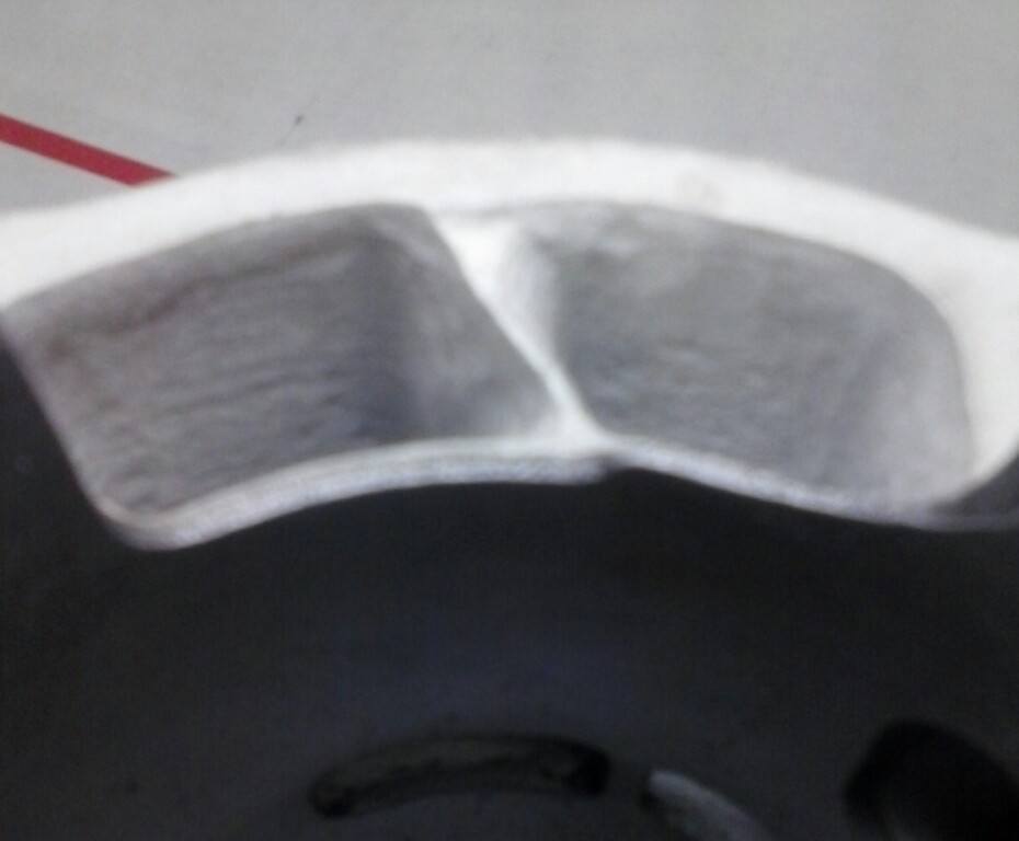

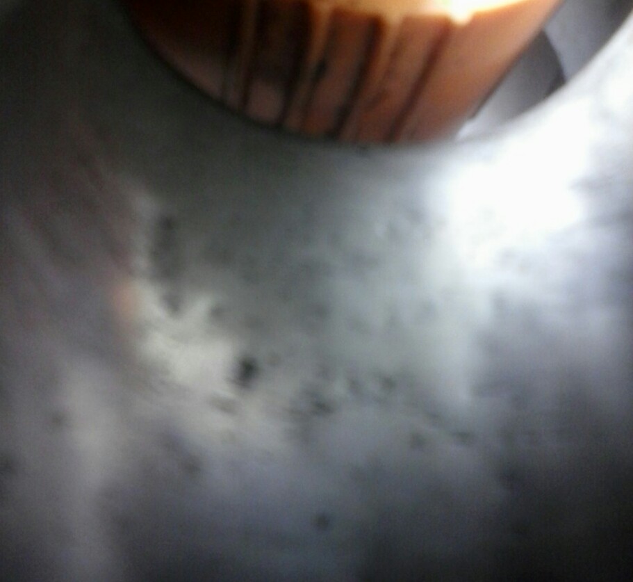

Not very pleased to say the least. After cleaning all the sand out I can see where the burr rand around in the cyl bore. The exhaust port is not matched to the gasket. The transfer ports where it comes into the bore are untouched with casting buggers/snots. Everything is crooked and pitted/wavy.
I am not trying to be harsh to the porter in anyway I am just stating the facts. The one thing I do see that is decent is the curve of the exhaust port on the bore side is consistent and even considering it was raised a considerable amount.
I also guess I have to chamfer my own ports? I could be wrong but I thought that was included in port jobs ?
Will my cyl hone out or will I need a new bore?
