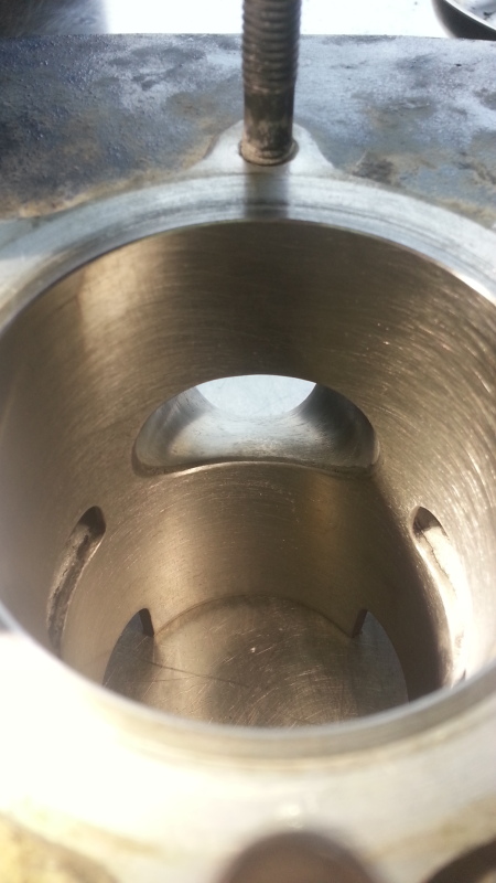

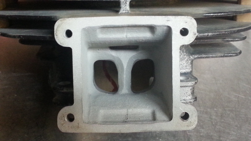

YoungGunsRacing offered some free porting for a blaster cylinder so I obliged. The cylinder I am sending is a complete stock 66mm cylinder and head from a completely stock blaster other than an Fmf exhaust and an outwears cover over the air box. I know exactly how this bike runs since its the Blaster most ridden while the other is under construction, therefore perfect for a before and after comparison. I just got the cylinder off and will be shipping it out by Monday. I will update as time goes.
I will post some before pics of the cyl when I get a chance.
Thanks again to YoungGunsRacing
I will also be sending in a stock cylinder that is at 66mm bore. I won't be sending in the head since I have the ability to cut my own heads. Jon said he would tell me how much to take off after the port work. I plan on running this cylinder on my personal bike which I ran a stock unported cylinder on for a while. I have already taken pics before the port work and will take after pics. My cylinder will be heading out to YoungGunRacing on monday also

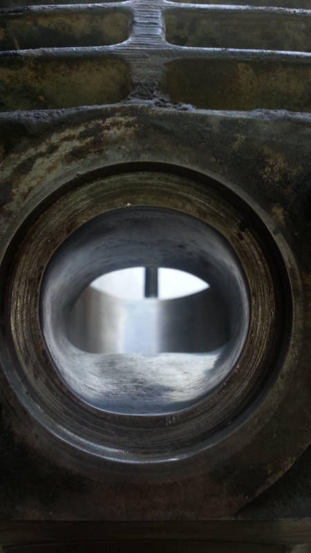

Before port work pictures.

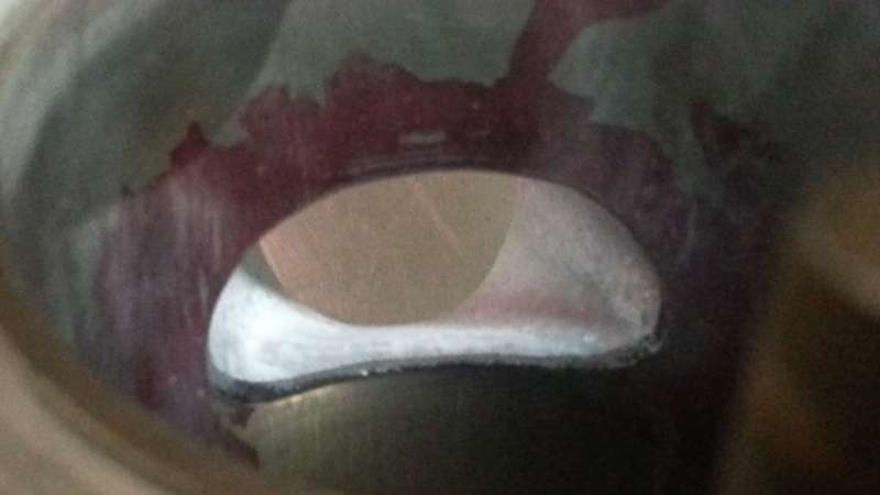

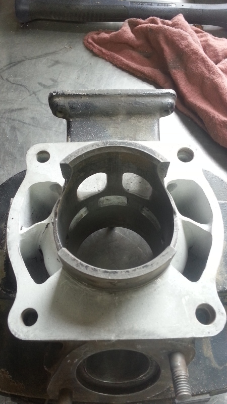

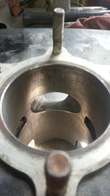

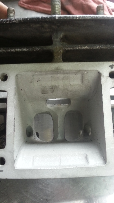

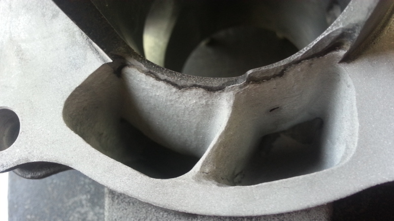

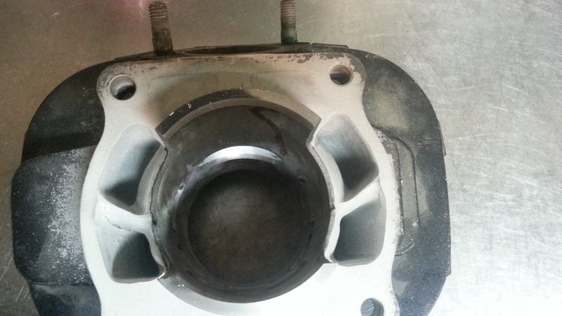

These are just a few pics of jus_me's cylinder I received and have been working on. I still have to finish out the exhaust port and clean up a few more things but it has been coming along very well. Hope you all.enjoy! :

Boysens will not net this particular cylinder much more usable power. Boysens really start to shine when they are used in more "aggressive" builds. They have to have considerable size as well to be noticeably effective. A few small drill holes will do no good. On a dyno we've ran banshee cylinders with and without them and the noted difference was minute (not even .5 hp) and less than a 1ft lb of torque gained. Some folks like to use them, some folks do not. If this customer had it set in his mind he HAD to have boysen ports - I would add them no problem.

Jus_me's cylinder is finished. Theres still a little bit of factory powder in the transfers for some sections I couldnt show a ton of attention to - nontheless I am happy with it and confident in the performance it will bring. Now we will get the head re chambered and all sorted out and once thats taken care of we can ship it back to him.
