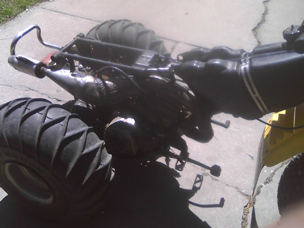

Before i start, everything can be found here. And yes, all i had was an 220 AC arc welder lol
It is designed to peak at 8500RPM, port timing is 185 exhaust 118 transfers, with triples welded intake with extra large boyesens. Reeds have been upgraded to a blaster reed cage with power reeds. blaster carb(i have a 28-29mm round slide for it). Nicer than blaster carb at least.
It's flywheel is maybe 6 ounces less than the blaster, no counter balance shaft, auto clutch modded to stall out until maybe 3-4k RPM. Pod filter. Plenty of torque, Power band is very wide. The ass dyno says it pulls from 5k-8-9k? maybe more lol who knows.. I need a tach.
The pipe is designed to match the port job, and carb size is designed to match the flow rate at my target RPM.
At the dunes, with stock pipe, I passed Nathans blaster going up the dunes lol. Always fun to up-shift flying up dunes :)
That thing weighs to much for that engine though. 220lb on a 175cc engine? it needs to go on a diet.. I just don't know what can be removed lol

Math and program all the way. Designed it to match my port job as best as I could. I'm going to be building 1 for a blaster soon. Nate is going to port it and I'll be making the pipe for it.
LOL I'm with paulie. The look of the pipe just tickled me.
The real question is, how does it perform?

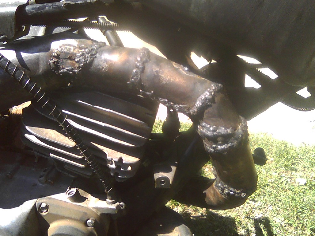

Edit: I re-read and saw 220V arc welder. You did REALLY well to get it as good as it is with that equipment. Obviously that's not optimal for building thin walled 2 stroke pipes but you have to use what you have!
If this is going to be a regular thing, Harbor Freight sells a scratch start DC only tig welder (about 90 amps max which would work really well for the thin wall pipes) for about $250. Spread the cost of that among a handful of handmade pipes and you could actually justify it. Get that and a small cone roller and you COULD make good looking pipes which would probably perform really well ( I only say could because I don't know you or your fab skills that well, some people have "it" and some people don't)
rubber salt is my lil bro gabe and he passed me once when my clutch was slippn halfway through the gears and would finally hook then bog in too high of a gear but that thing does great for climbing, lots of bottom end/ also I have a 220v mig welder that he can use but i was busy and he wont wait ( cant blame him ).I personally couldn't have done as good of a job with his arc welder. I told him if he would grind about 80% of that weld down it would save a few pounds. The pipe is very functional though and preforms outstanding compared to stock. We both know his tryke is fast but my blaster will eat its lunch all day now that i fixed the clutch. Spywells wilderbeast of a quad was stolen recently and gabe gave up his first blaster to his friend to replace it. We are going to start hand building pipes to different specs and try our hand at pipe tuning. Once i have a pipe that is optimal and proven I will atempt to build a press and dies to stamp a few out. Gabe has several different pipe calculating programs and is good w numbers. this would be another thread all together:)

When i was done with that pipe, i had Spywell pick it up then pick up the stock pipe.. The weight confused him - damn near the same!! lol
That 18guage steel sure is heavy for a pipe. Only advantage i see with it is it will retain the heat better, making the pipe more consistent with the power.
The pipe starts pulling way before the stock pipe, pulls longer, revs higher, and pulls MUCH MUCH harder. I did grind the welds out of the inside as I pieced it together. For a prototype, I was impressed how much better it performed compared to stock. The next pipe will be made with that mig welder of Nate's.
I like having bottom mid/top end power. But I have to have bottom end due to my auto clutch. So everything about my engine is designed with every component. Unlike having some one port it, then buying a top end pipe that bolts on, then a carb that is bigger/upgrade... Does the pipe match the port job? Does the carb match the rpm/displacement? Everything of mine is tuned to itself - it's an awesome little ride :)
Maybe I'll start a new thread and start inputting data and posting up some calculations made by my programs... for the next pipe - for reference when i go to build it.
***I did start with a CR125 pipe. After measuring everything, thebelly was the only part that was EXACT to what i needed, so I used that. I cheated, I'll admit to it lol. The next will be all me though.
