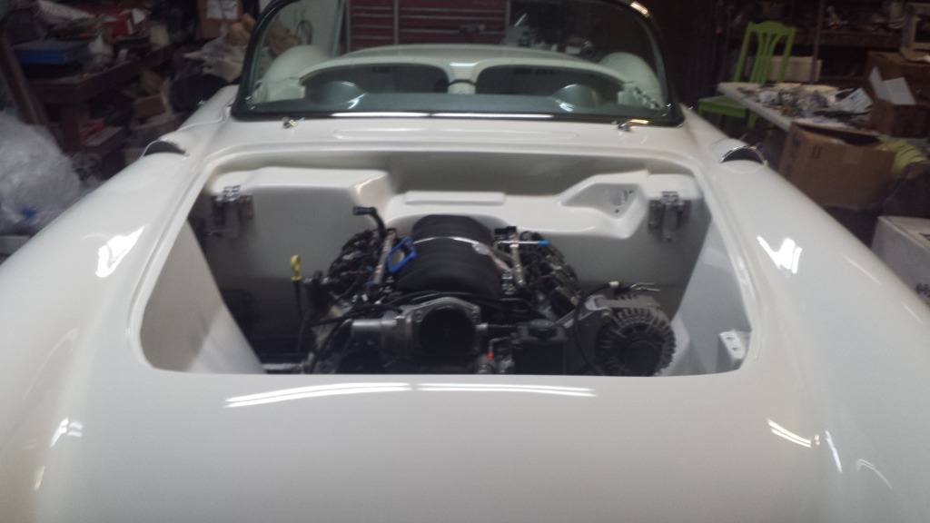

Here's the 57 almost done with an ls3 and c4 suspension
awesome no more curse

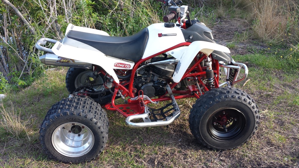

you spoke to soon dude, went out to ride just now and got a couple miles out and lost one of my exhaust studs. needless to say that was a very long and loud ride back followed by pushing it back through my neighborhood, im scared about what might have happend to it
Looks like she's going to be sitting for a while, while I was replacing the exhaust stud, I saw that one of the studs holding the jug on also had snapped off. I'm to pissed to even inspect it further.
If you rode it for a long time without the pipe sealing properly, I would suggest that you check out the piston for detonation damage, as 2 strokes do not like leaks anywhere in the system, they cause a lean condition.
