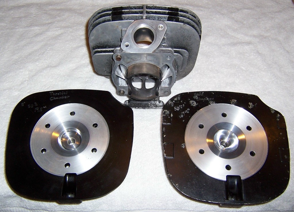

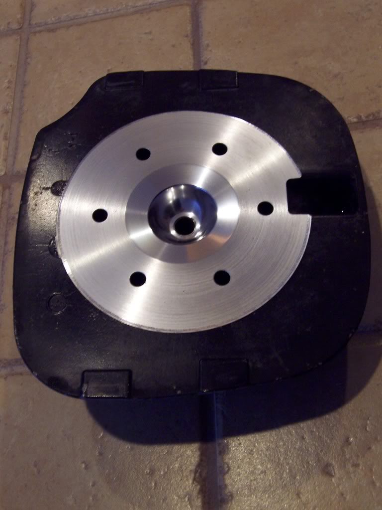

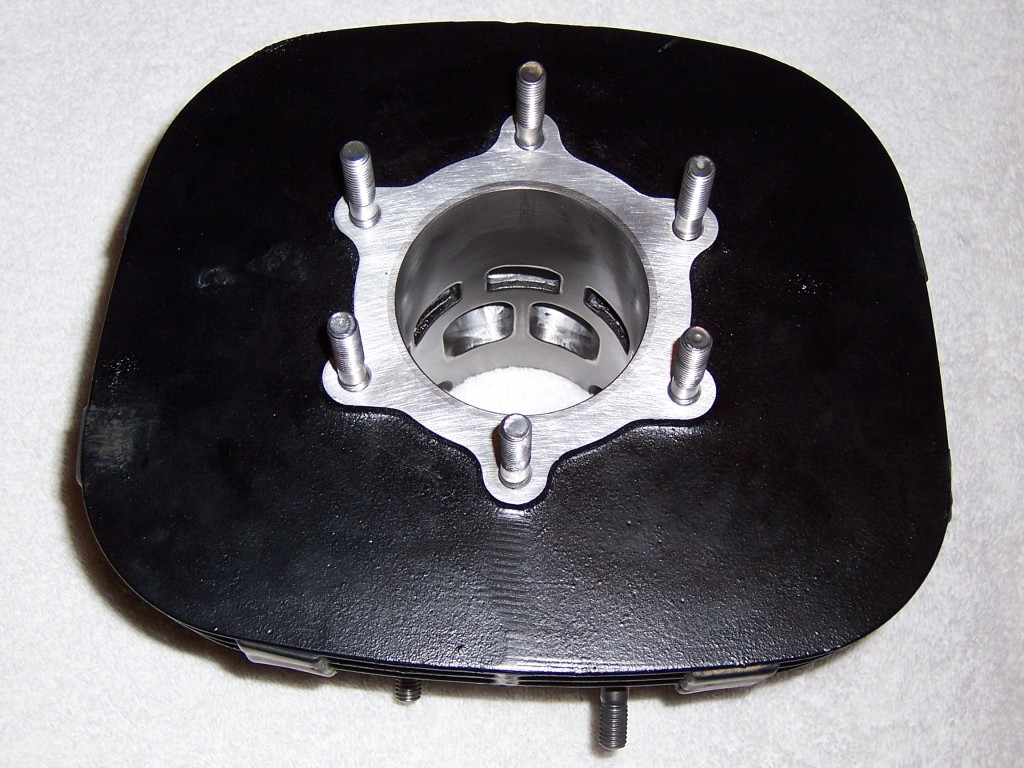

Here some pics! These heads make a world of difference. On a stock bike these heads will make over 30HP when they are only 17HP to begin with. Huge improvement for a low price!
Can you please explain how you came up with that dome shape?What are you cc ing the haedsat?Also do you have any proof of the 30hp claim? Thanks

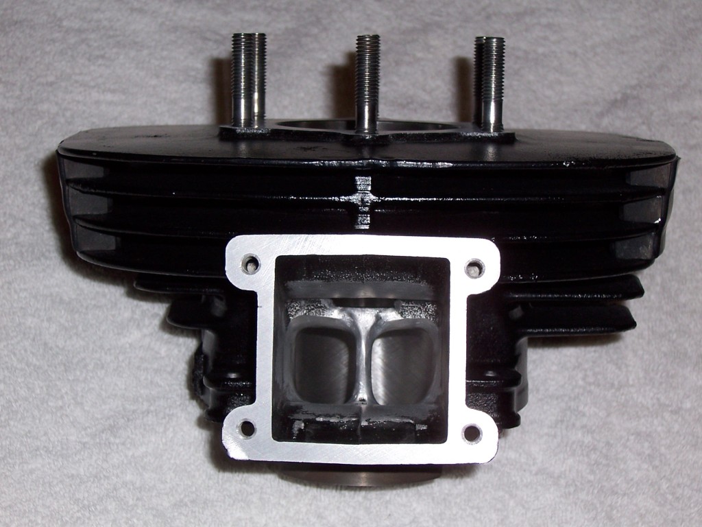

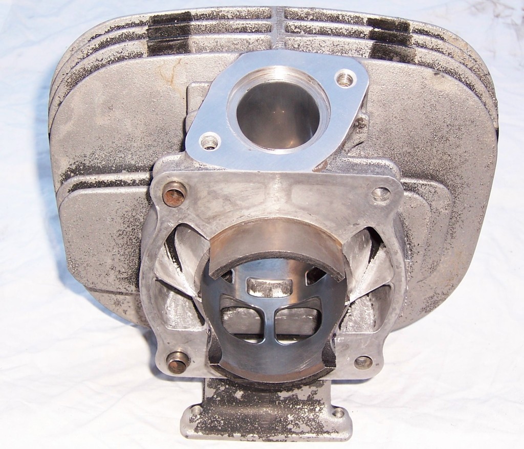

I guess I can chime in a bit too...

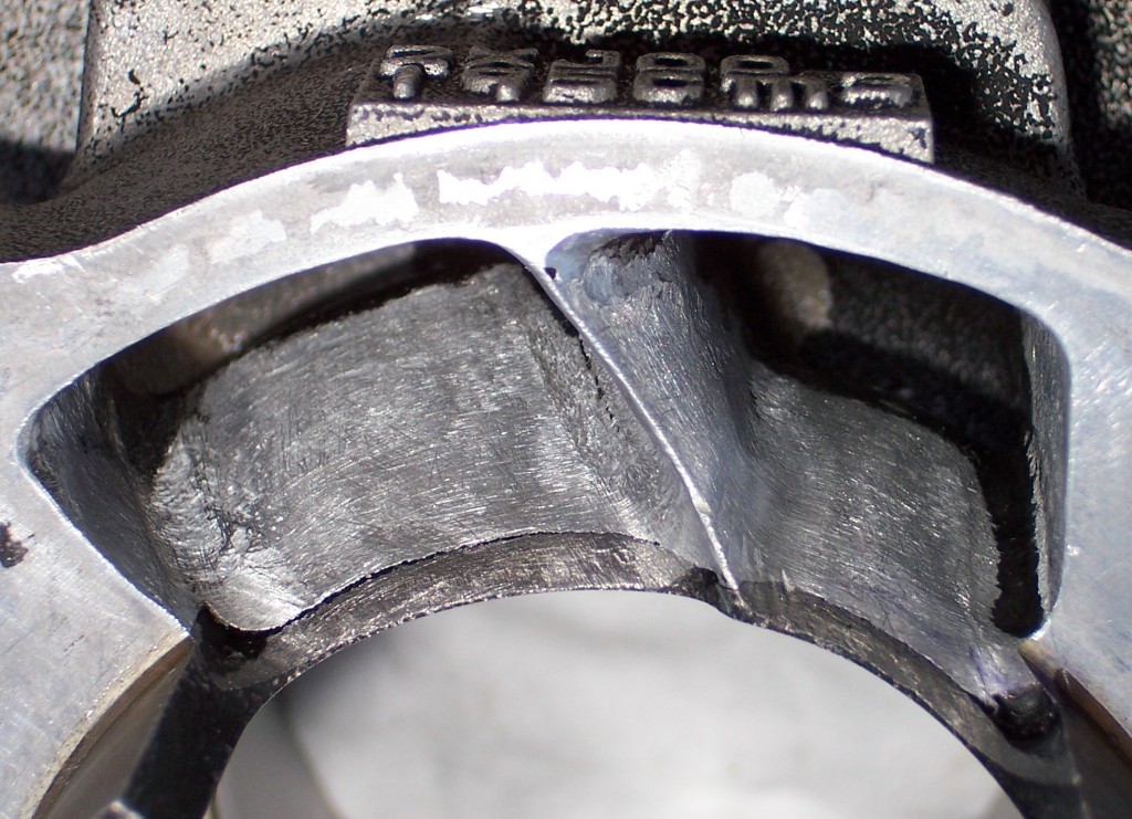

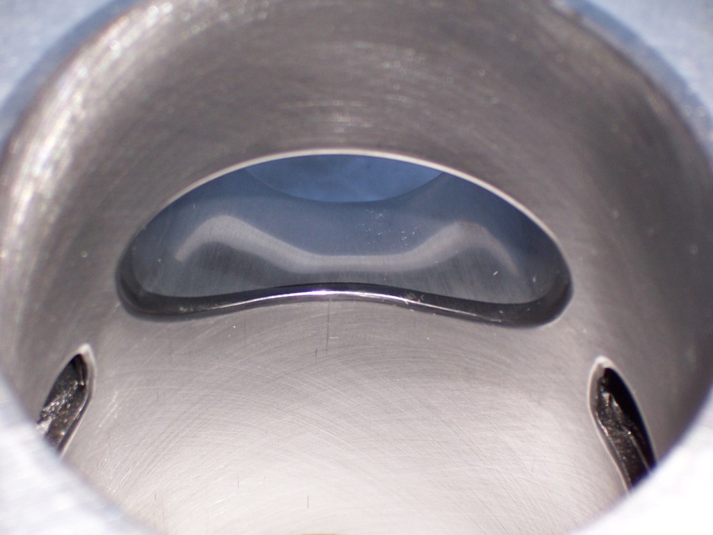

The exhaust port and head is where the power is made in a two stroke engine. Everything has to work together,but the exhaust port is where the power is made. After doing MANY cylinders for the blaster engine,and only playing with the exhaust port shape and size,I can say that without question,its the largest contributing factor in making power. This coupled with a properly designed head and proper squish distance makes an incredible jump in engine output.
Adding a thicker base gasket under the cylinder (this is actually fun to experiment with by using different thicknesses) effectively raises ALL the ports and starts to give the cylinder a much different personality. It raises the "sweet spot" of the power band rpm up much higher in the rpm range. All without grinding on the cylinder,and making something that is non-reversable.
Lower the cylinder and "here comes the torque" at a much lower RPM range. Raise the cylinder,and here comes the "bansheeish" power band.
Yes a performance pipe is what you are going to want,but that stock pipe actually works VERY well. The stock silencer is the choke point.
As for the stock carb being able to hold its own with porting and head re-chambering... No problem! I've have yet to have it fall on its face. A larger carb will help those top/higher RPM's pull harder,but I use the entire rpm range when I ride (fast trails),so I wouldn't see much benefit for me,however I plan to experiment with larger carbs at a later date.

WOW you guys blew up my thread while Ive been gone! Haha.
First of all I posted the 30HP because thats what Ive been told by a couple people on here when I first started re-chambering heads. And I will tell you I believe it! Why? Because of all the mods Ive done to the blasters over the years this mod wakes them up like no other. I have several nearby friends that I have ran my heads on. Their bikes range from completely stock to mild mods. Every one of them felt like they doubled in HP. I also own a 45HP YFZ450. And this mod makes a blaster feel very comparable to a 450 race quad.

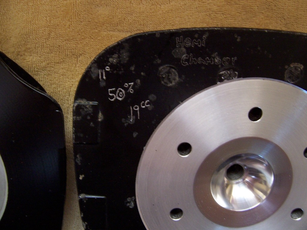

What, if any, are the differences and or similarities between your heads and say KOR or Joe's hemi head ?
Yes its just like them.

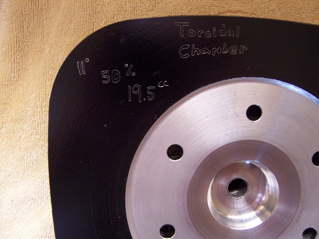

you certainly have a bit of a step where the change from squish band to compression dome is concerned... what is the volume of this head?
Around 20cc's
Whoa! Not so fast there...
It is not an exact copy of their designs and it does not have their 20+ years of engine building and machining experience behind it.
We have to be fair to those guys and give them their due.

I was just keeping it simple for the noobs haha. Of couse theres minor differences. Didn't want to have to get into explaining HEMI and Toroidal designs and the gains for either... Just keeping it simple, this was suppose to be a fore sale thread.
Steve beat me too it.
I can say that for a newbee just starting to cut heads that your doing pretty good,but you have ALOT of experimenting to do,and note taking to do,and real world testing to do. Thats the fun part. you can see where a change made an improvement,and where a change was detrimental.
Your heads are not "Just like mine"
Here are a few of mine for comparison...
Here's the heads and port work that I did for Steve and Neil. They are running it on Neils blaster right now. They will give a write up on all of it as soon as the snow melts. Kind of hard to test it with no traction (snow). This is before the paint was applied.
