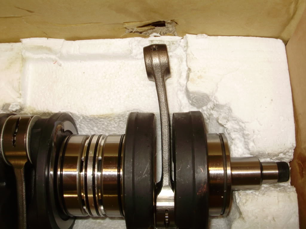

Wildcard Racing came through and I got my crank 4 days before the Busco trip- yeah!
I can't thank my man Brandon, and Shay enough.

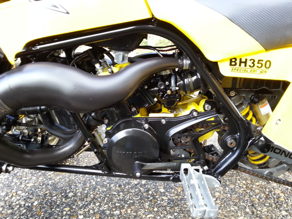

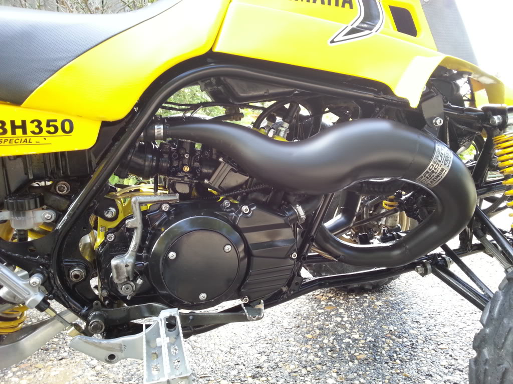

Heres some pics of the new motor in frame.
