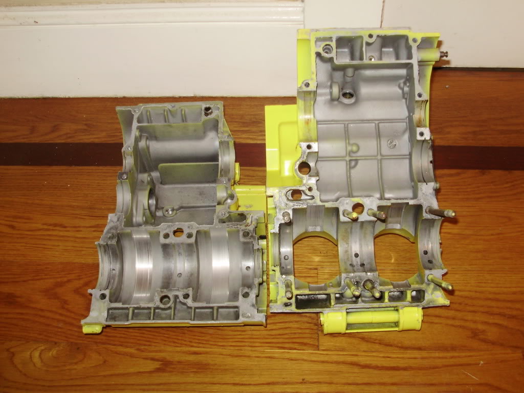

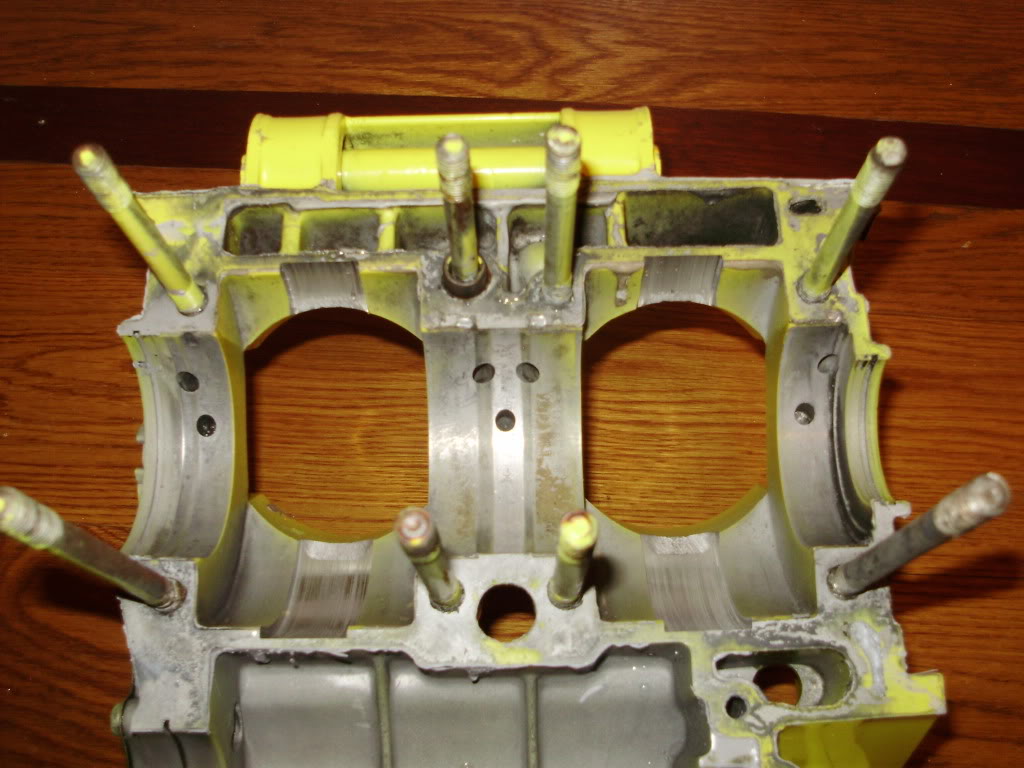

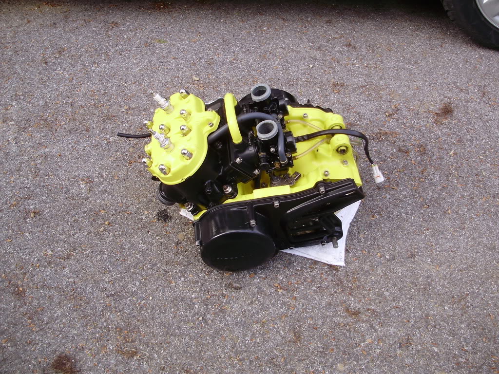

	I got the cases back finally! After a quick mock up I found one of the rods was rubbing. A tiny bit of grinding on the upper case half took care of it.

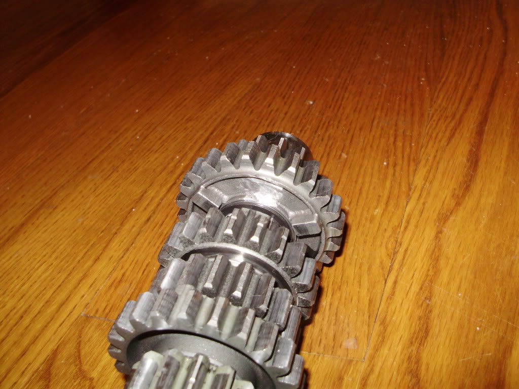

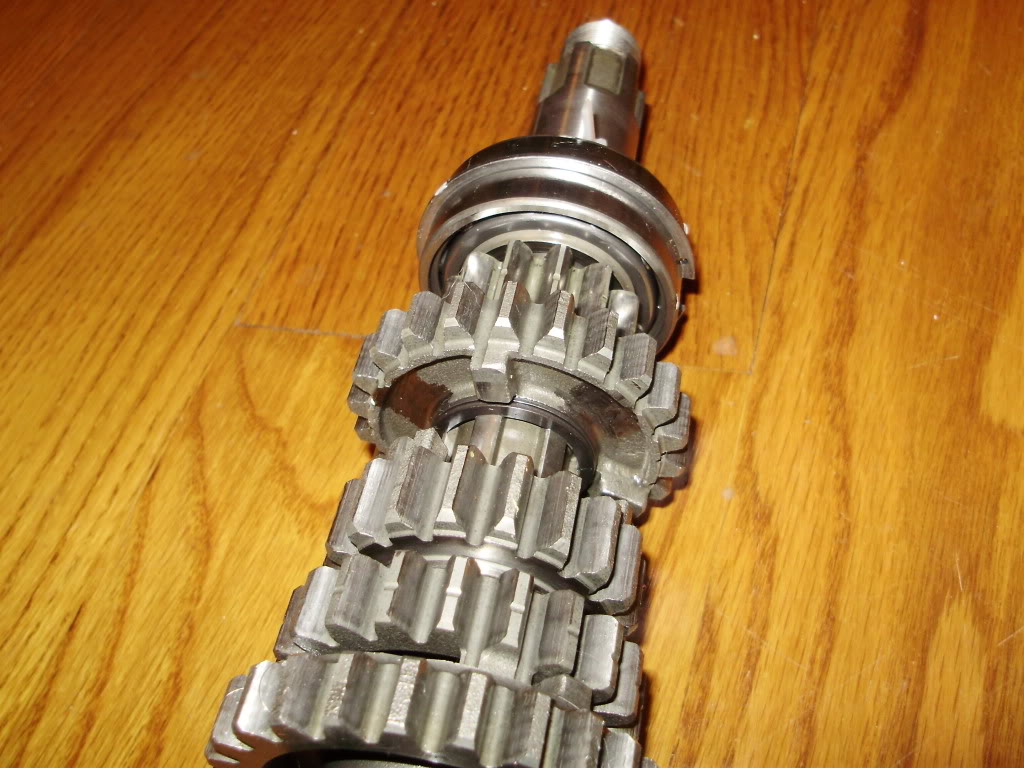

I've decided to have my trans cut. I should have it off soon.
Cutting is not an overide or even like it. I'm just having every other one of the engagement dogs ground off.
Shifting, clutch action, back loading is just like stock.
Pics of trenched cases
Looks killer bro!!!
Did you do the trench work?
Werent the vitos problematic?

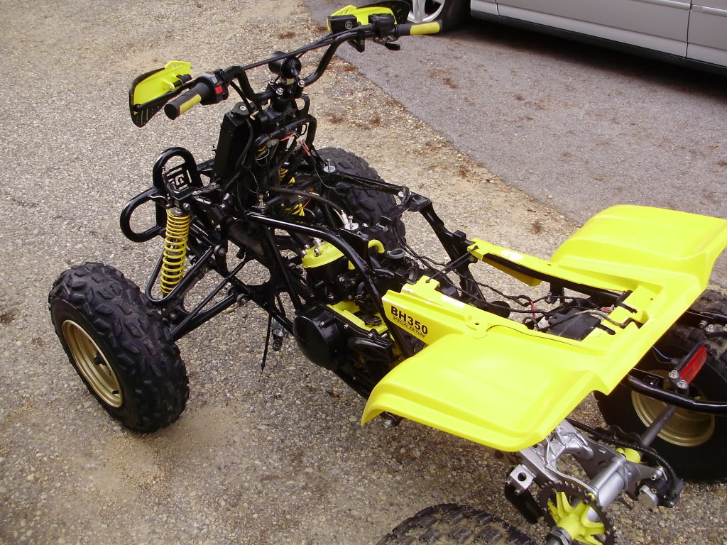

Looks bad ass is the paint work all spray bombs or automotive paint?
Well it's been a year since I got her built and the Flotek trail port has been awesome, but I really miss the snap your neck torque the 400 blasty used to give.

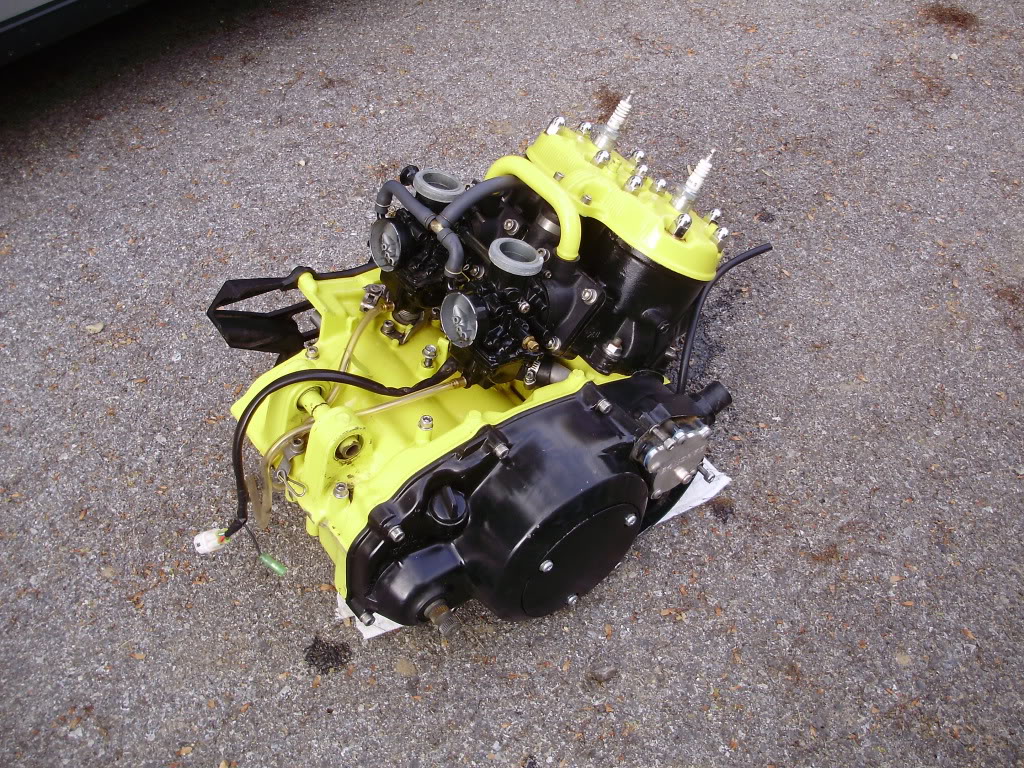

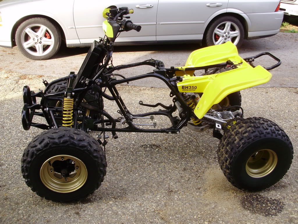

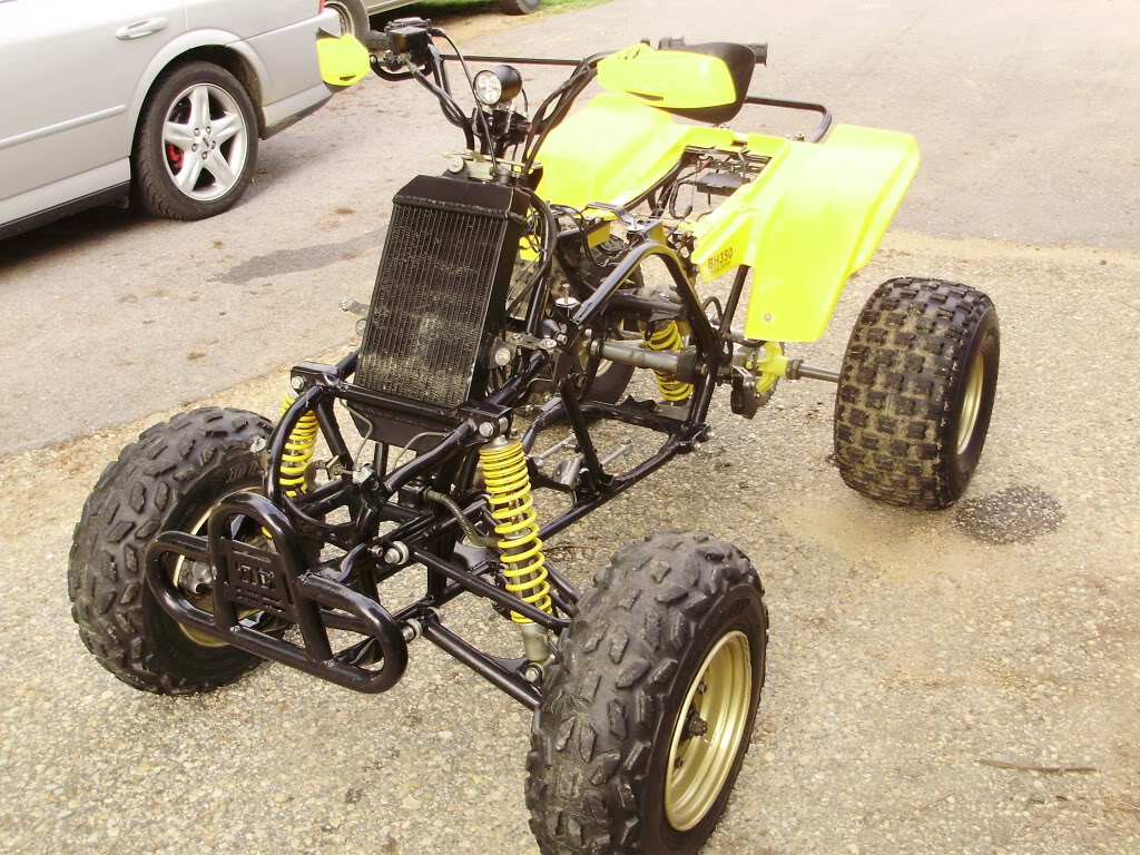

Everybody loves pics so here are some so far
Getting the motor out:

	Just to knock the dust off this thread. I have been told by more then a few guys the rods on my cheap crank are crap.....
It's currently @ Wildcard Racing getting the full monty treatment.
New 'HotRods' rods are being installed, welded, trued, balanced, and max load bearing put on.
I hoping it to be on it's way back to my open arms next week.
