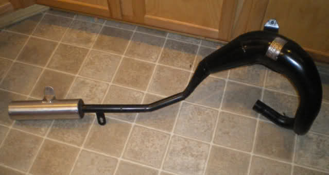

So I got my dynoport today (pics to come) and let me tell you this is a very well built heavy duty pipe. I did not like the look of the big sticker on the silencer so pulled it off and since there was no spark arrestor I ordered a trick red anodized end cap/arrestor for it. bottom line it is the heaviest pipe I have ever seen and since the end caps of the silencer are riveted (250r silencer) I have not quite figured how you would re-pack it though I'm sure their is a way ... but quality is bar-none top notch, the mounting is top-notch and so is the flange ... can't wait to get this thing rolling

So man the dynoport ... sick pipe, one problem though, it routes directly through the area where the YFZ450 shock reservoir sits ... now I have a couple questions. I will also probably put a post of this elsewhere for those who dont look in the rebuilds but I am either going to have to
1. replace my rear shock
2. sell the dynoport and get a different pipe that will route correctly
3. heat up and bend the midpipe slightly to fit around the shock reservoir
Time to sit and think on it maybe someone will chime in with ideas
Picture of the interference!
SI - Ill get a picture soon because I want to get opinions on just bending the pipe slightly
Slick - It's not as simple because it is not a stock YFZ450 shock. It was rebuilt by HLS to be dual springed to my weight and adjustable to sag correctly to stock blaster length. If it didn't have the custom work and money into it, it would be a simple decision to switch (now I'm curious if I can find an AM YFZ shock body with remote resoirvoir I might be able to use the eibach dual spring from my shock now and the custom bushing, but I have to call HLS and see what they say since it is their kit) ... switching the rear shock might be the route I'll have to take as I am wondering if I just got lucky with the fitment of previous DMC. It might be that a power pros made pipe routes the same making it impossible to run one of those right bends either ...

Some weird reflection but since people are asking here is a pic, I'll take another with it on the bike later
So my mind is made up ... new shock it is. I can switch the spring kit to almost any stock 450 shock, but am looking at a few AM used ones as well. I want to keep the pipe for sure ... not just because I just got it but because it is the sickest blaster pipe as far as build quality i've seen yet.
