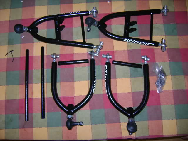

pictures of my new a arms

and they look real heavy duty and SHINY!!! definitly beter material the stock ones.

heres a pic. there not on yet tho. they have greasable rubber boots on the heim joints and it came with a letter say there a new upgrade. i guess they heard that the joints kept wearing out easily and was giving there company a bad rep.

no i didnt, it doesnt say there included but it does say hardware, which i assume means bolts and stuff is included. which i also didnt receive. i emailed them, hopefully they email me back or i will threaten to leave negative feedback lol.
just got message back from them and the hardware is the shiny metal joints at the end of the a arms. and tie rod ends not included.
i got one side on cuz i ended up taking everthing off and hammering out the ball joints since i dont need em anymore anyway. i have another question for you guys tho. when im putting the spindle on how do i stop the joint from spinning when im putting the nut on?
and they didnt even send the castle nuts for a cotter pin, just a regular nut lol. i got lots anyway tho.
