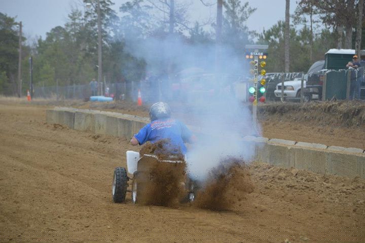

Pics of winter build!!
I have my 38mm stuffed into a 35mm intake now. Member DUALSTROKE knows where to get a 4 bolt 38mm intake. I think he said Snyder racing.
Wish i had known that back then lol I'm stuck with a brand new 36 and new upp manifold with this setup. Hopefully there will be a flotek ported ct cylinder w/ a 39 pwk in the future:)
First test&tune next week:) Have currently added a nology profire ignition, pod, ported reed cage and manifold, and removed front hydro brakes.
Greenes in disputanta va. Will be my first time there. Yeah i can't wait for the work week to be over with lol. Hope the weather changes. Dealing with sleet and snow
Dual purpose drag blaster =:D Beating on 400's and some 450 4 pokes in the trails =:eek:..
Ever consider a Lectron or running Alky?
Considered it but didn't seem practical. Currently running 110 with about 200psi compression with timing advanced +4. Hoping she gives a good number next weekend:)
