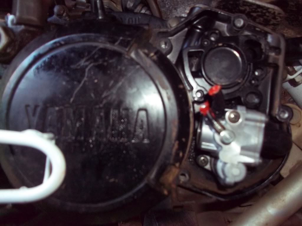

Hey i just want to make sure i did this right all i need to do is take it all apart and only remove the Black Gear in the pump and then the thing that the gear was on goes back in right and here are a few pics
That's it I:I 15151515
Ok cool i put it all back together put it back on all fours then went back and checked around the black cover that covers the pump and i don't see or feel any leaks so my next step is go get some gas tomorrow then mix how many ounces of oil is t every gallon of gas it 4 per gallon right? And i will be using yamalube 2s
