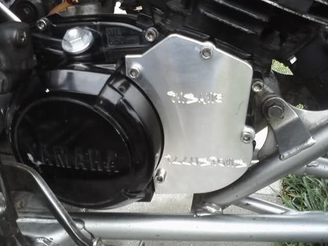

I don't get it. Why make anything? I love to fab stuff but in this case, why not just use the existing pump housing and be done with it?
Weight reduction!!!
Actually i considered that method but thought it was a little ghetto when i could make a plate and fill it in with epoxy on the other side and it look professional.
Im just not digging plugged lines and all that jazz no offense but it just IMHO looks half assed.But to each their own.
Weight reduction!!!
Im just not digging plugged lines and all that jazz no offense but it just IMHO looks half assed. But to each their own.
No offense taken. I'd consider it ghetto too if it were visible or sloppy. but it's just clean and quick with no external signs of it if done properly. Completely professional, you're using the existing body and vacuum tube block-offs (or plugged lines) to clean up the enclosed pump. Like you said, to each their own.

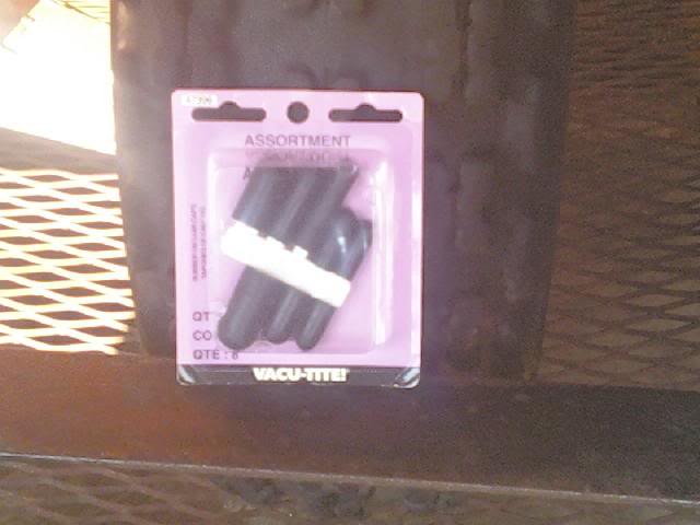

Got some Vacuum Tube Block-offs yesterday at Auto Zone...
I'll post the pics of them installed on the pump and the white gear removal from inside of the Clutch cover. It's gonna be a few days though, since I gotta put the engine back in the frame to get the kick-starter nut off. to remove the clutch cover. It's WAY too tight for me to remove with the motor on the bench. X(
what size vacuum caps am looking for ?? all so the one to plug off the carb to
cheers ray
I removed all the piping and siliconed a patch to the inside of the case where they came through, works for me and no pipes to flap in the breeze.
From memory you need a 3/16 cap for the carby.
Looks like your questions have been answered. The block-off on the carb nipple is a miust or you'll get air leaking into your carb and it will be impossible to jet correctly.
The pump body can be left on to save you the $ buying a block-off plate. If you read through this thread, you can see the pros and cons of taking the plastic gear off the inside or the ring gear out of the pump. My suggestion is don't take the clutch side off just for this. Take the ring gear out of the pump and block the tubes going in and out of the cover just to be neat and keep dirt out of there.
If you get the vacuum tube block-off assortment (pennies) at an auto parts store, you'll have all the block-off sizes you'll need.
Best of luck to you on your new Blaster!
