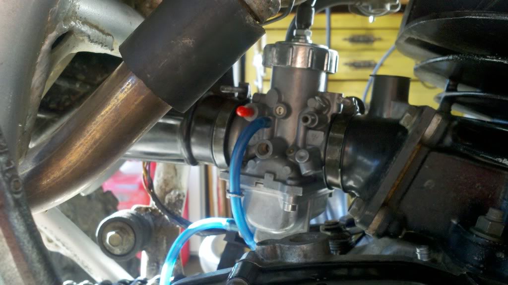

pull the oil pump tube off the carb nipple and put a vacuum tube block-off on the nipple to prevent an air leak in your carb.
easy enough i will tqake care of it soon oil system was cut off when i bought it but they diden cap or plug some of it i need a pic or somthing of the carb so i know whitch nipple to cap please the guy before me ran strait gas through it and I guess he dident think about it till the top end was burnt

need a pic or something of the carb so i know whitch nipple to cap
thanks
Here ya go; It's the red nipple....
