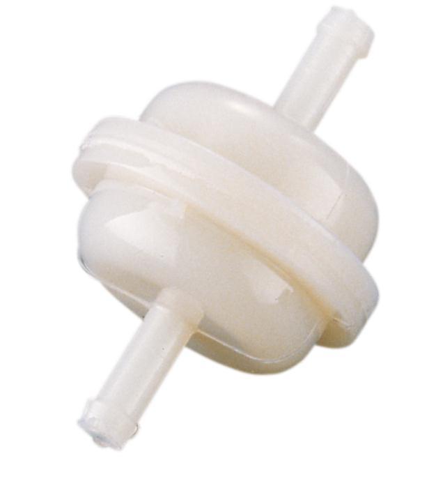

I never knew that snow machines,or snowmobiles ran a "oil injection filter". This might make a nice addition to the blaster's oil feed line. It looks like it has a large surface area,and would hold lots of debris if you got a bunch in the tank. From what I read,watercraft also run a filter on the oil injection,but how much dirt are they encountering on the water? :-/
Yamaha Oil Injection Filter | eBay
Seeing that the oil tank on the blaster has a pre filter (little piece of foam) under the cap,and the outlet at the bottom of the tank sits a little bit above a small resevoir molded into the bottom,this filter would make it ,for lack of a better term "triple redundant".
I think I'll pick up one of these filters and give it a try. Another modification that might make sense,but probably isn't needed,would be to drill another vent hole in the cap same size as the other one.

Another thing that makes you go "Hmmmm?" is this...
This is a "Factory Yamaha oil injection filter". These are used on water craft and snow machines. Why in the hell does a water craft,or snow machine need a filter in they're oil line? They're no where near dirt.
http://www.ebay.com/itm/WSM-Oil-Inj...Parts_Accessories&hash=item2a23ac5c31&vxp=mtr
I *believe* the point in them asking was that you don't always have the most sanitary and clean conditions on the side of the trail somewhere (where you can have a problem) . I don't think anyone is silly enough to take a big glob of mud and throw it down in the tank and expect that not to have some sort of side effect. However some dirt and dust around the cap isn't unreasonable to be expected at some point to be looked over and it could possibly get into the tank either during a refill or maybe even a top open check of the oil level?
I don't think there are any other sources of contamination other than the open cap and the vent line. I don't see the vent being a major source of solid dirt (maybe some dust? but I doubt that will affect anything) but an open cap can have some crud fall in.
Now that you mention it, it doesn't make a lot of sense for them to install a sediment type filter (versus a water trap) in a aqua or snow setting anymore than it makes any sense for them to omit it on the blaster. I guess they "just didn't" on the blaster and "just did" on the snowmobiles and jetskis...
now my memories of oil injection use are coming back to me............ the foam thingy inside the tank apparently is there to catch any particles that may fall in ??
i remember using clean needle nose pliers to pull that foam out every time i added oil, < and cleaning it off if needed, that also allowed me to pour the oil in faster.
are people removing that foam "catch" and leaving it out ??
