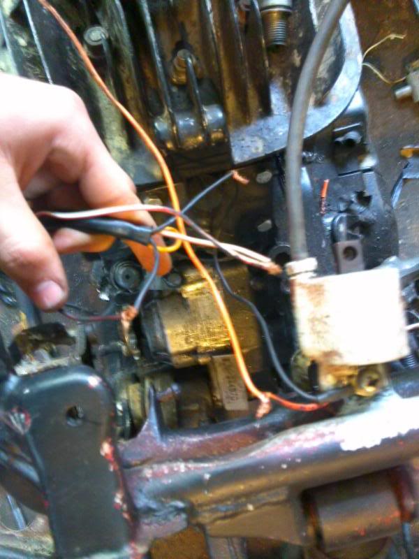

yeah thats what i did, but i elimated athe wires going to the carb. and somthing happened

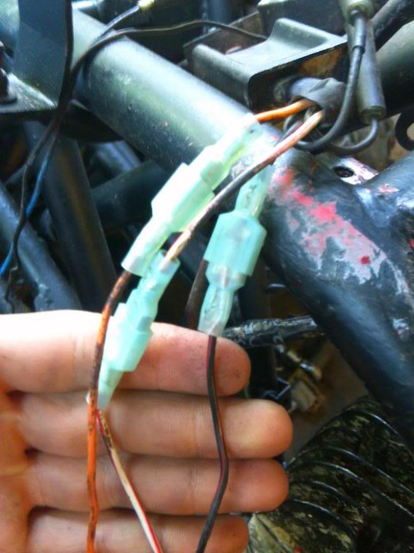

heres what i got left of the harness. the wires coming out of the stator hooks into the wires coming back from the cdi unit. thats all. am i missin something to make it run?
three wires going back to stator and coil
connected to stator and coil and ground hooked up
Yes for your year just unplug. They just say to cut to clean it up a bit, but i just wire tied mine to the harness out of the way!
Thanks Slick! You helped out a lot! i think that is the problem that is preventing me from starting my engine on....I left the reserve gas on all night on accident and i think this activated the TORS...but I dont know if that is the main problem.
i dont know what colors the wires are... there are only 2 wires heading from the cdi to throttle so obviously those are the ones you need lol then the same thing for the wires that go into the top of the tors unit. you are overcomplicating this, its very easy. I:I
