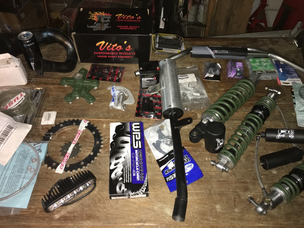

New parts rolling in! This week I received:
Alba Brake Line Clamps
New front and rear Speedlines from American Star Racing
KOR 400EX bushings
KOR Case Protector

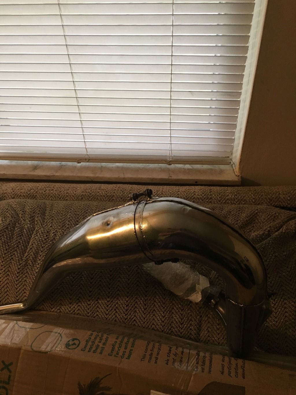

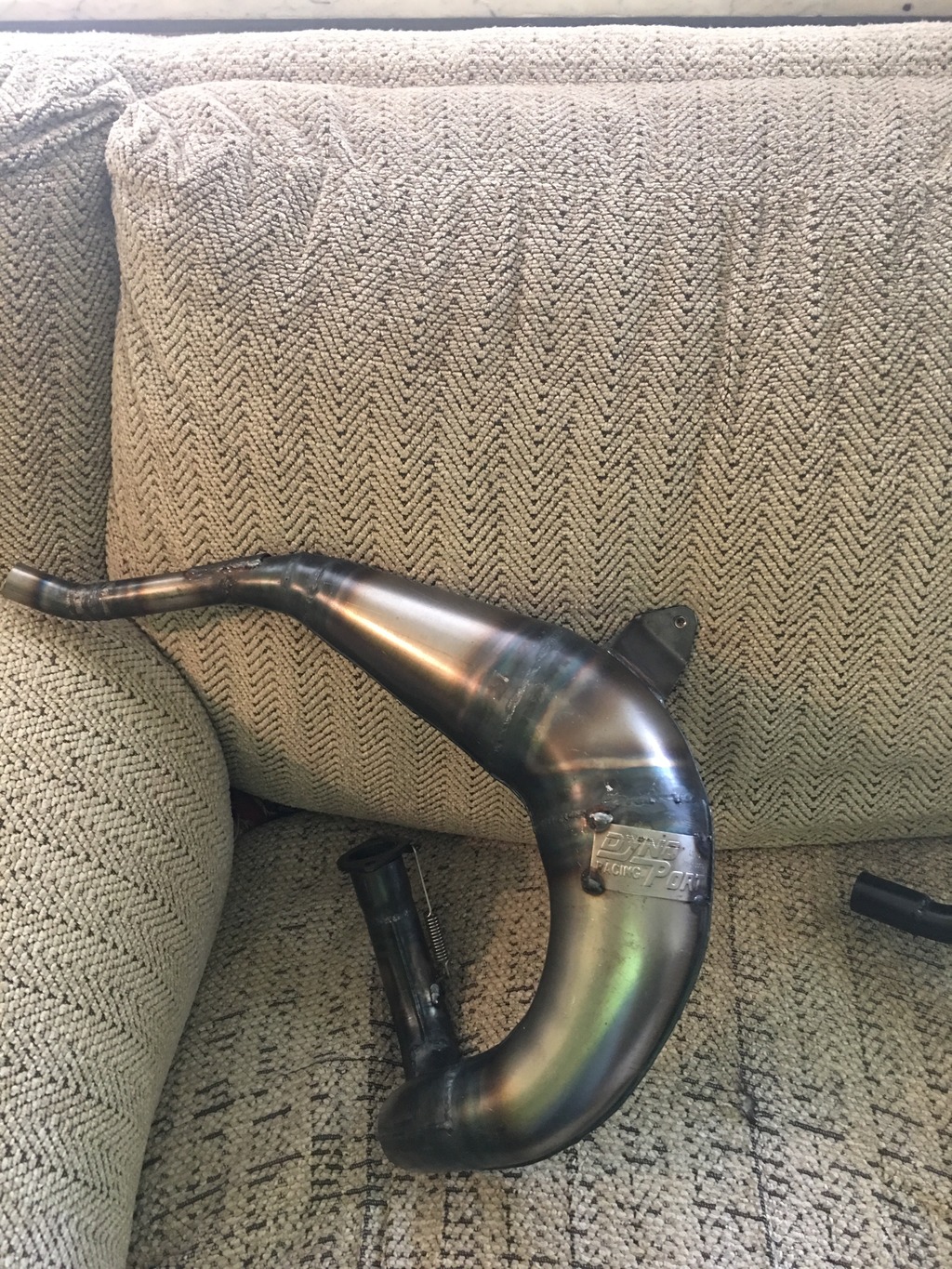

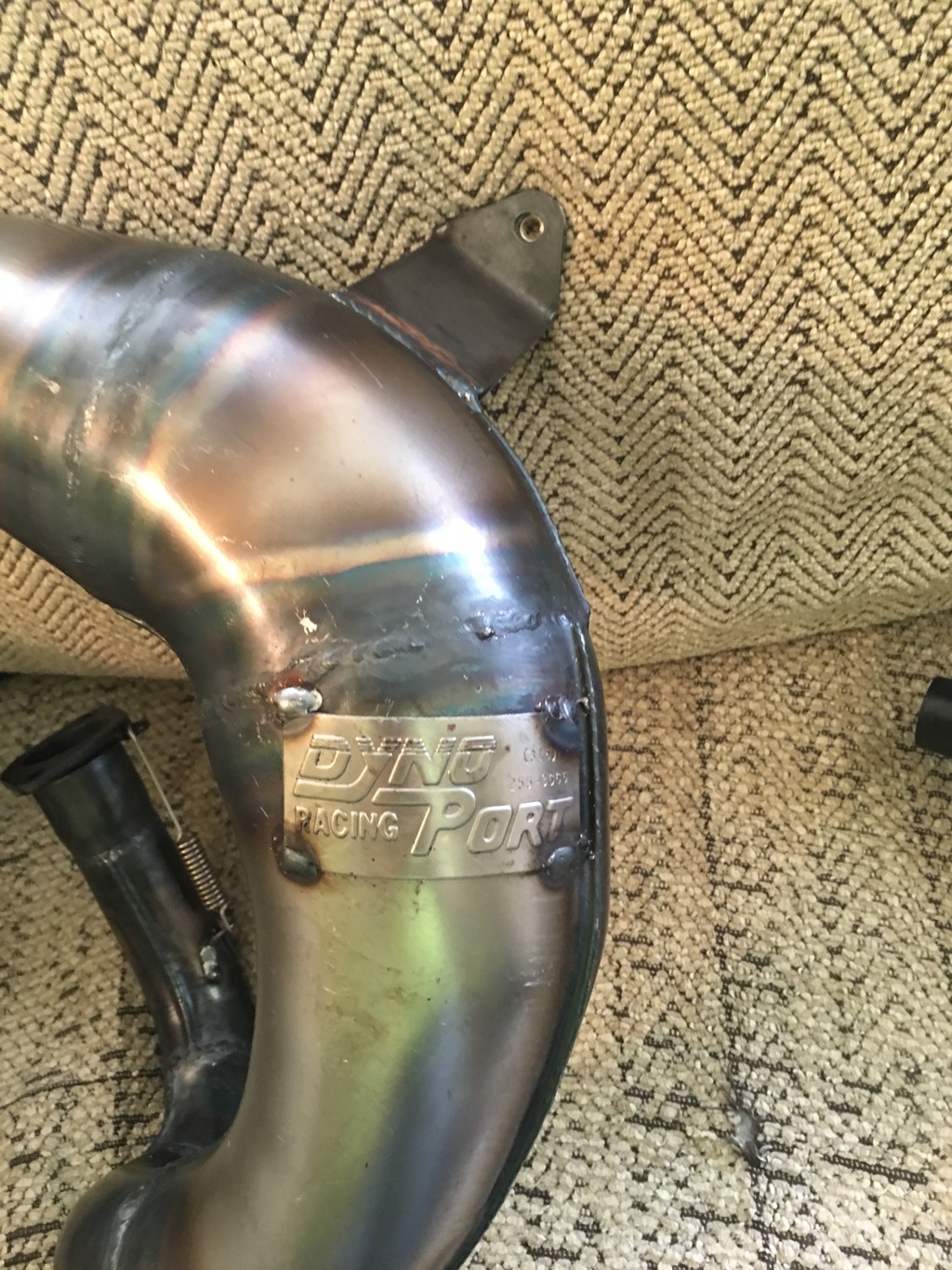

LRD Adjustable Pipe and Silencer
Reactions: 82cutty

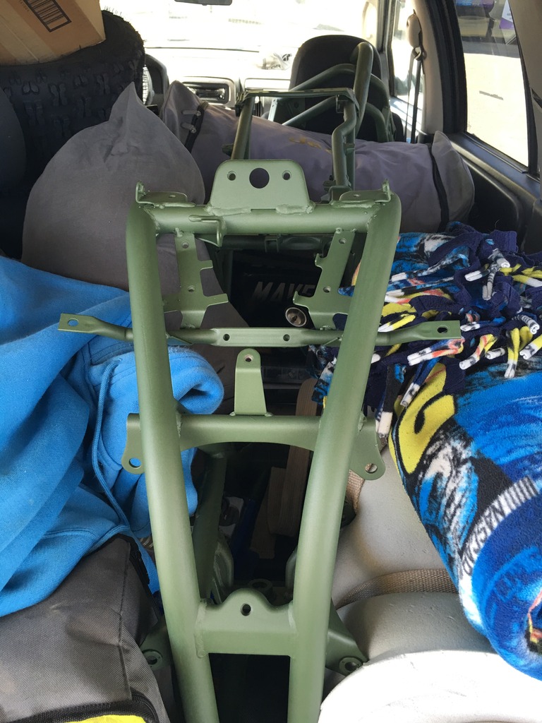

Shocks arrived at Jocaga today, getting my works repaired and revalved for my big butt. Dropped the frame off to get powdercoated, thinks it will be about 2 week turn around which kinda sucks, but he's over $100 cheaper than everyone else around me.
Top end is off at Ken, working his magic. Just a handful of things left that I need... Tires, maybe a front a rear bumper. That's about it really.

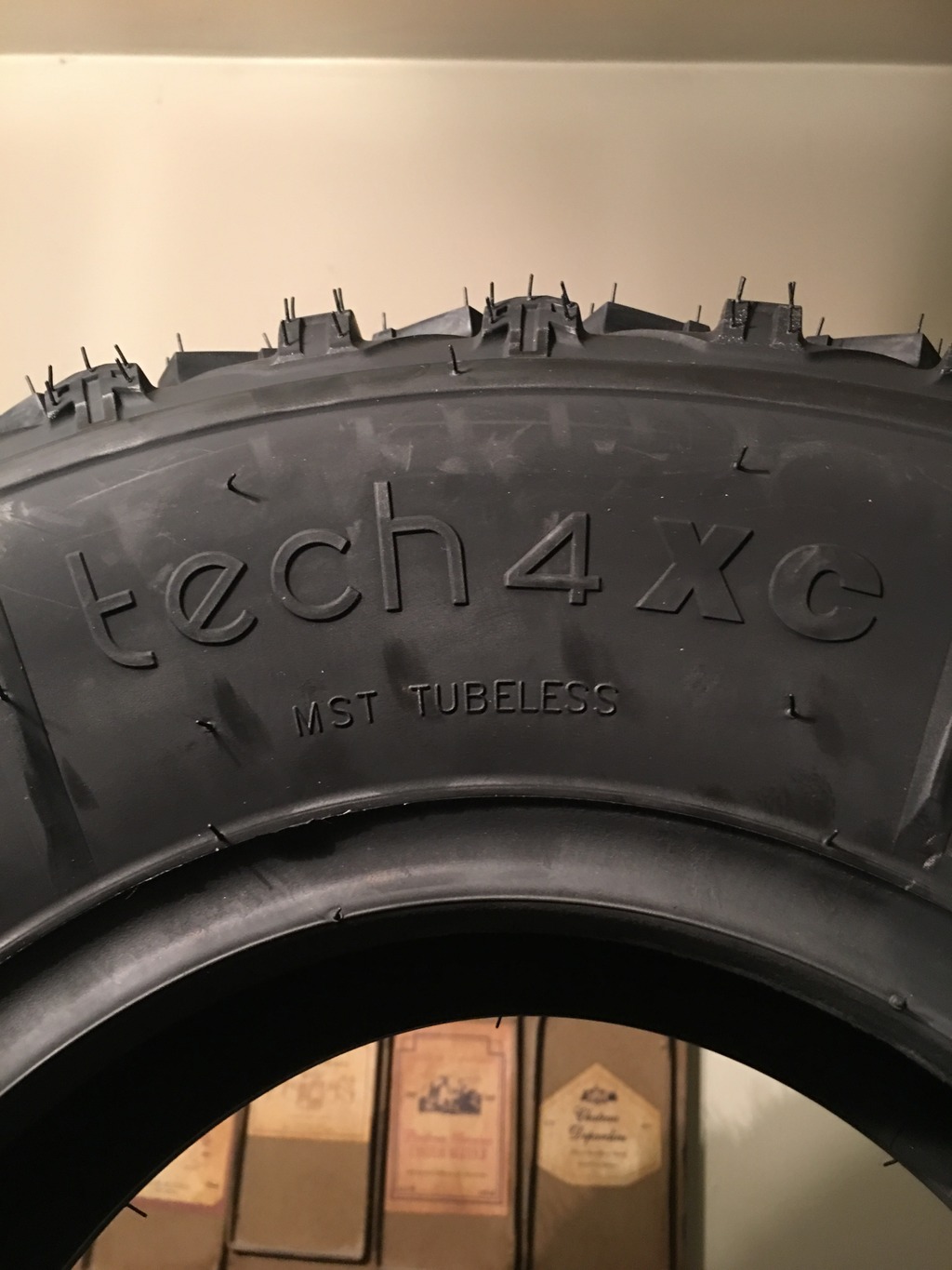

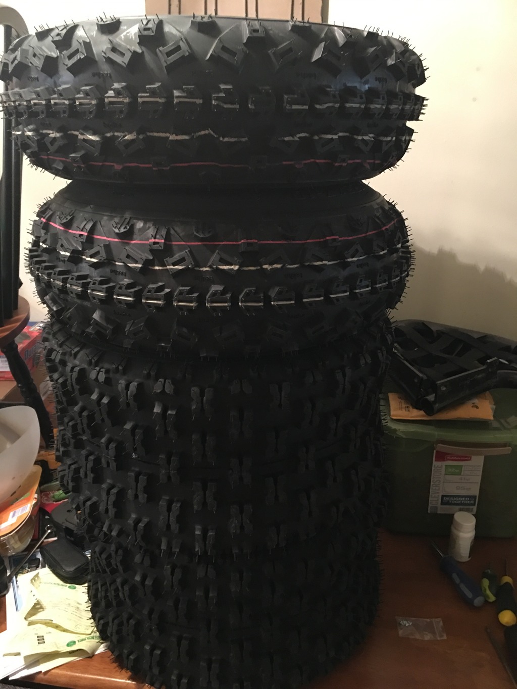

Well got a couple more things in these past couple days:

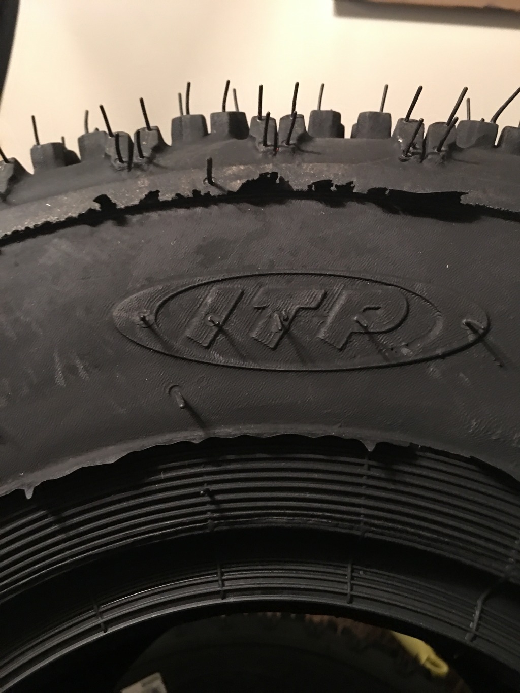

Front 22" tires Tech 4's
Rear 20" tires ITP Holeshots
Member here hooked me up with a great deal on a set of tusk Nerfs as well!

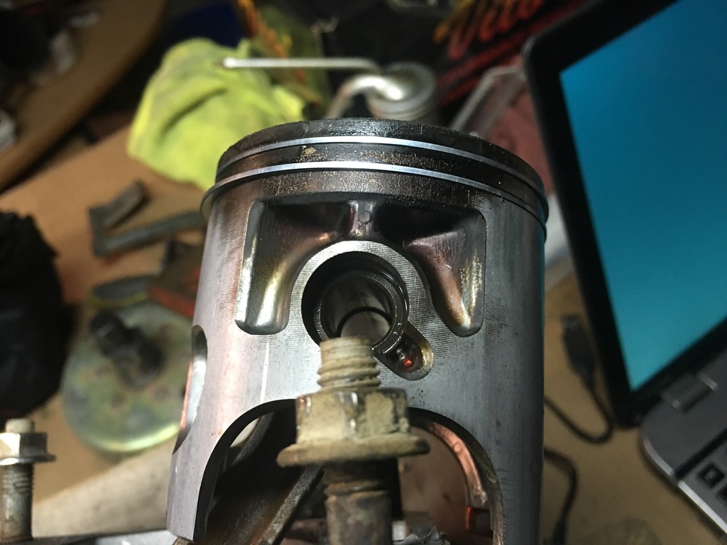

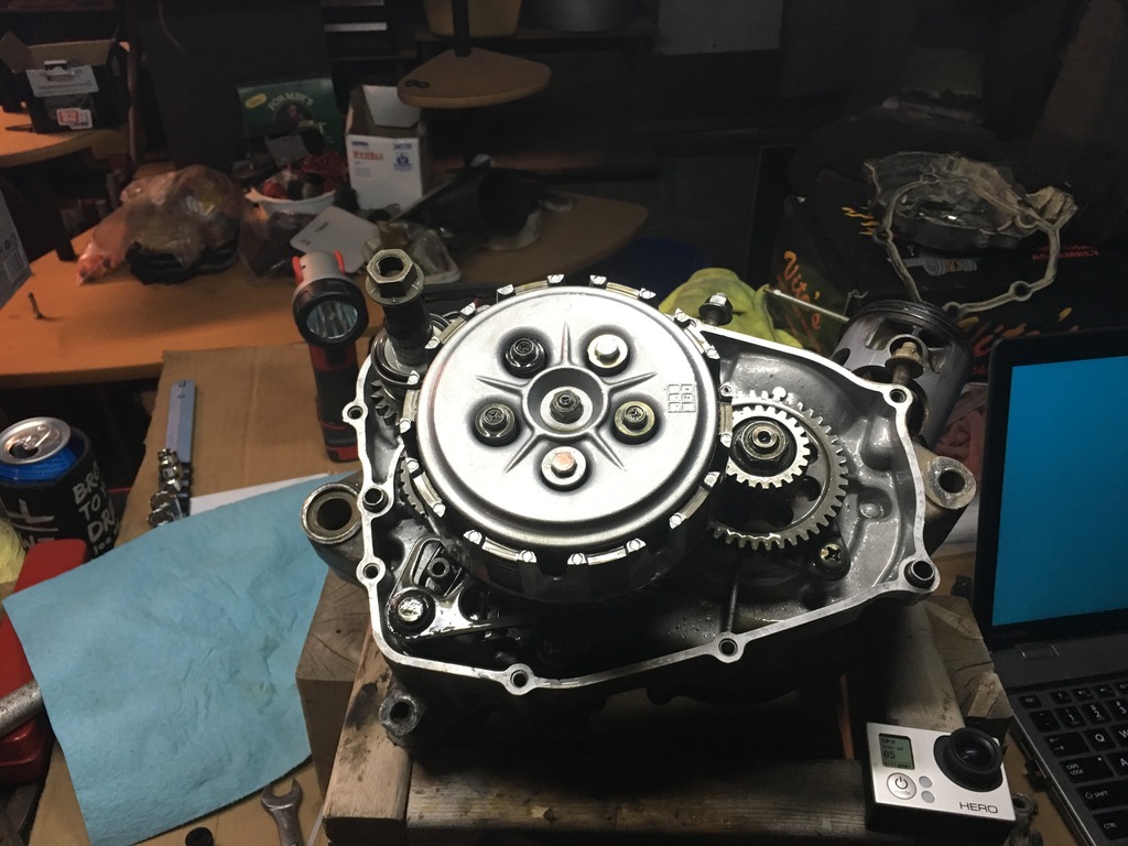

Tore the motor down this past weekend to get the old crank out and install the new +3 stroker. Must not have changed the trans oil in a while and that thing smelled burnt! So picked up a tusk clutch kit, 150 pc bolt kit and stainless engine bolt kit. For some reason I had like half a SS engine bolt kit installed... was really weird taking the thing apart!
Reactions: Meyers
got those same front tires just last weekend. Still got the hair on the top even after about 3-4 hours of wood riding. Definitely like that they are cheap but still hold up well and 6 ply

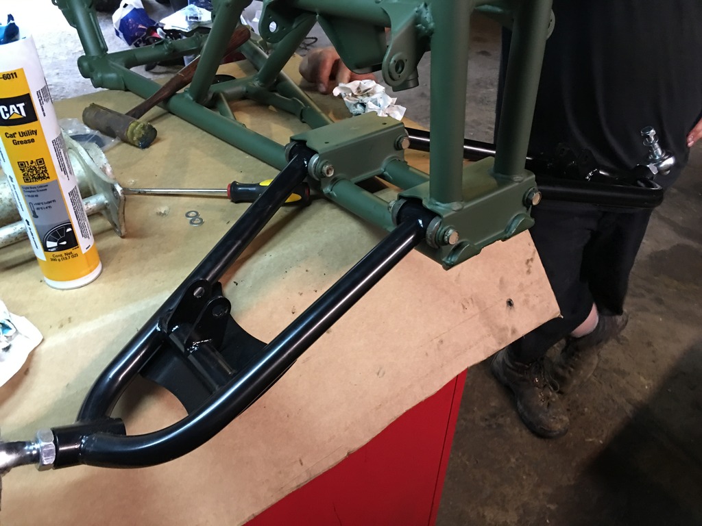

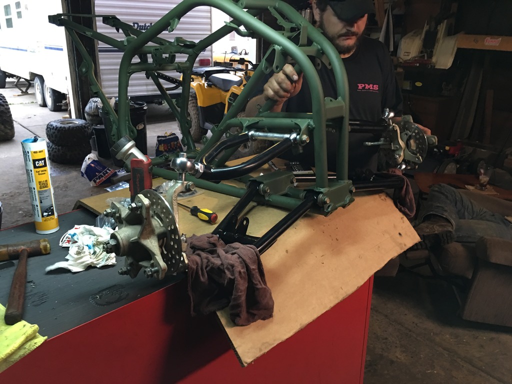

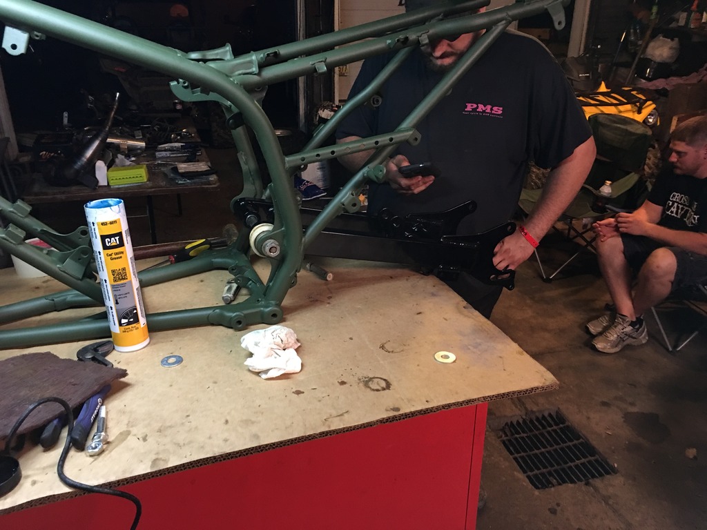

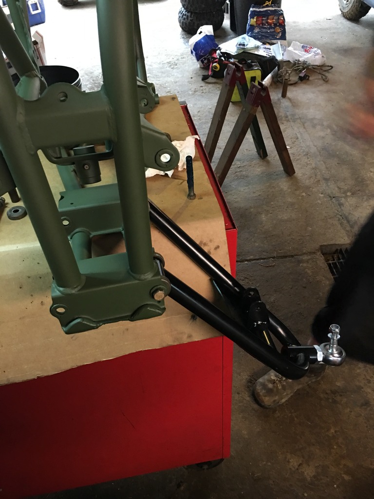

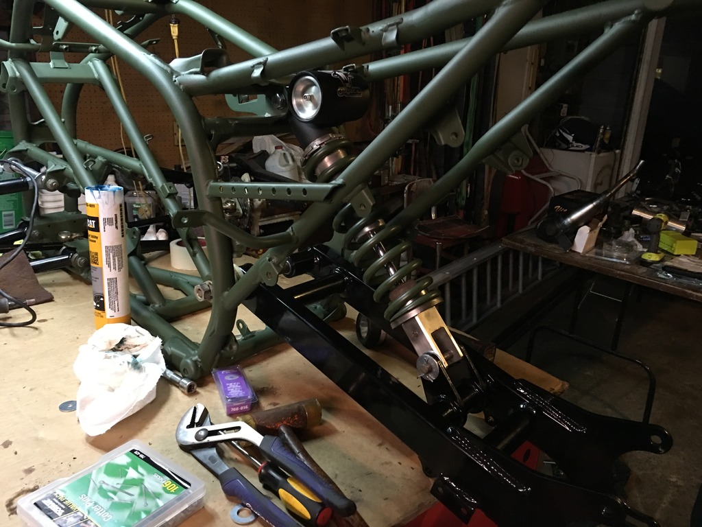

Well went back to my brothers to start the build tonight, this is progress so far. Prolly working into the night to get it a roller.
Packed up for power line lol
Starting the build
