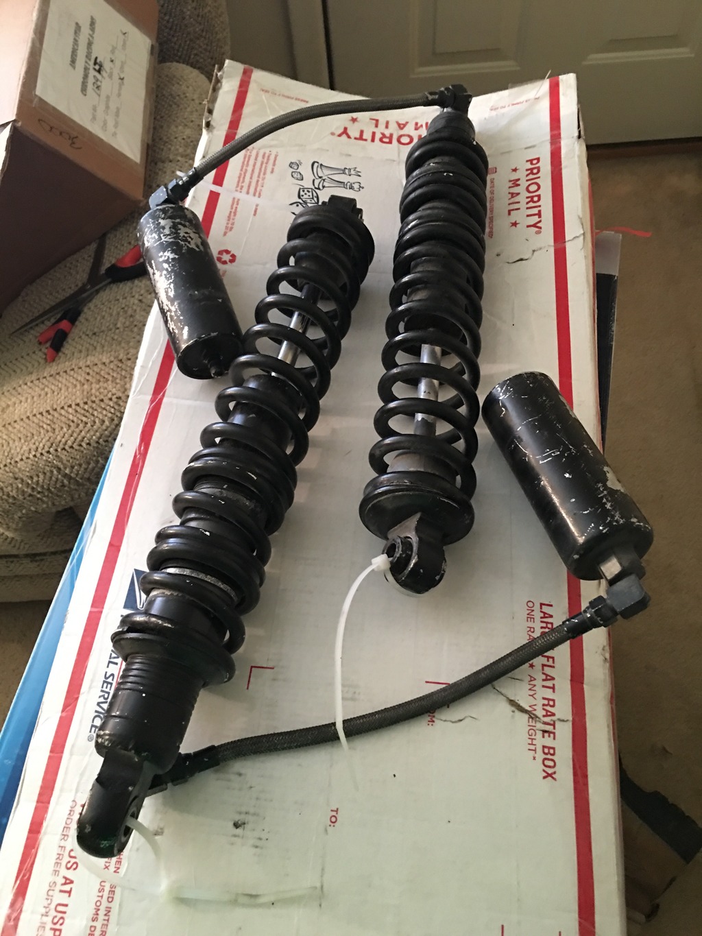

I also ended up buying those 450r 16.5" works triple rates I previously linked. $315 free shipping. Will need re-valved since I'm a bigger guy on the 260+ side. Also got a new low bore cylinder in hands. Hope to send it and my head off to Ken tomorrow!
Nice what's getting done to head re chamber and u getting the cylinder p&p. Also I recommend u send ur shocks to Jogaca very reliable and great guy to deal with also does incridible work.

-TRX 450r works triple rates

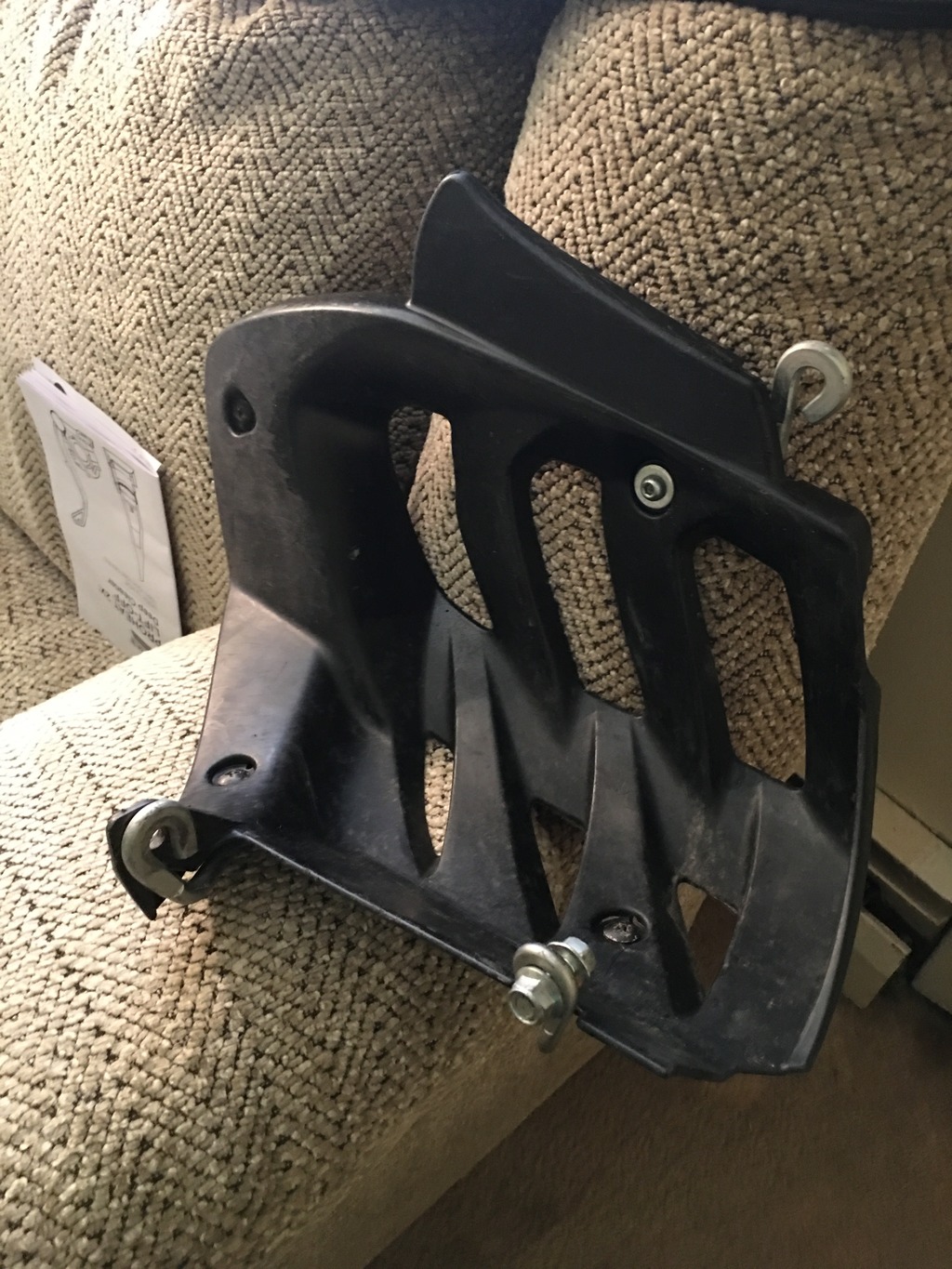

-250r heel guards

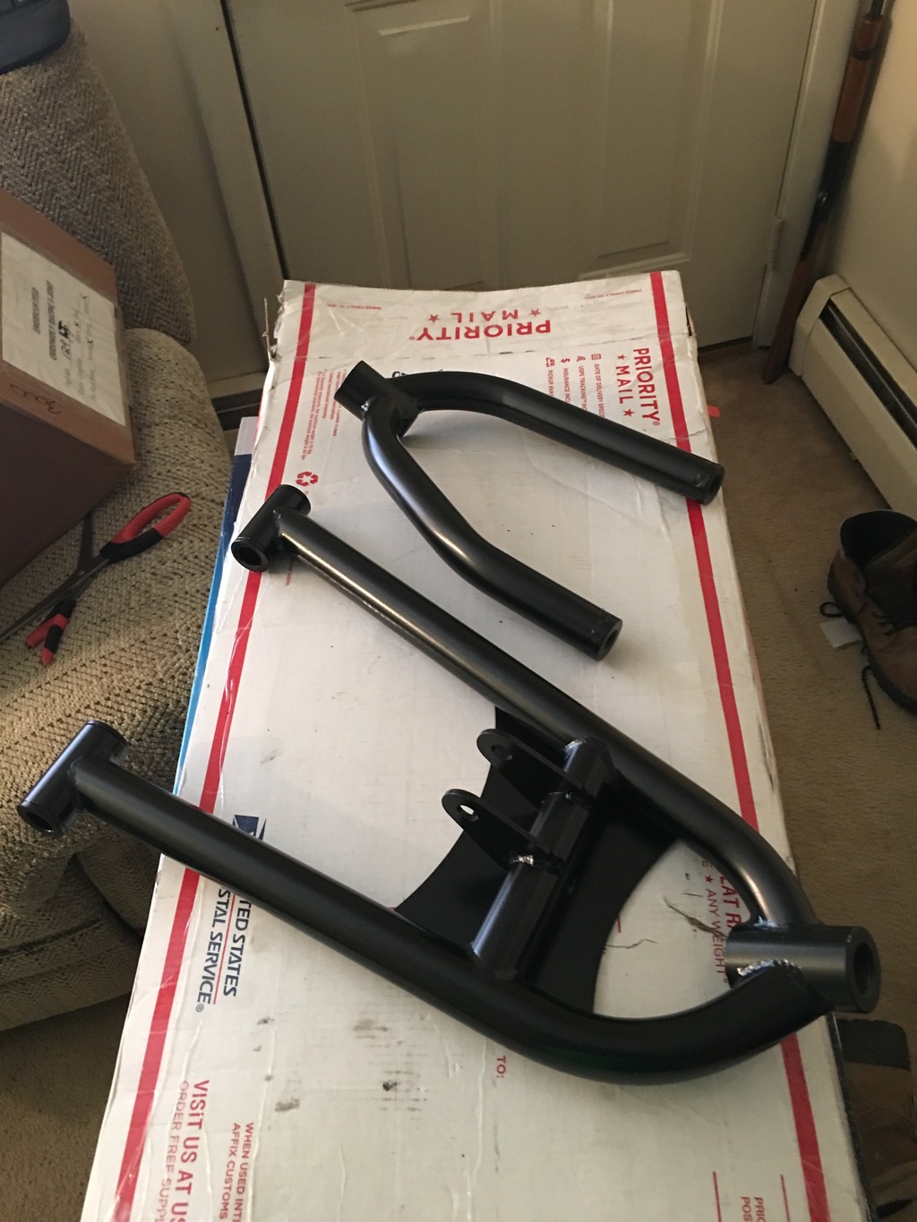

-ASR +3 +1 Long travel A-Arms Black

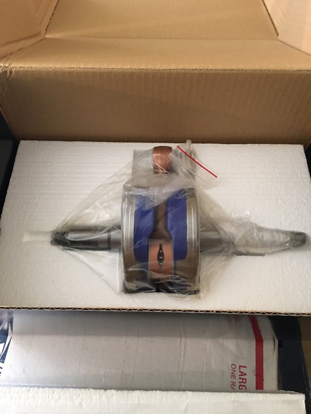

Forgot to mention I also got basically an entire bottom end rebuild kit from Ken. Includes all washers, c-clips, gaskets and.... +3 Stroker lol.

- Now that I am using the ASR arms, can I switch over to banshee spindles? What would be the advantage if I do.
- I read that YFZ dual piston calipers are the same bolt pattern as the banshee/warrior calipers that I currently have. Would it be a good idea to switch over to them?
- Are the heim joints from ASR still giving people trouble? The listing when I bought mine said it comes with ball joints but I recieved the hiems. Should I can and get the ball joints instead?
Last but certainly not least....STILL LOOKING FOR A RIGHT BEND!
From what I hear, people say the ball joints are better but the blaster spindles can't do ball joints. You have to put banshee spindles on for the ball joints (the advantage of running banshee spindles) but I hear they are a direct bolt on.
