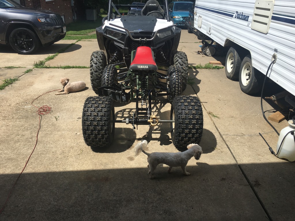

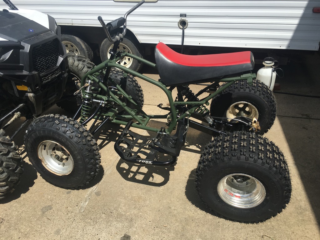

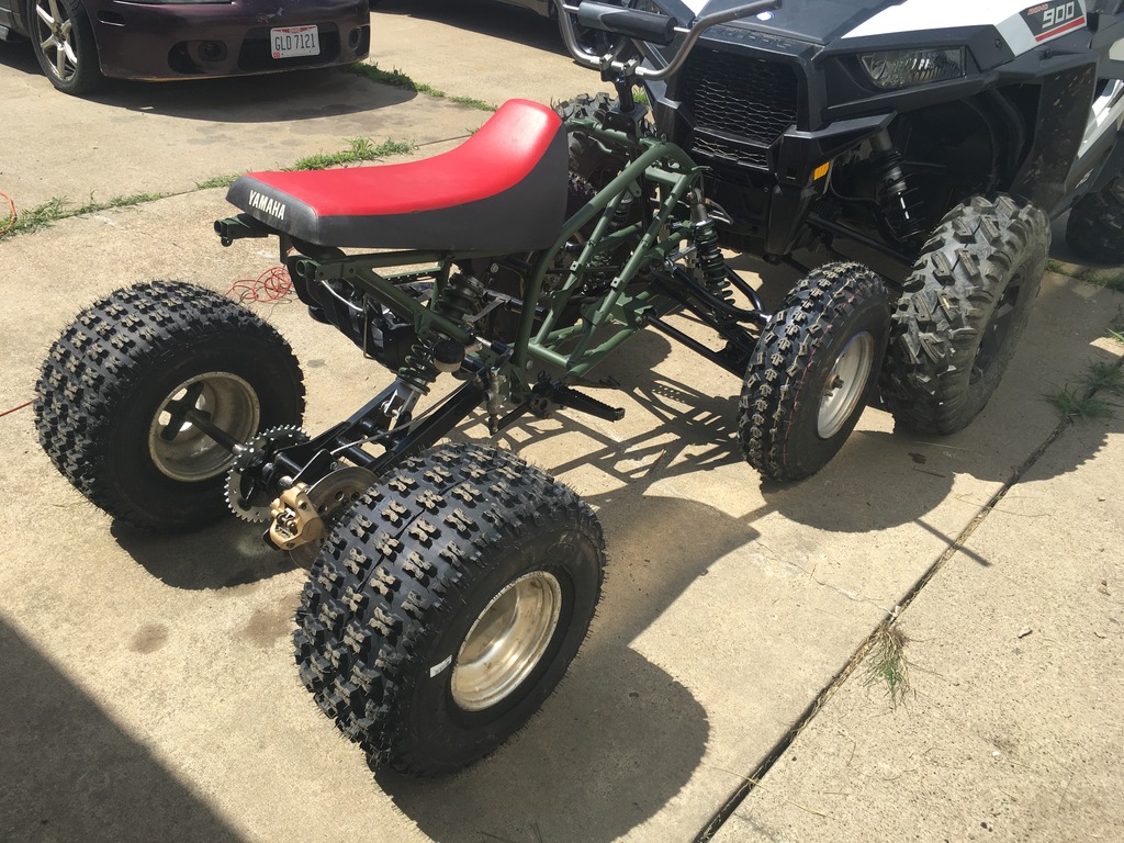

First full Rebuild
Yeah. I want to see more of this army themed quad. :) Green reminds me of army vehicles.

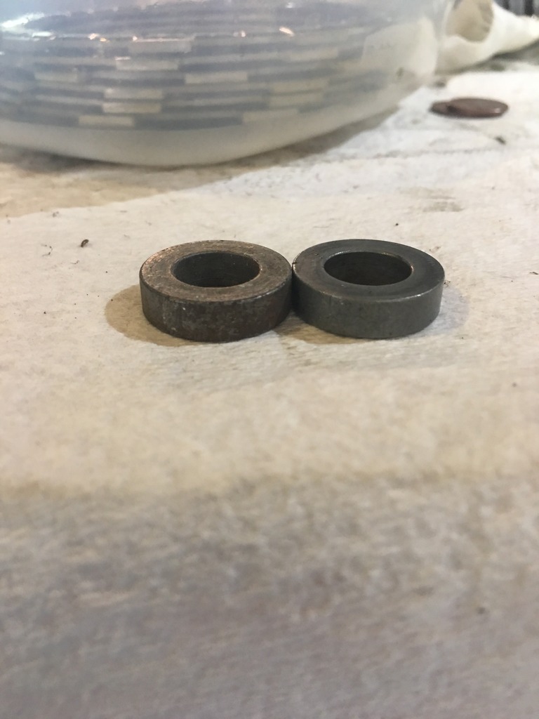

QUESTION TIME! I have NOOOOO idea what this is for, I have 2 but ones from a spare tranny. Watched all of kens vids, went through the manual a dozen times, no idea. any help is appreciated!
That's exactly what it is... Dope!! Never got that far so didn't even think about it lol

FYI, while the quad is supported by the axle and under the front a-arms, DO NOT, I REPEAT, DO NOT, take out the swing arm bolt LMAO....It will fold in half faster than you can react. Scared the crap out of me....
