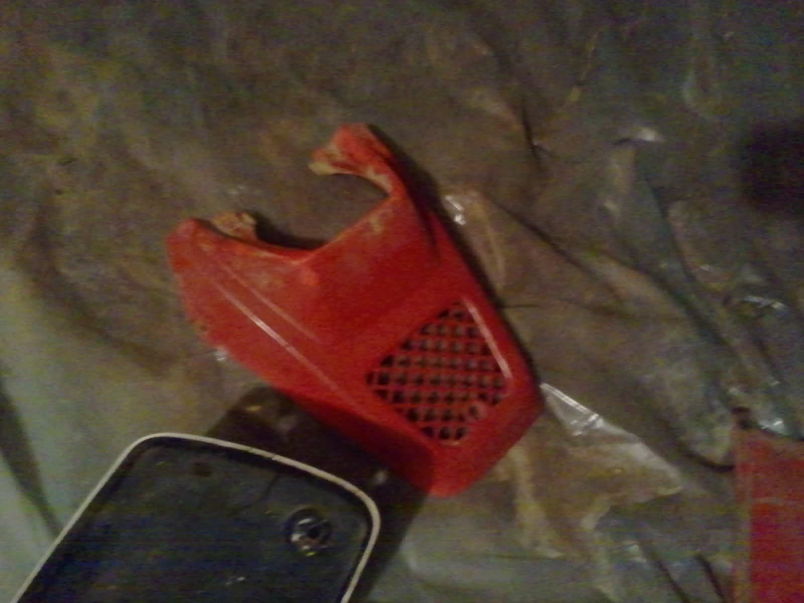

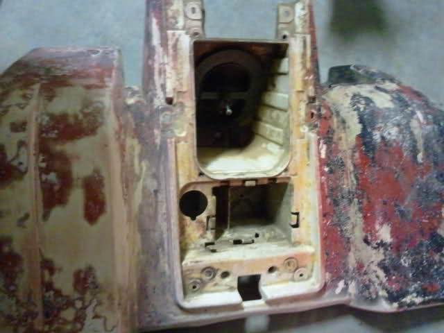

Holy crap, who got to that thing? Also, paint stripper will remove the paint but not harm the plasstic. Probably too late for that piece of information to be useful now, but for anything else you want to strip...
to back sicivicdude up. I have burnt up cast and forged pistons. the forged piston just scores and seizes but the cast piston disentegrates and all the little pieces end up melted all inside your cylinder and crank.

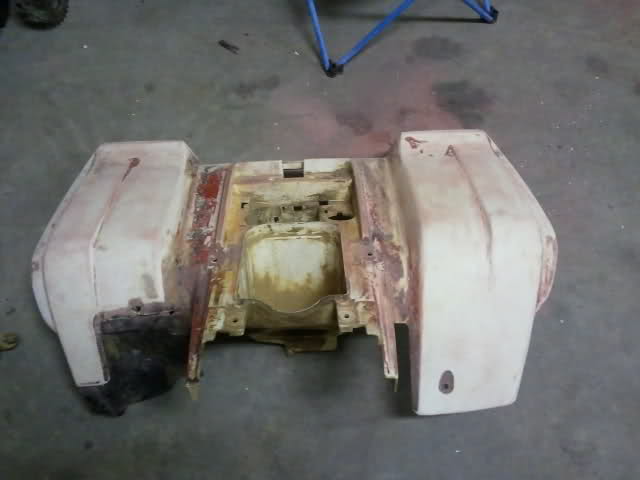

yeah i know i used it on the first layer but this stuff was like concrete and i also needed to get off a layer of plasatic that had become dry rotted.
You don't have a choice but to use sandpaper on the plastic to remove the top layer but all of the pain will come off with paint stripper like strip-ez or similar.
