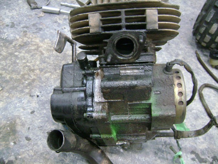

I prefer a round plumbing plug hoseclamped on the carb mount.
Here is your Blaster exhaust port, a sheet of inner tube or foam rubber under the exhaust flange will do.
Note the big air leak on the base gasket of this one!
