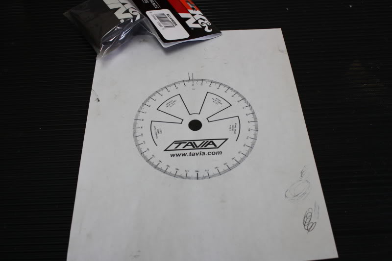

how doyou figureout the 3 mm?
I was also worried about the 3mm.
So I just went to google images and you can down load a free degree wheel and then use your printer software to make it print the exact size you want.
I got it at Tavia Performance Specialty Automotive Tools and Hardware
Here's a pic of the one I used..................
