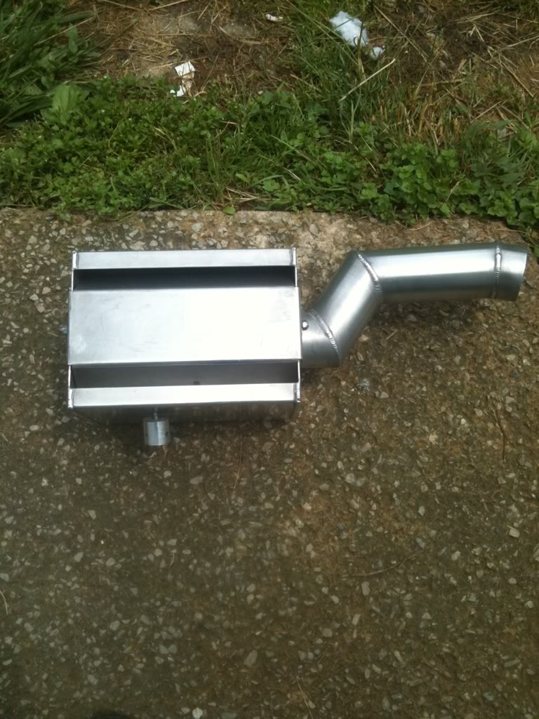

nice dak. PM me some detailed pics of it once you mount it. mine hangs below the top frame rails about an inch and i wanna see how well yours fits.
