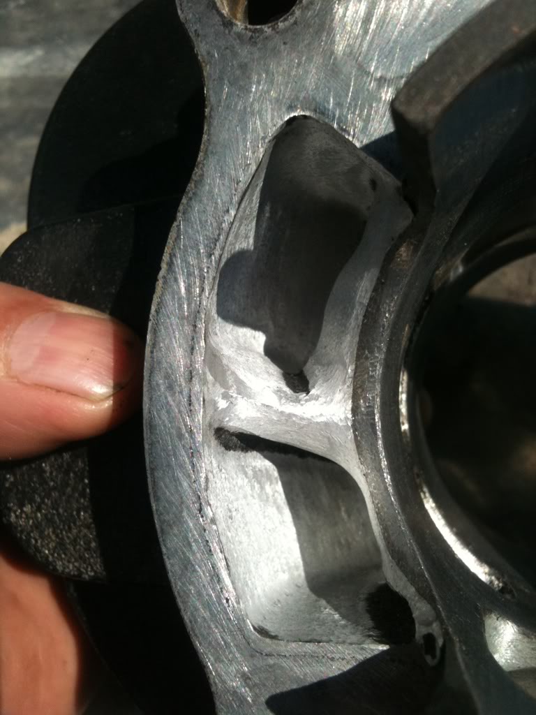

Before pics of my jug.

Did HJR do the head mod or O'Connor? (Ken's head mod/squish band is right on target, for these motors, for pump gas)

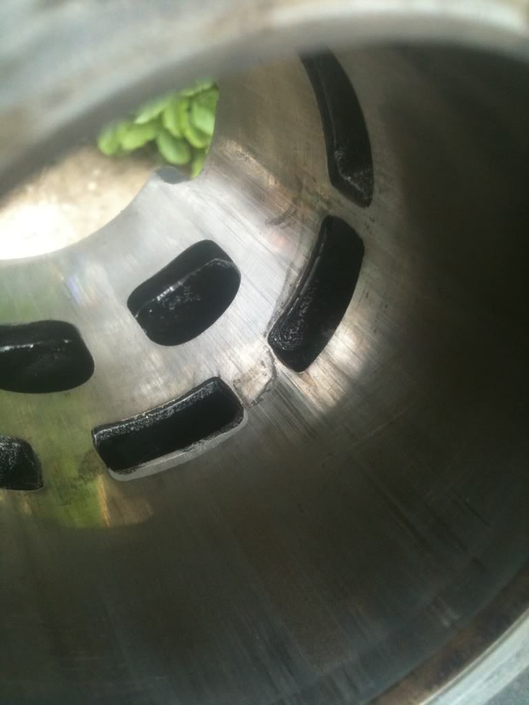

As for HJR porting, looks decent, the exhaust ports look good, very "FloTek" like.
As for the intake, I expected a little more outta them here, curious to what kind of power this is gonna make on the said PumpGas/charge...

Also curious to Ken's $.02 when he see's these pics, O'Connor, your thoughts??? :-/

The head is a Ken O'Conner done head. I'm not sure about the jug. Don't know much about 2 stroke porting by looking at it. I talked to him about what I had done to the motor and how and where I ride. He said he knew what would work best but couldn't get alot out of him on how. I'm a little behind now because you threw in a free hone for me and now I have to get new rings. I'm happy he did that. I already have the 14 front and the Banshee for my +4 swinger. I won the porting in a raffle so I had to pic between Wildcard or HJR. I just hope everything works together great.
