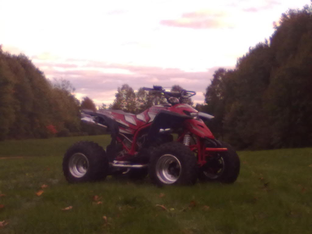

Dakotademon7's build gone addictive
Was looking at my jug and seen he even gave it a hone. It's cool he didn't charge extra for it but now I have to spend extra money for new rings. I fresh hone and rings will do it good.
why do u need new rings? if he didnt bore it or anything just a hone shouldnt require new rings unless you were borderline on clearance. ur ride looks great man, a true transformation I:I I:I

Nice job. I:I
