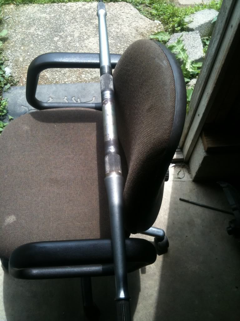

Just got my Banshee axle and brake hub. Cost? $21 to ship him mine in trade.

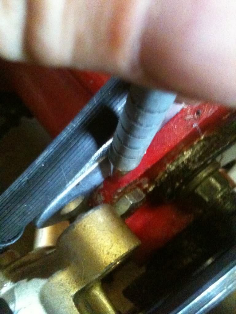

Finished mounting my Banshee axle today. As is, the GSXR caliper won't fit back on. Not big deal seeing that it's an easy fix. All I have to do is flip the mounting bracket to the inside of the carrier brake mount and use some washers to space it to line up with the non floating Banshee brake hub.

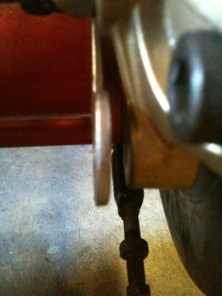

Worked on my GSXR brake mount today to get it lined up after changing to a Banshee axle. It's an easy mod to get it to work. As said before, I had to move the awk mounting braket to the inside of the carrier brake mount. That made a gap between the mount and caliper.
Had to use some washers as spacers but had interference with the washers where the top mount for the caliper from the carrier brake bracket.

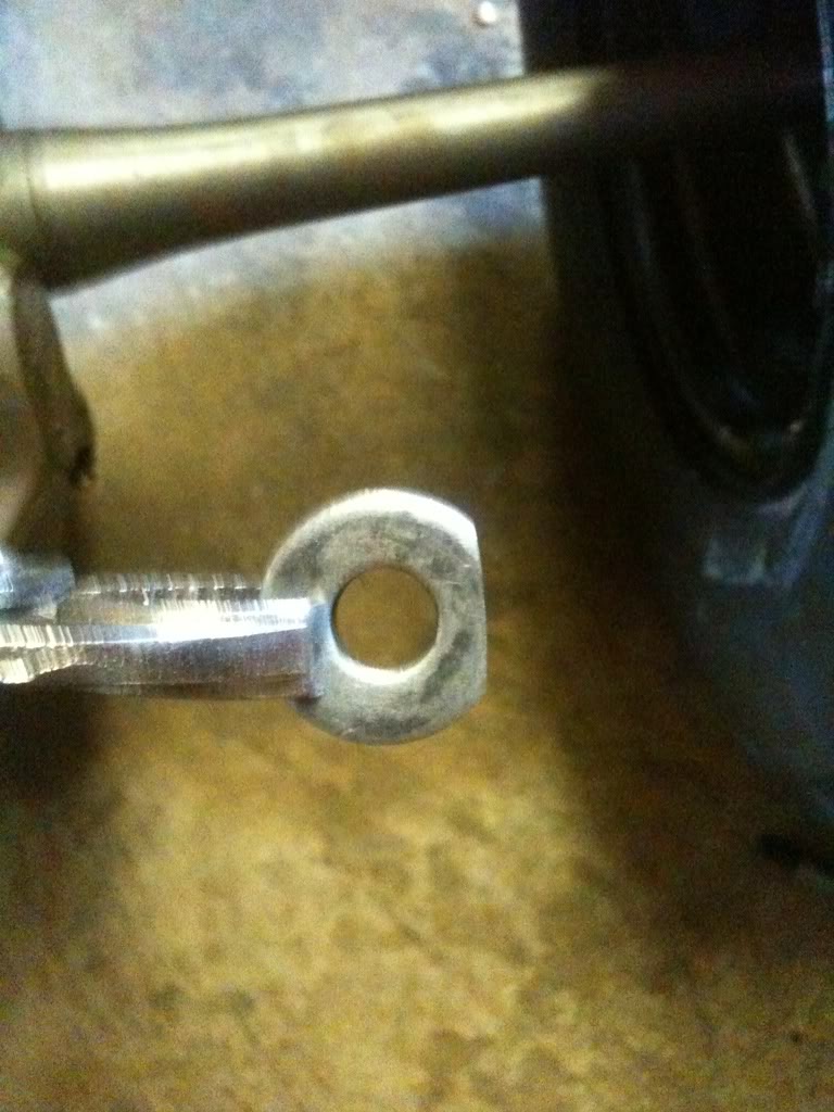

No big deal. I just ground down one side of the washers for the top mount.
