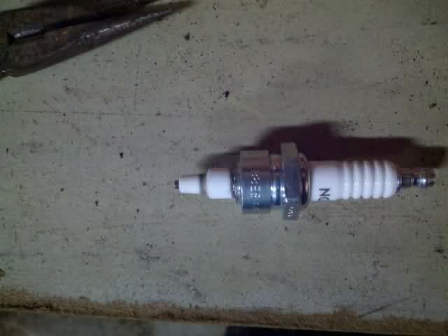

Running pig rich. 165 main, 50 pilot, airbox lid off. Runs good till ~1/3 throttle then just sputters, lacking power. Way rich on the main.

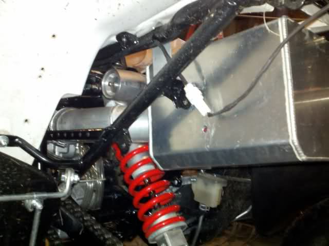

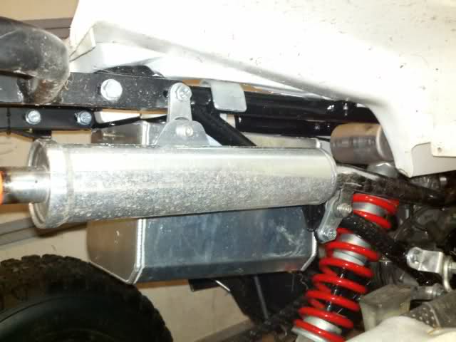

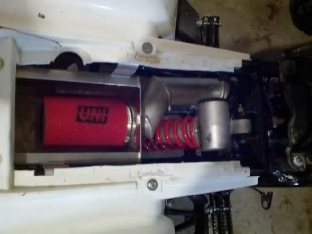

I used 1.5" wide aluminum stock for the brackets. Bent them over a pipe. Basically copying how the F7 boxes mount.
Not the best looking job but functional.
