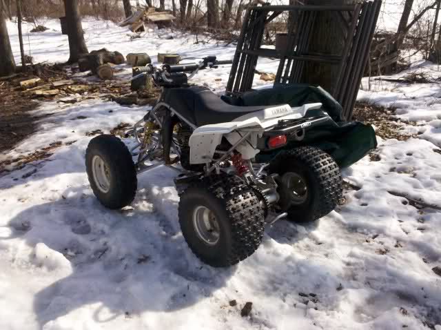

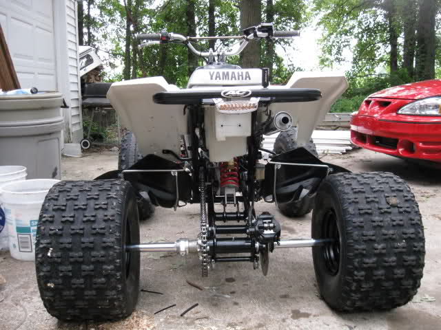

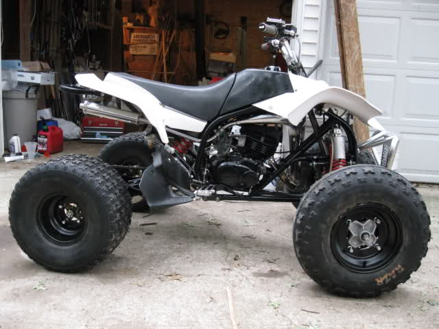

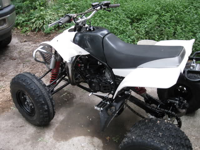

Got my taillight hooked up, zip-tied some loose wires, bled my front brakes, and a bunch of little things. Still need to remove a link from my chain.

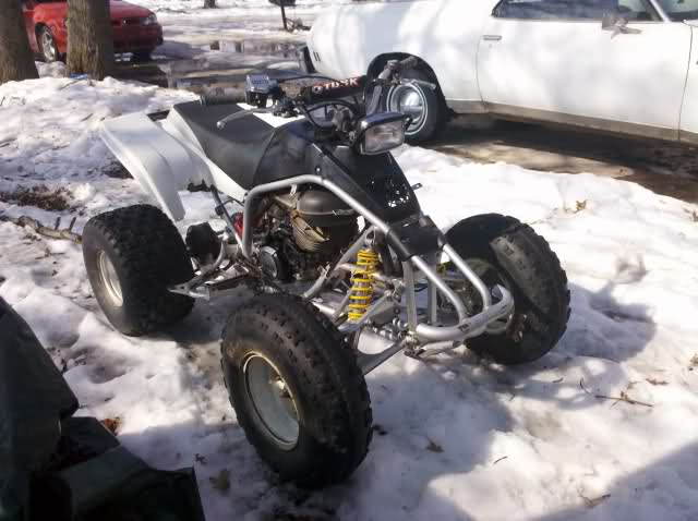

More pics!

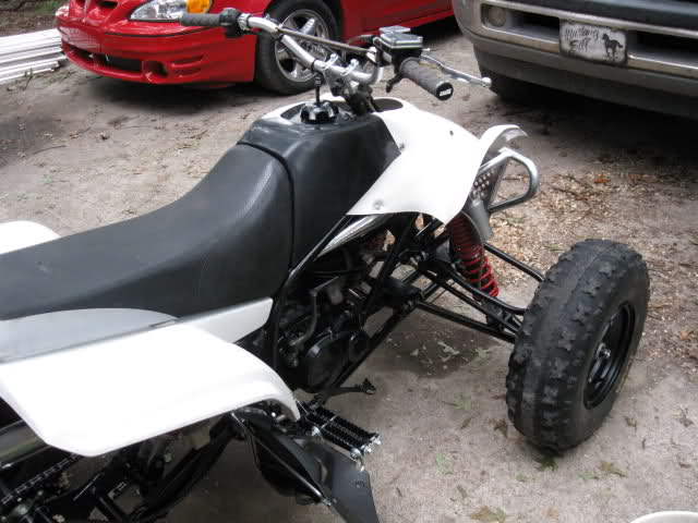

He forgot these too!

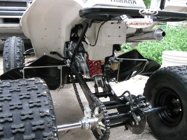

You'll notice that back tube is MUCH closer to the ball joint ring mount. THese should clear 6" backspaced wheels if you so chose to run them. I think all upper a-arms will be designed just like this from now on. The original design had the back tube and front tube parallel for aesthetics but they didn't work well that way for things like turning the wheels all the way....

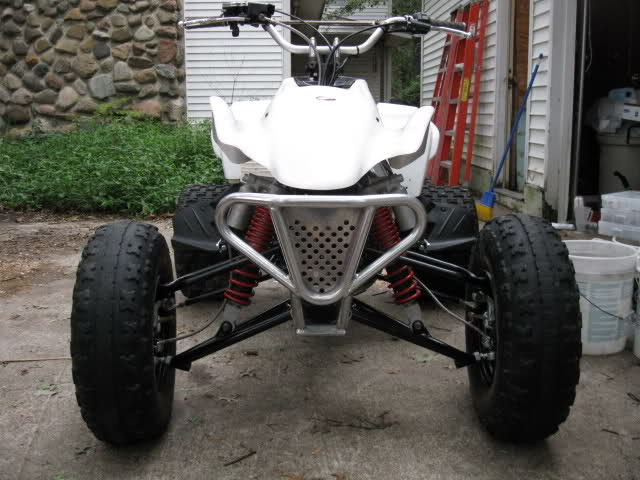

And those new arms look awesome.
