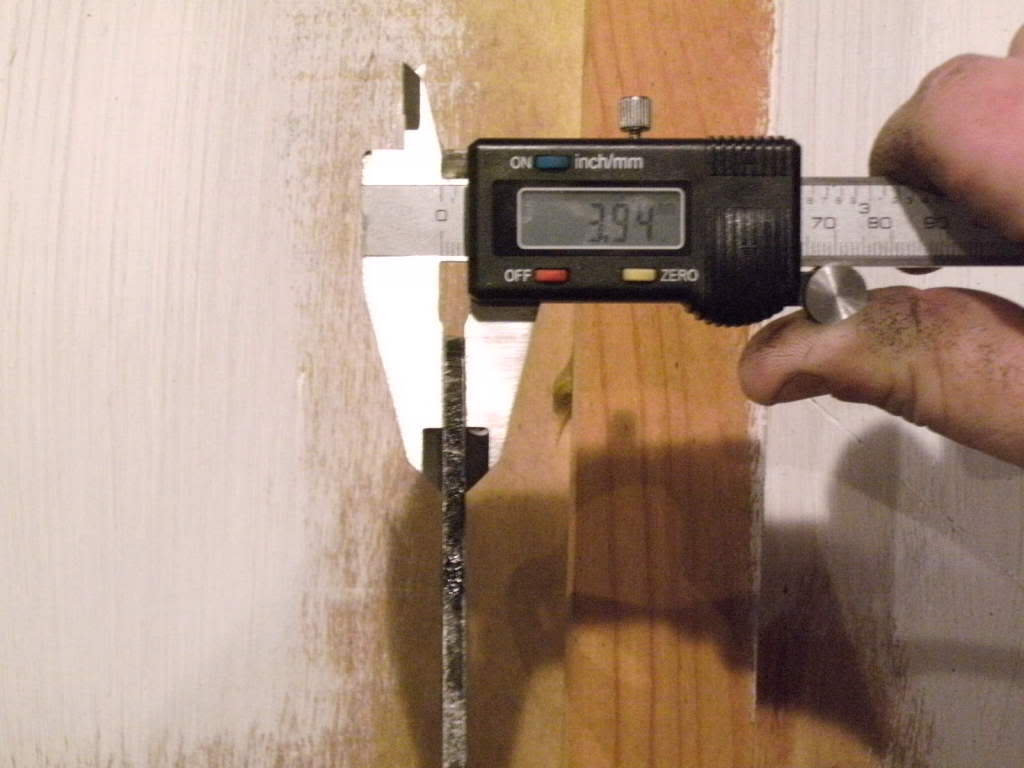

Ken, I will measure it tonight... I never thought there was but one thickness (1.5mm) so I never did measure it but I have the top end off right now doing the change over and can throw a caliper on it to see!
Alright the spacer plate is 4mm thick:

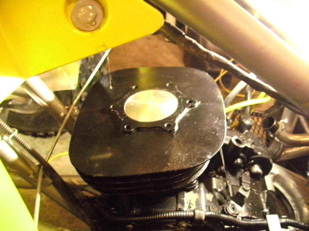

The piston at TDC:
The piston at BDC:
57mm of stroke but a 4mil stroker plate.
