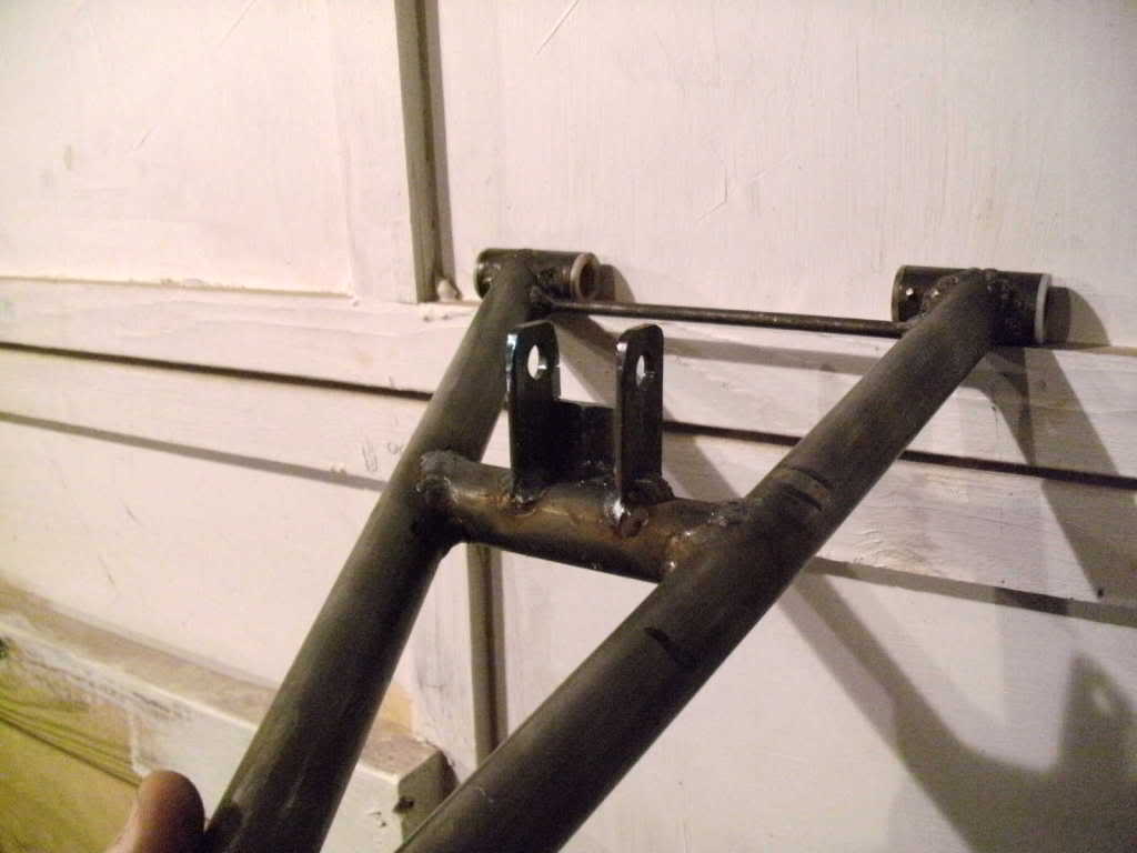

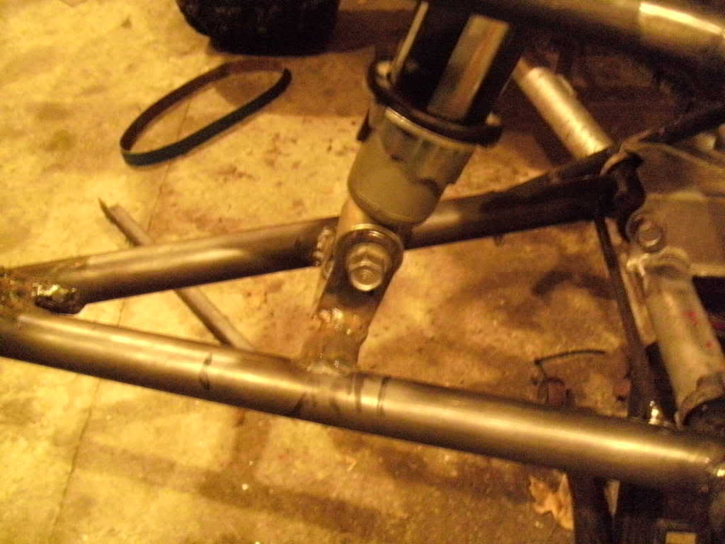

I worked on the shock mount tonight. I have the location hammered down for the making the rest of the jig but I'm not particularly happy with the right side lower control arm shock mount. I may actually purchase more 1" tubing sometime after I have rode this set of arms and rebuild the right lower control arm using the jig to make it pretty and to the dimensions I really want.

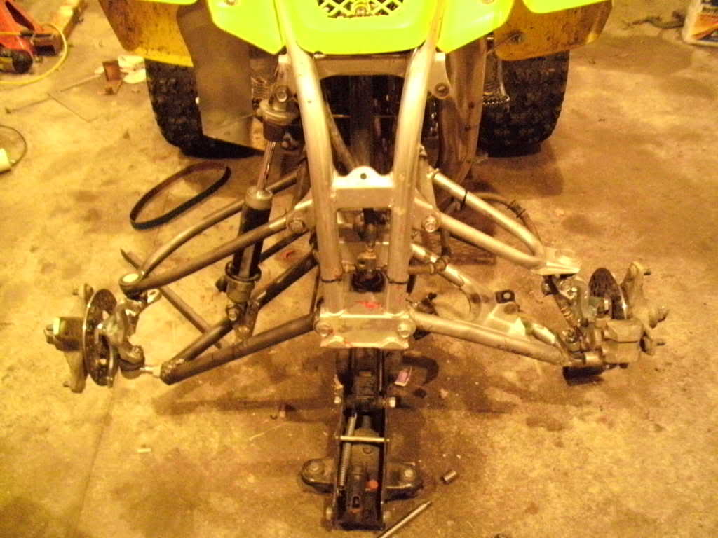

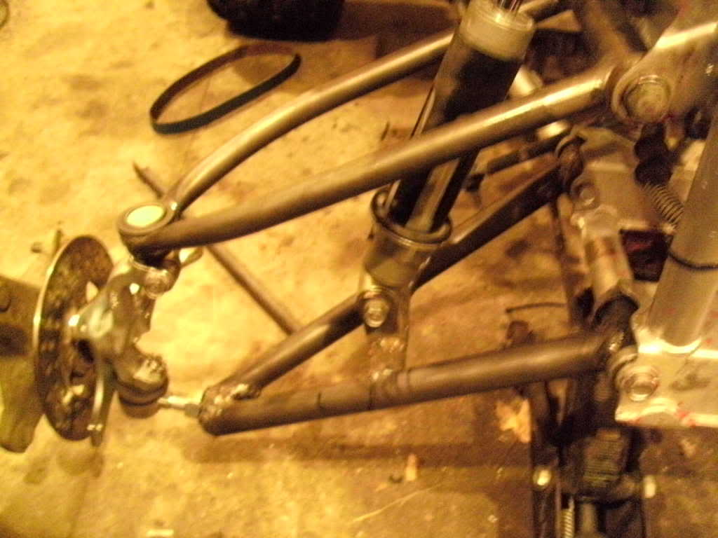

I also measured the suspension throw. 8 3/4" without bind

Lookin good! ... If ya still have the stock arms on the left could you measure stock bind to bind travel? one of mine is about 7 3/4", it's a warrior spindle & modded top arm but I think it's close to stock configuration. With stock shock, the travel is about 6 1/4". Be nice to have a stock baseline to see what's being gained.
Thanks
The stock bind to bind travel on the left side of my quad is only ~6 1/2". You can see in the second picture how much lower the new suspension is than the factory stuff and the factory stuff is sitting at bind with no shock in there and the new stuff has the shock mounted. The stock suspension really doesn't leave anything on the table so this is pure improvement.
I'm actually still not happy with that shock mount. It is leaned outwards far too much. I really only put it in there to be able to measure everything I wanted. I'm going to run it but I'm also going to change the design (but not the dimensions) for the left side so the pictures of the left side will be the new and improved design for the lower shock mount. If I make any more sets they'll be of the new design. Be patient, I'll post pics of the new design after I get it all hammered out.

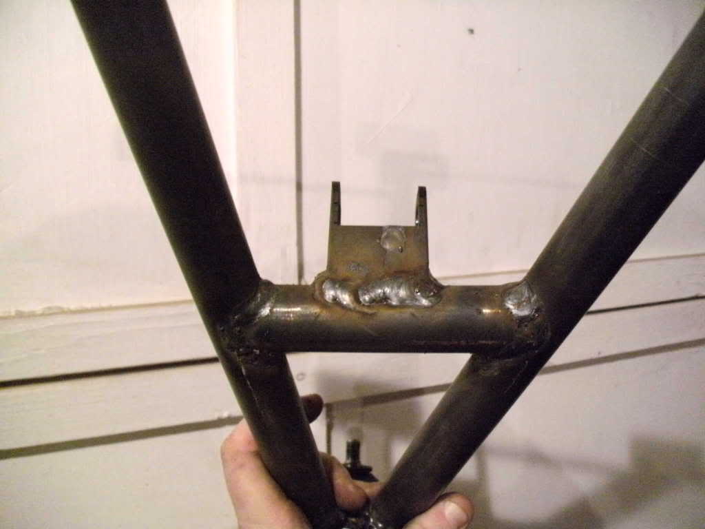

take this as constructive criticism...
that lower ball joint mount does not look to safe too me, whats the size of the ball joint shaft (diameter)? not to mention a lot of its shaft is showing thus allowing for a greater moment to bend it
im willing to bet that if you take a good jump or a section of whoops, that bottom mount will be toast
also, are you using a 220 welder? it doesnt look like your getting much penetration and its semi gobbed on, that shock mount wont survive either
i applaud you with your attempt, but it needs some work (not trying to be a dick)

The set I took those pictures of is the mock-up set. I even went so far as to say that I wasn't happy with the shock mount and was going to change it. The left side arm is now at a better angle and should be resilient.
The plan is to order threaded tubes with the lower ball joints and put them into the mix for total inclusion into the lower arms. Take a look at most aftermarket arms. They use a tube that's the same thickness as my arm tubes and then put a nut on the backside to tighten the ball joint into it. How is that any stronger?
Those are 16mm fine threads, which is exactly the size most aftermarket arm sets use. The lower ball joints are the Ricky Stator ball joints so they're plenty strong.
I am using a 110 VAC mig with the amperage turned on position 3 of 4 to keep the warping to a minimum. For further sets I will compensate for warping by clamping and run the welder on 4 of 4 for better penetration. This ain't my first rodeo, mister.
I do appreciate positive criticism, actually. Any other issued you see?

but only 110? ive welded with 110 and 220 and IMO idk why but the over all weld looks better to me with the 220 plug
but your welds look decent and i cant remember but did you say your using chromoly or just steel?
if your going to start making these you should go to 220, your welds will look 10 times better
that or get a TIG unit, i love mine, it was hard to switch to it, but well worth it in the end and mainly much stronger than MIG welds
I would love to have a 220 Mig but if I was going to do that, I'd buy a Tig and we wouldn't be having a discussion about weld quality then.
It's chro-moly except for that mount you're talking about looking all boogered and splattered on... Also, because each set of pictures was taken out in my garage while it was dark outside and my camera was catching the glint off of each weld fold and showing it really bad. I'm going to take pictures of the left side arms (the better of the two sides I've made so far) while the sun is up.
