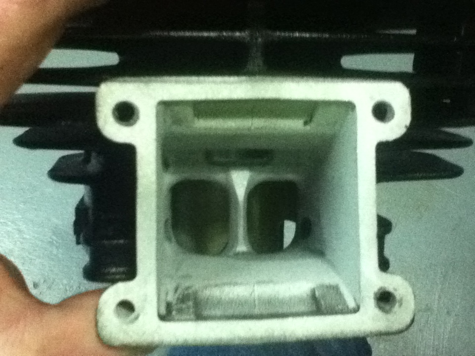

that a good reson for sure. back to the case and motor. the cylinder looks great. those intake ports a huge. putting your cases back together will be just as fun as taking them apart.
I am eagerly waiting for a cylinder with a KOR port job the enter my mail box, if it is anything like the above I am sure my forearms are going to be punished.
