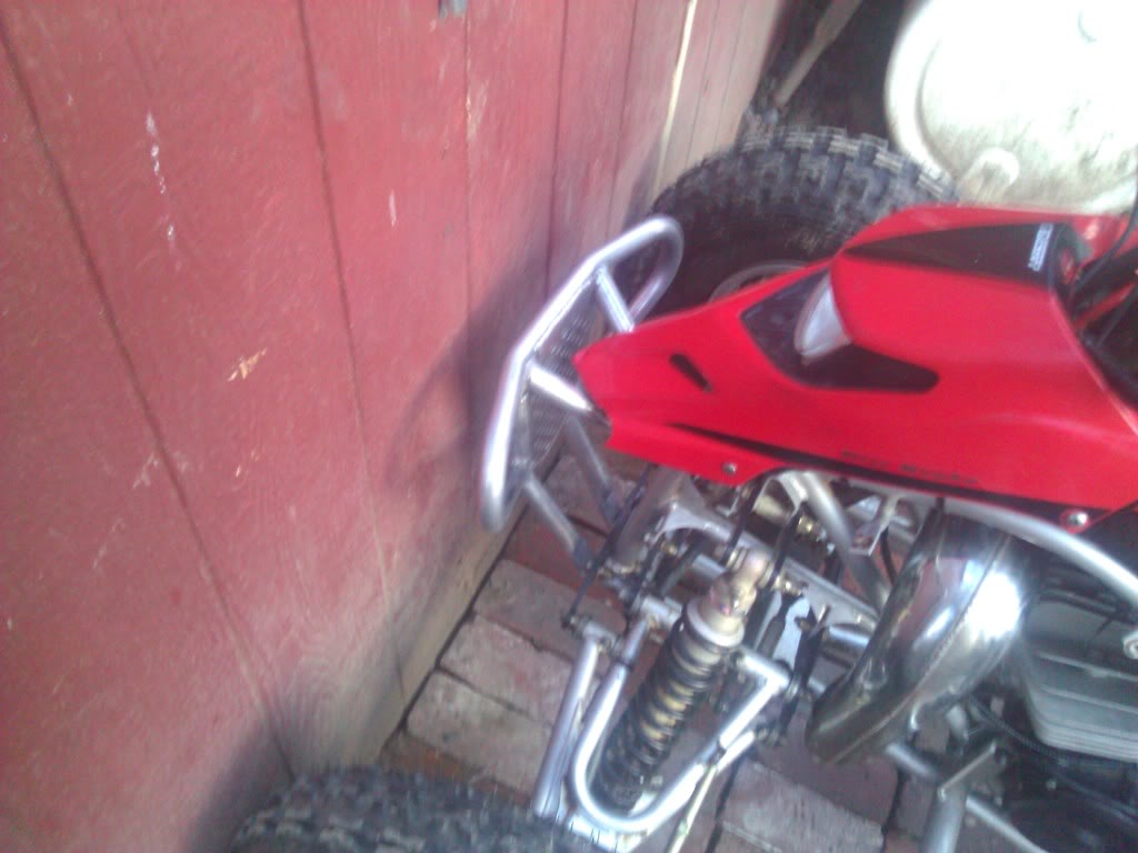

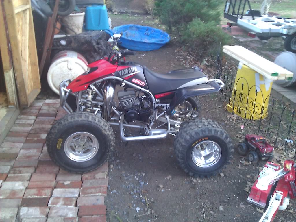

update: pics and got my bumper installed

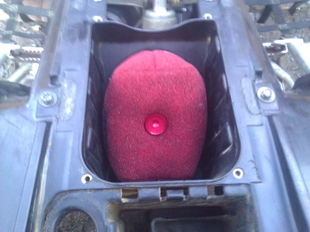

billit air filter screw i got for $5 and i finally put my new uni on.

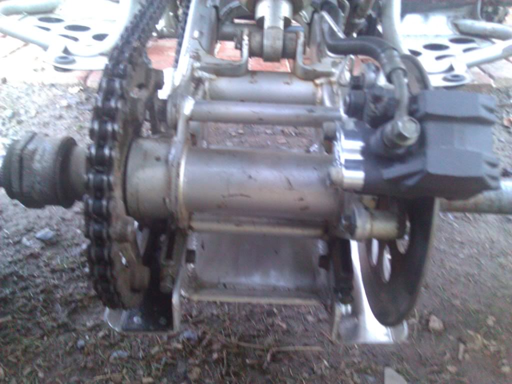

new swingarm skid plate i got for 27 bucks and lsr block off plate i got for $9.
oh and put a br9es plug in to see if i can just run 93oct without detonation and so far so good but only idled it and reved also i changed the needle clip position from the second spot up to the middle (third) to see if that would change anything
