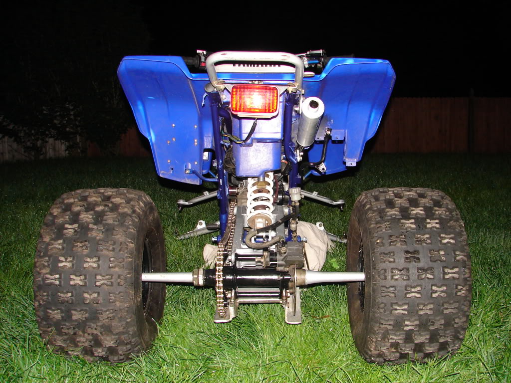

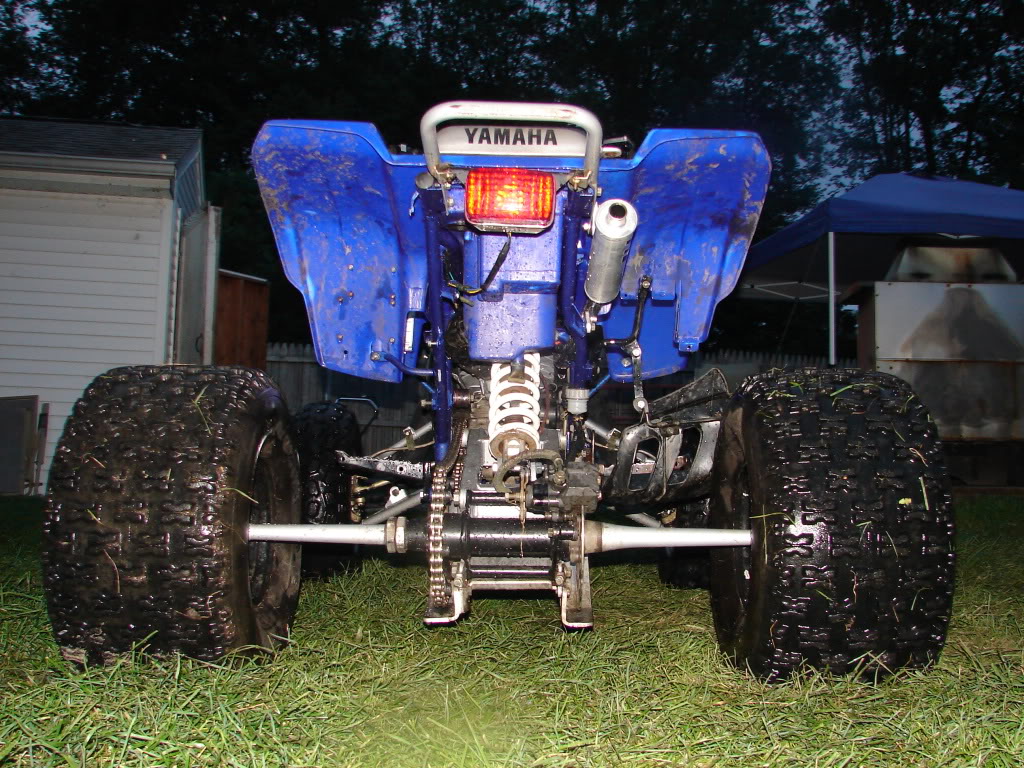

Well I wasn't happy with the way the back looking shorter than the front ... Both measured the same length but it looked shorter so I put the spacers on the back.
Before:
After:
A little too wide. If I don't end up liking it I will take them off

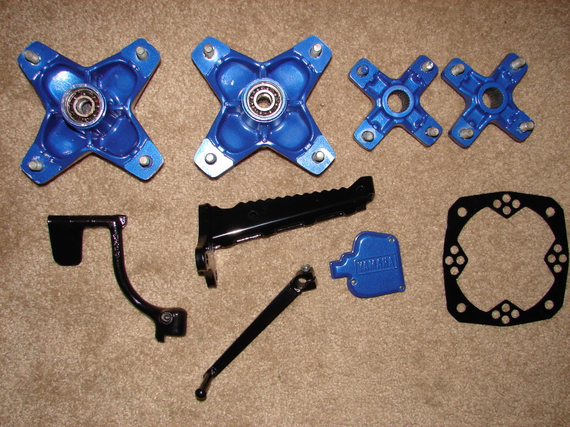

Started powdercoating tonight. Not bad for my first try. I'm using the tiniest toaster oven in the world but it gets the job done. I still have more parts to coat, I stopped here tonight:
**** I know about the bearings in the front hubs, I have a set of new bearings and seals sitting here on my desk.
The hubs and throttle cover are done in Blueberry Metallic powder. 3mil is doing my frame in the same color. The frame is 100% paid off, should have that in here this weekend. The rest of the parts are done in Gloss Black powder. Also bought 3mil's billet stator cover off his drag bike. SCD Arms are almost payed off. Things are looking good :D
