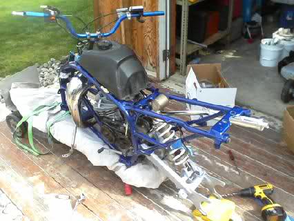

Got the rear suspension mounted. Need to trim off some plastic from the airbox so the shock reservoir can fit. It's a tight fit and took a while to get on. Now I realized that I don't have the swingarm dust caps :o . Need to take it all apart again :(
And I also need to get a longer rear shock bolt. The relocated shock mount has tabs that are thicker than the stock ones, so the bolt doesn't go through enough for me to get the washer and cotter pin on.

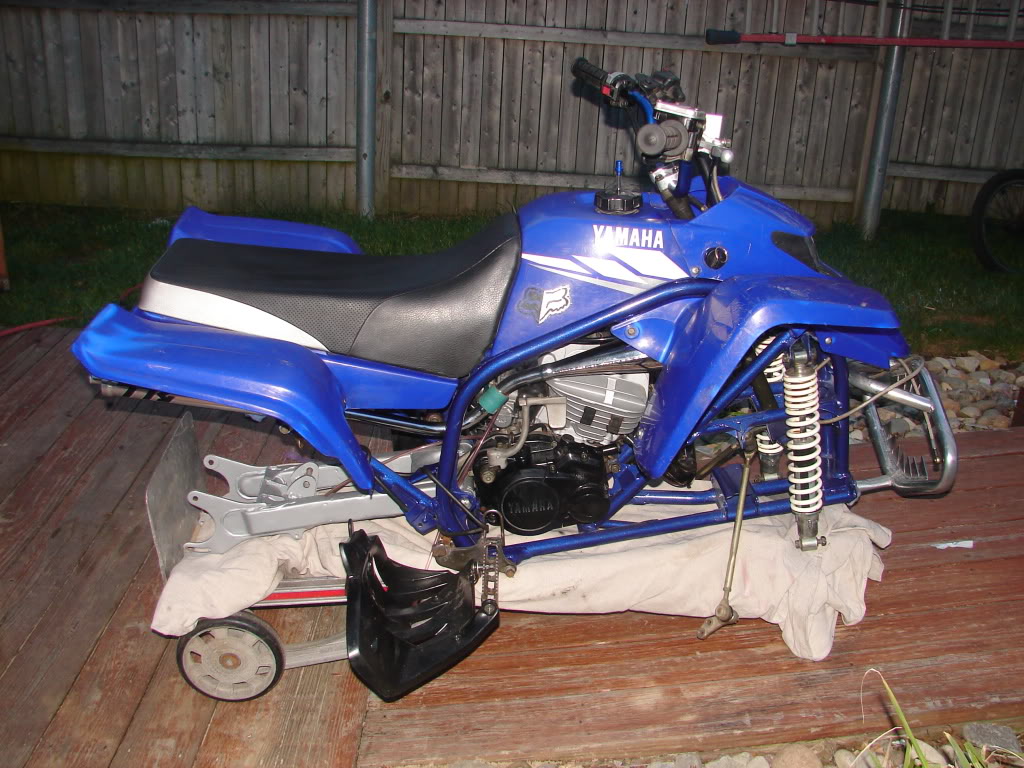

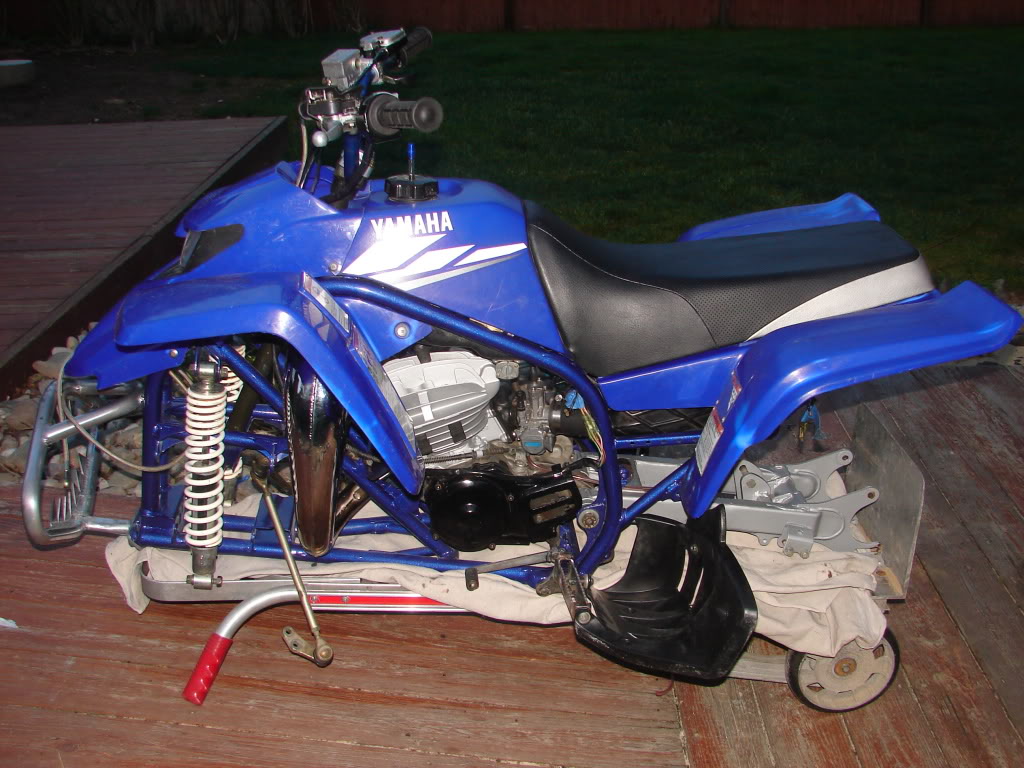

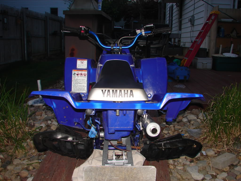

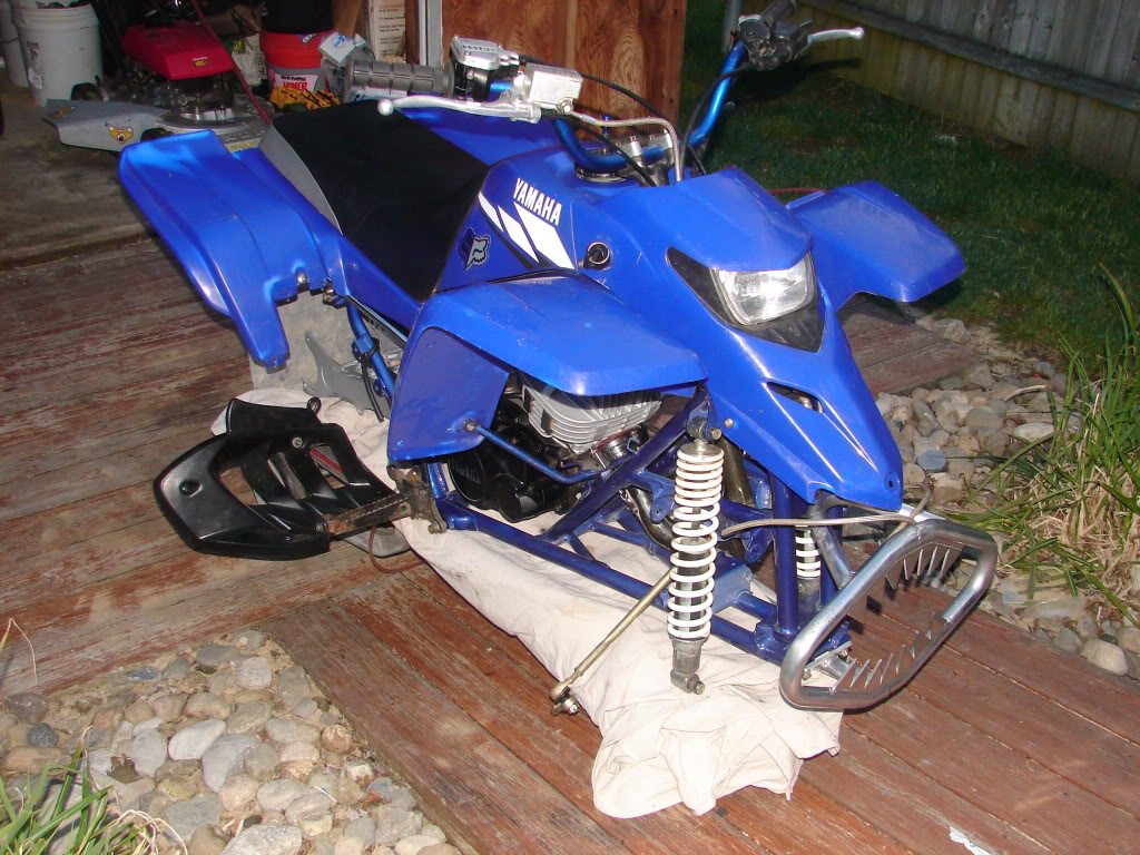

Assembled a little tonight. I really want white plastics, the blue just doesn't go with it all well in my opinion. She starts first kick every single time I go to fire it up. Pretty much waiting to get some parts powdercoated to assemble completely.
Also need to get peg bolts, since mine are rusted to sh*t!
As you can see in the one picture, I'm using the crankcase vent tube to hole up the peg + heelguard. I need peg bolts!
