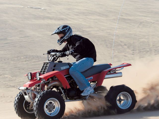

Another option is to mount it or a second rad on the front, like a Raptor or Banshee.
(How does he see on that thing?)
