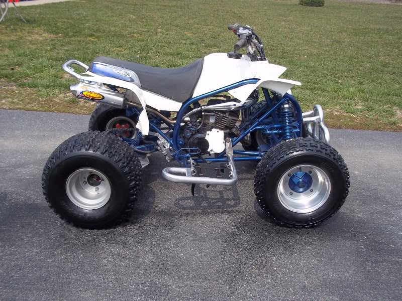

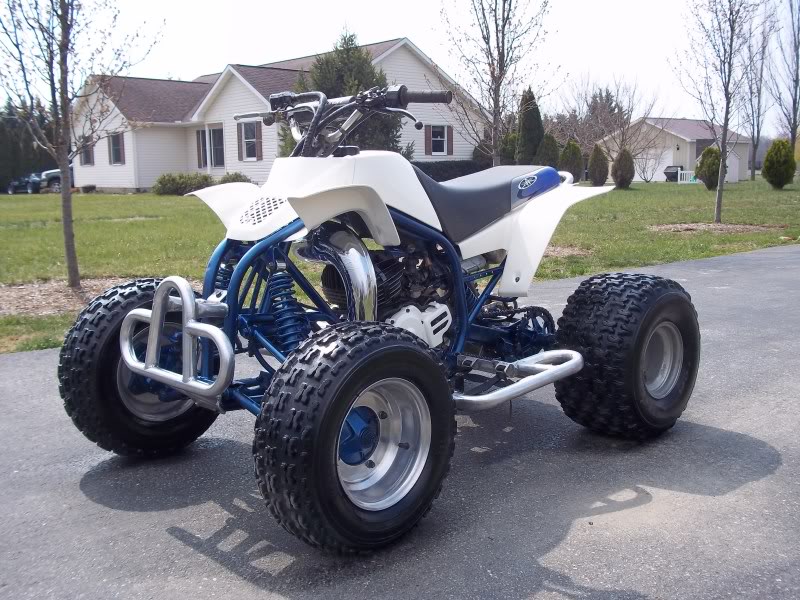

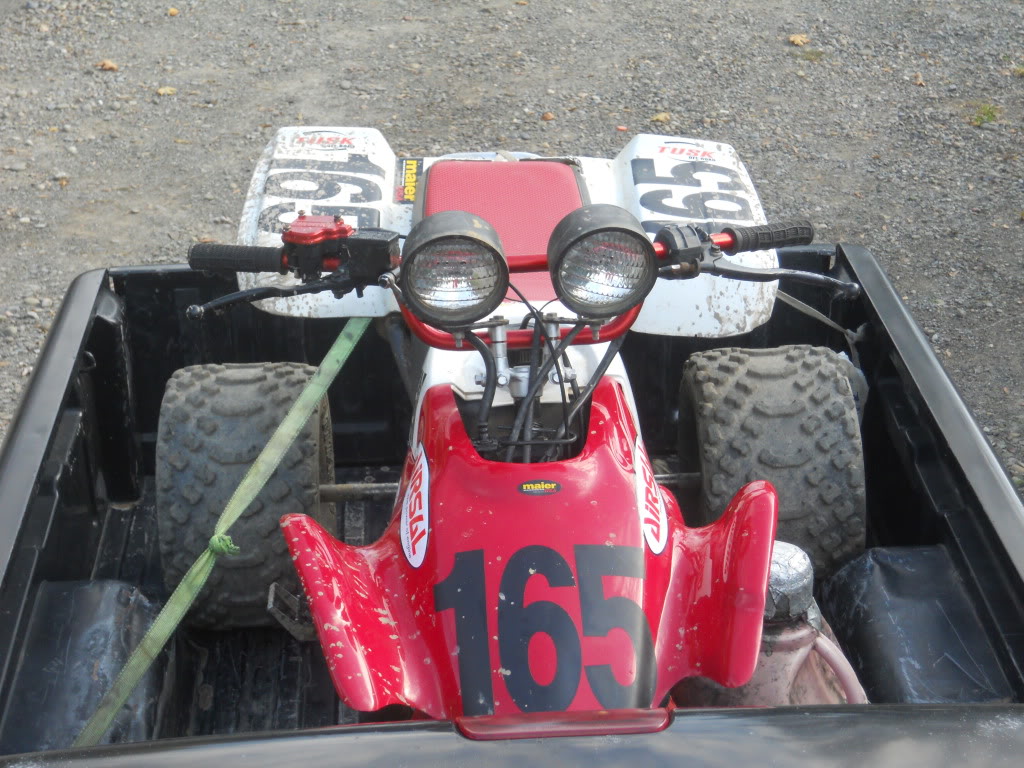

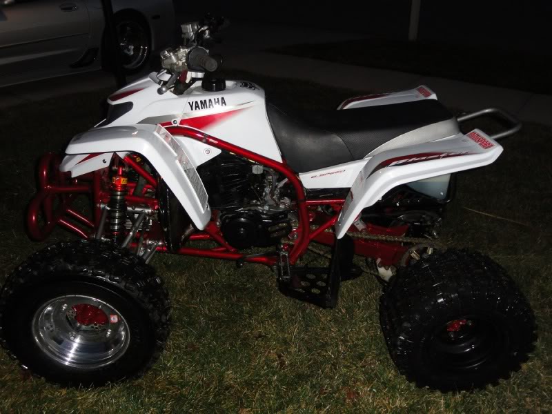

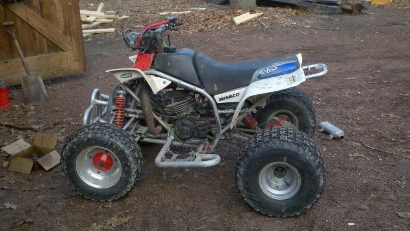

Mine's pretty much a stock 89 that the previous owner claims he'd just rebuilt it. I bumped the timing 4 degrees, added a hyd rear brake setup courtesy of awk ( thanks again ) added an fmf sst pipe and jetted the stock carb up. I also did some painting and fender slicing .
Before
After

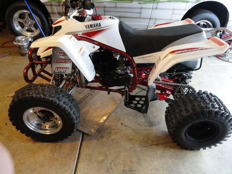

A Arms: ASR +3 up 1
Swingarm: Swingarm shop +4 Powder coated silver
Steering Stem: Stock
Axle: Polished stock
Carrier: Stock
Locknut: Polished stock
Hubs F|R: Stock
Bars: Powder coated stock
Throttle/Clutch Lever: Magnum EZ pull
Grips: Scott Hurricane
Bumper: DG
Grab Bar: Custom +2
Pegs: Custom double wides w/kick-ups
Front Shocks: 06' YFZ450
Rear Shock: 06' Stock
Brake Line: Stainless
R Brake : 03' CBR600RR
R Rotor : 03' CBR600RR
Rims F|R: DWT .160
Tires F|R: F/ 22" Maxxis front pro's R/ 20" Kenda Dominators
Body:
Frame: Stock, modded to fit the motor
Plastic: Maier
Graphics|Seat Cover: 79' YZ400 w/ Hurricane Hannah bolts! / stock seat
Bar Pad: 79' YZ400
Fuel Tank: Stock
Engine|Drive System:
Cylinder|Head: Flotek ported. Milled / rechambered head w/o-ring groove
Bore & Stroke: 83mm x 75mm
Displacement: 406cc
Cam: R U serious?
Carburetor: Polished Keihin 38mm air stryker RDZ meth converted w/billet oversize bowl and powerjetted
Air Filter|Box: K&N w/outerwears cover / CFM airbox
Pipe|Silencer: Trail- YZ400 DG pipe. Quadzilla FMF silencer. Drag- Custom FTZ Racing out of frame pipe
Clutch|Plates: Flotek pro-lock Banshee clutch w/Banshee TZ bearing mod on the pusher
Gearing F|R: 15/40
CDI|Ignition|Killswitch: YZ400 CDI/ Nology coil and hot wire/ Tusk tether kill
Reeds: Custom Mototasinari V-Force 3's
Cooling: AIR

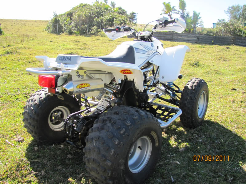

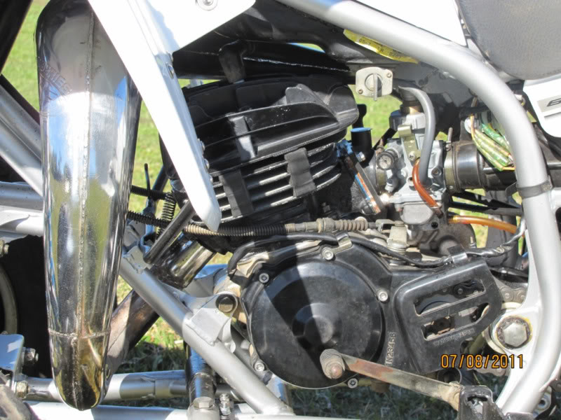

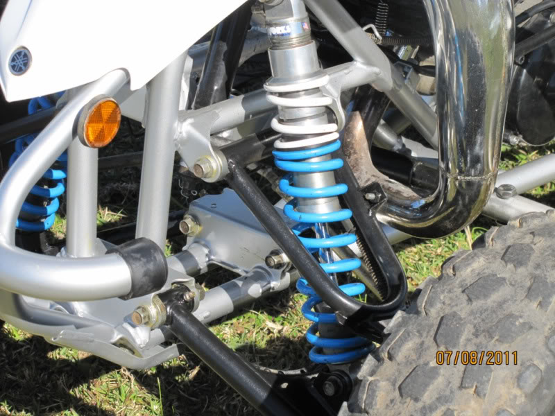

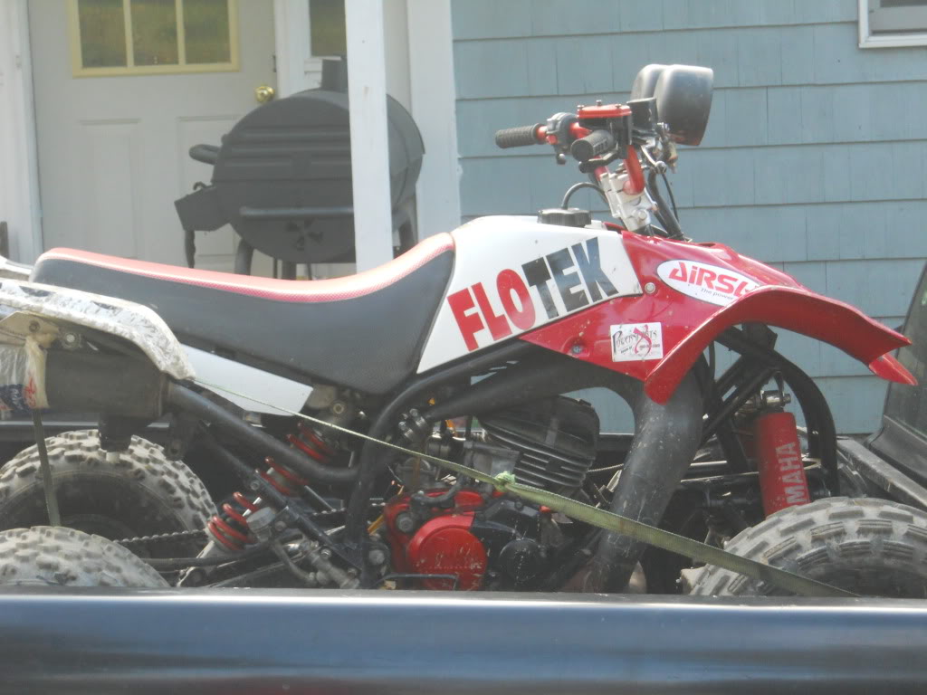

My cousins 2006 Blaster.
Ported stock bore.
Boyeson Dual stages
FMF SST
Works Dual rate shocks
And some other stuff I cant remember.....:)

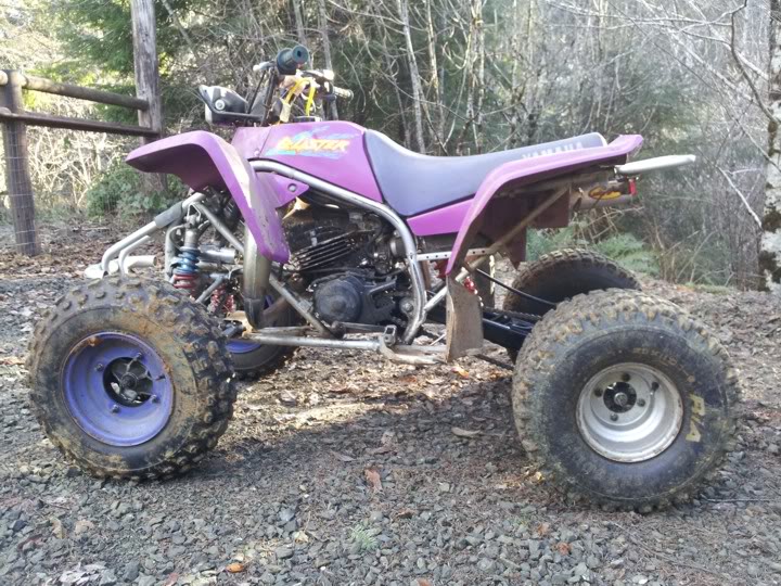

I can read lol.... Didnt see anything about a completly different engine. But after looking at the botom end it is definatly not a blaster engine.
It's a YZ400 engine - hence the YZ400 DG pipe, CDI, and graphics :p
