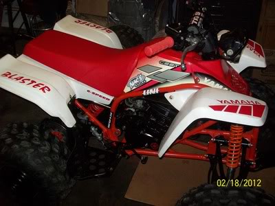

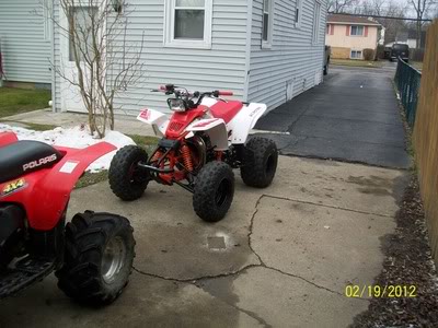

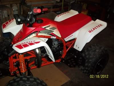

Trail ride Blasters (only) Post your Pictures and Specs.
92 sleeper
Motor
Stock bore
Stock stroke
New yamaha Crank/bearings/seals
Flotek agressive trail port cylinder
Milled/rechambered head
WSM Forged piston/rings
EBC clutches/plates
Oil injection removed and plated
Vito base/head gasket
155 PSI Comp
Air/Intake/exhaust
DMC alien comp exhaust
Cleaned up reed cage/Boyesen duel pedals
Stock 26mm Mikuni open'd to 30mm
Stock pilot,banshee needle,300 main
Tors removel kit
Airbox snorkle cut/ 8x 1" holes in lid
Custom wrapped lid
UNI duel stage filter
Banshee tank valve
Suspension/frame/gearing
400EX rear shock
Stock front shocks (for now)
+1.5 swinger (+3 is now needed)
Stock arms
+2 axle
14/40 gearing
22x11x8 radial rear tires
Stock size fronts
gsxr 1000 rear hydro conv
Stock vesra grooved front breaks
Custom machined stainless rollor guides
Praxair sermetel slurry coatings
Custom seat cover/pad
A Arms: ASR +3 up 1
Swingarm: Swingarm shop +4 Powder coated silver
Steering Stem: Stock
Axle: Polished stock
Carrier: Stock
Locknut: Polished stock
Hubs F|R: Stock
Bars: Powder coated stock
Throttle/Clutch Lever: Magnum EZ pull
Grips: Scott Hurricane
Bumper: DG
Grab Bar: Custom +2
Pegs: Custom double wides w/kick-ups
Front Shocks: 06' YFZ450
Rear Shock: 06' Stock
Brake Line: Stainless
R Brake : 03' CBR600RR
R Rotor : 03' CBR600RR
Rims F|R: DWT .160
Tires F|R: F/ 22" Maxxis front pro's R/ 20" Kenda Dominators
Body:
Frame: Stock, modded to fit the motor
Plastic: Maier
Graphics|Seat Cover: 79' YZ400 w/ Hurricane Hannah bolts! / stock seat
Bar Pad: 79' YZ400
Fuel Tank: Stock
Engine|Drive System:
Cylinder|Head: Flotek ported. Milled / rechambered head w/o-ring groove
Bore & Stroke: 83mm x 75mm
Displacement: 406cc
Cam: R U serious?
Carburetor: Polished Keihin 38mm air stryker RDZ meth converted w/billet oversize bowl and powerjetted
Air Filter|Box: K&N w/outerwears cover / CFM airbox
Pipe|Silencer: Trail- YZ400 DG pipe. Quadzilla FMF silencer. Drag- Custom FTZ Racing out of frame pipe
Clutch|Plates: Flotek pro-lock Banshee clutch w/Banshee TZ bearing mod on the pusher
Gearing F|R: 15/40
CDI|Ignition|Killswitch: YZ400 CDI/ Nology coil and hot wire/ Tusk tether kill
Reeds: Custom Mototasinari V-Force 3's
Cooling: AIR
A Arms: ASR +3 up 1
Carrier: Stock
Hubs F|R: Stock
Bumper: DG
Grab Bar: Custom +2
Rims F|R: DWT .160
Body:
Plastic: Maier
Bar Pad: 79' YZ400
Fuel Tank: Stock
Displacement: 406cc
Cam: R U serious?
Gearing F|R: 15/40
Cooling: AIR

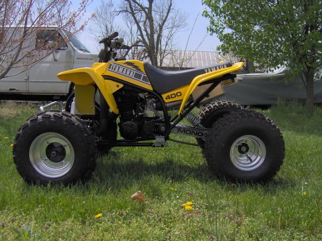

Need some info on your build bro, if you got the time
My 99
