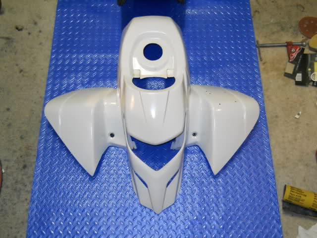

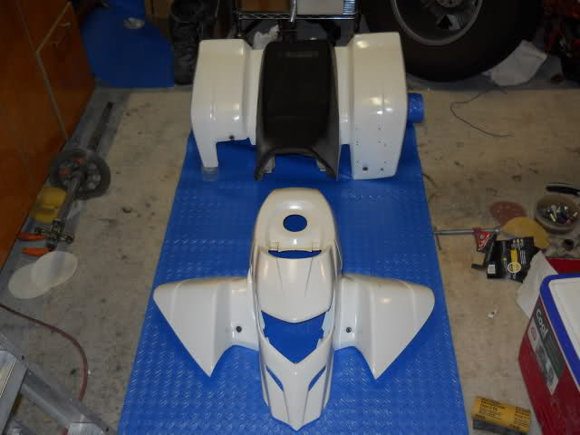

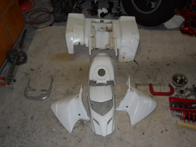

ok heres some pics of what i did today on the blasty. needed to clean up my dirty, scratched up plastics, and took all the stickers off. this is the pic before i sanded them but after i took the stickers off.
still need to cut out my airbox
and here are a couple after sanding and a few clearcoats.

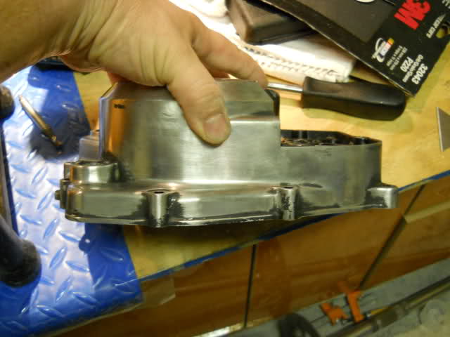

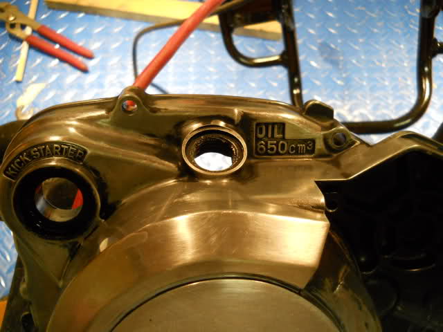

someone asked for a polishing diy well read it here. here is the first step. stripping the paint(if the part is painted) I used aviation stripper and i would suggest buying some decent rubber gloves bc these latex ones just kept melting. I also used steal wool to scrup the paint off after teh stripper started working
this is what it looked like after the stripper. as you can see there is still sanding work to be done
well that's it for today. probably start polishing tomorrow
