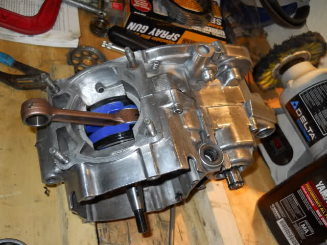

the crank bearings are hotrods. and no i didn't replace all the tranny bearings. they are in good shape and it was a bit pricy to buy new ones when not needed. just had a scare. thought that i was going to have clearance issues with my +3 crank but i put the other case half on and used an old jug and piston to move the crank and there weren't any clearance issues with the crank when everything was together. now i have to split the cases again though. pain in the arse but worth the peace of mind in my book
done for the day
got the crank in and mocked up top end to make sure of clearances.
finally got it the cases together after a long hard fight. I had a chewed up locator pin that i couldnt' get out and it was makin the cases come together crooked. got it figured out after like 5 times trying to get it together

and sometimes the vito's crank has clearance issues at the opening there at the top of the cases.
