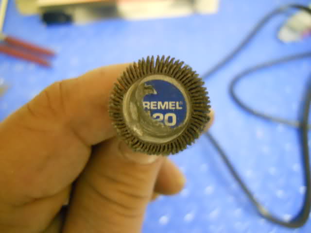

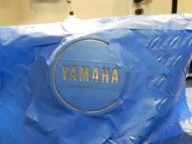

ok been workin on my new clutch cover(thanks to whitty) here is the dremel sandpaper wheel that i used to take off some of the paint i didn't get with the stripper yesterday.
this costs like 8 bux

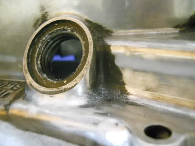

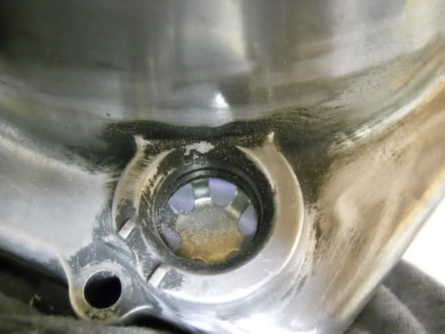

here's what is left to try and get off. all the tight corners look like this.
one more

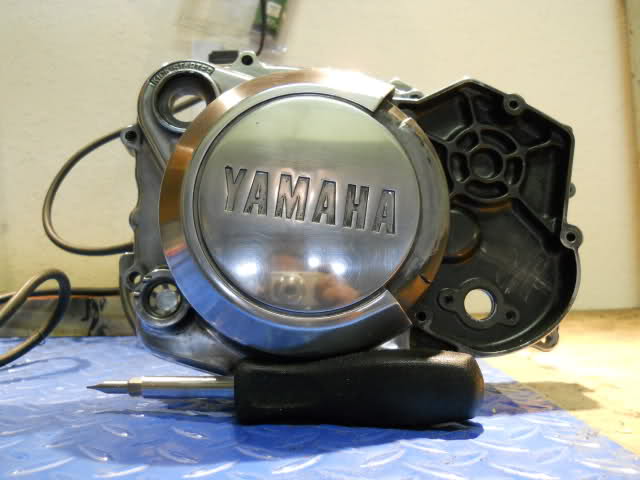

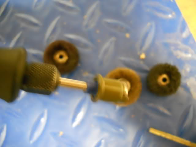

here are the buffer whells i used after the sandpaper wheel. these don't last long and cost like 4bux for 2 and you need the dremel quick conect to use them.

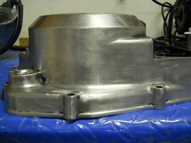

here's what was left after the buffer wheels. you can also use these to smooth out scratches from the sandpaper wheel.
one more

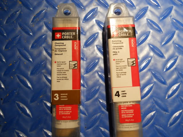

these are the two polishing compounds you use on the polishing wheels that i got from caldwells... i think is the name of the place. that's where i got the wheels not the polish. I got the pollish at lowes

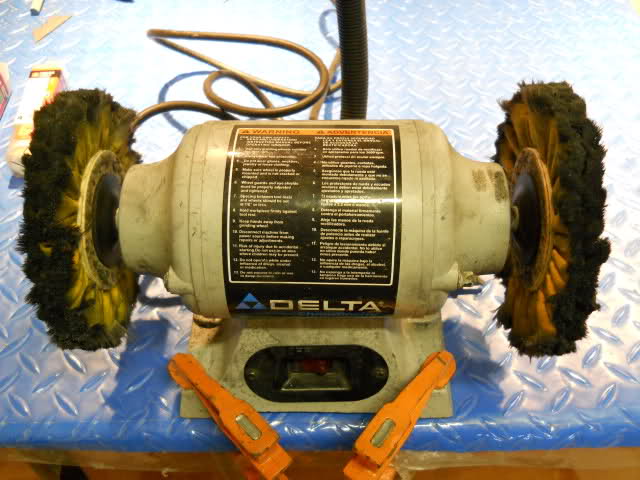

just a normal 6" bench grinder

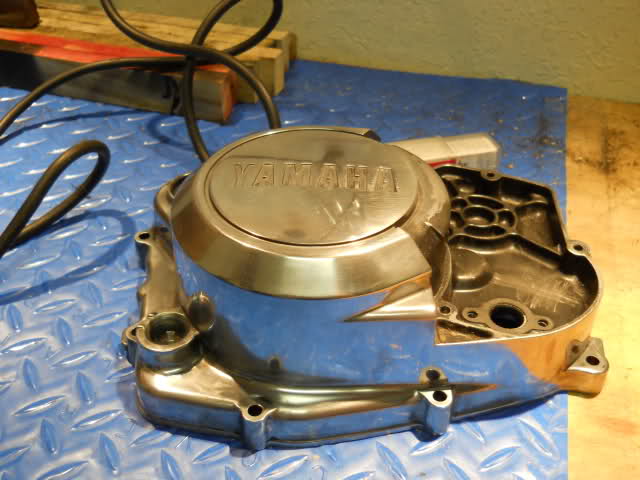

this is after the brown pollish only. takin a little break
one more
If you lived closer scot i would media blast it for free for you and save you a ton of work, well that offer stands for anyone who lives near me that needs free media blasting on blaster parts. We use a glass bead that does an amazeing job on topends, bottoms or covers.
man that looks good, but on the other hand its going to look like sh*t the first time u ride it in the woods and trees and brushes rub against it, thats the only thing stopping me from doing it, all that work and to see it get all messed up is gonna hurt
I have not lost my grasp on reality for one second and started to think that all this hard work is gonna last forever. I don't really care how thrashed it get's from ridin that is kidna the point of a quad is to run the hell out of it. It will just make each freshen up ezer in the future. and that isn't white paint it's clear so if it chips you won't even hardly see it.

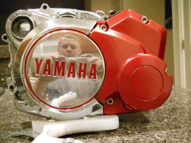

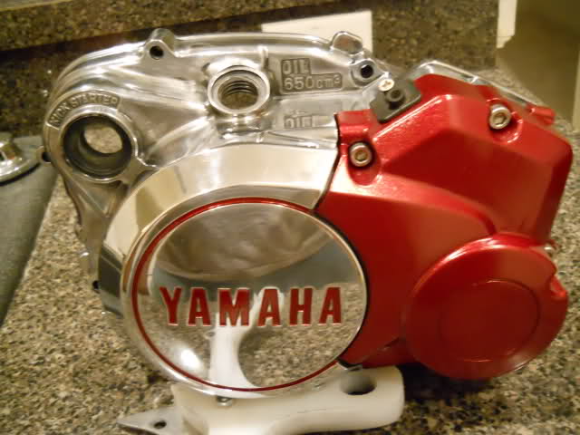

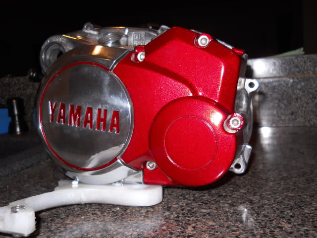

alright last update for today. here's some pics of my finished cluth cover.
can you guess whats comin next? lol
I had to tie the clutch cove into my color scheme
this one shows the paint alittle better
just another angle.

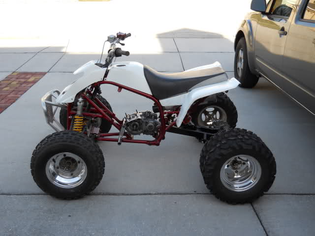

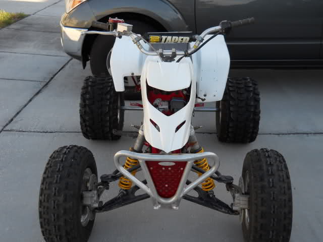

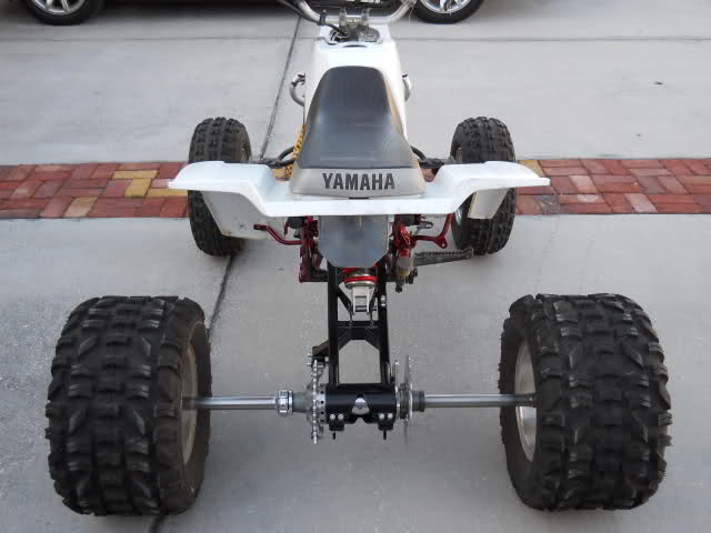

I got her rollin today. What do you guys think about the new stance? everything is just mocked up for now. don't really want to get ahead of myself
It measures 52" wide
