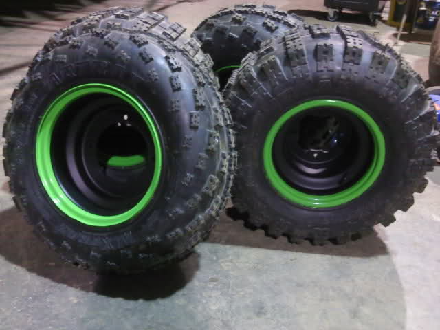

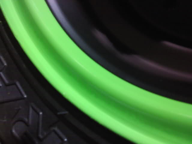

Finally got some pics of the wheels. took alot of time but im happy with them
