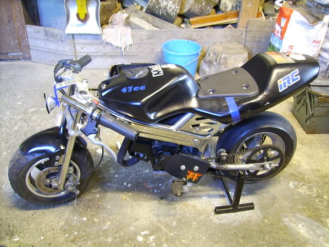

Heres what im selling
Back to quad this evening :)
haha yea would be fairly good alright I:I Im just fed up with small bikes, there what i started out on, and i know them inside and out, that bike starts on 2nd pull even if it has been sitting for 2 two months, but there just terrible to work on. Too small

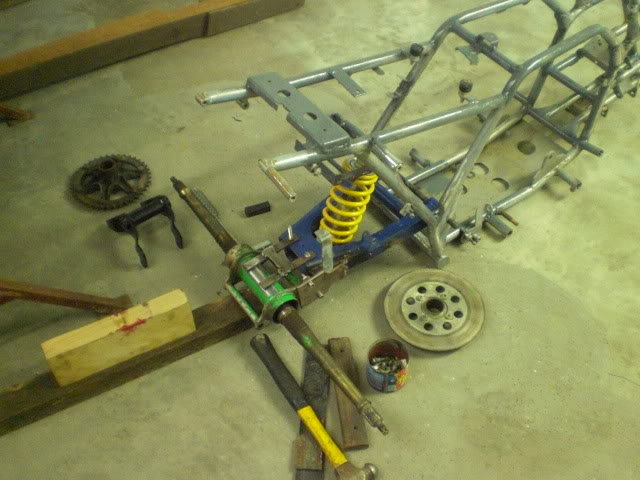

Right so back to the quad,

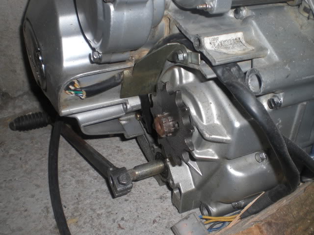

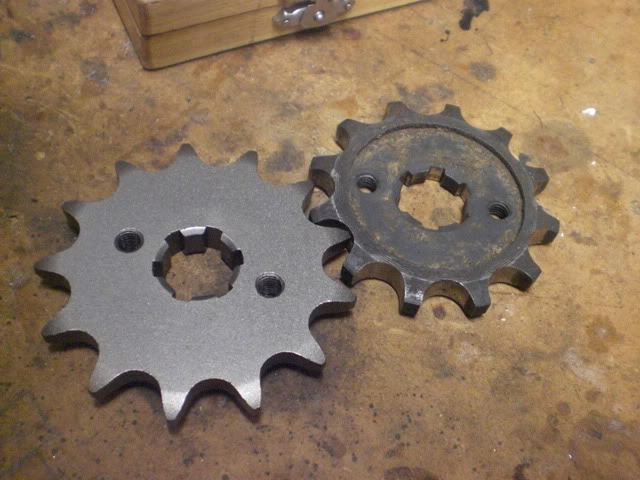

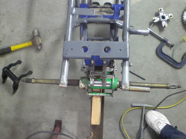

Here is the 13t sprocket i bought (left) to the original 12t, should clear things up a bit, im not all that great at the explaining.

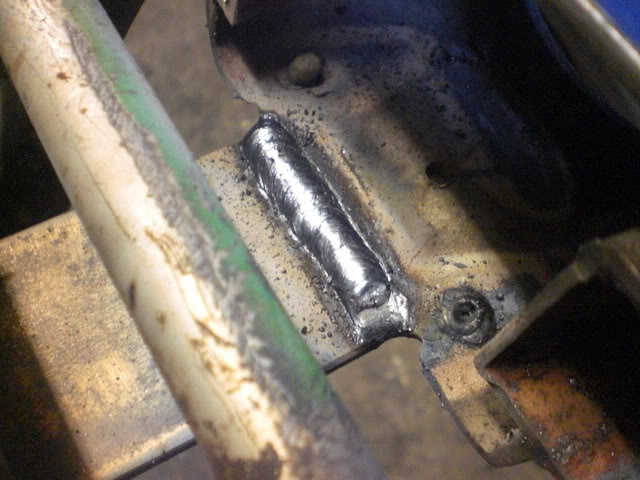

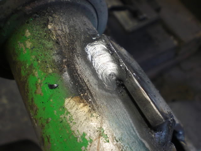

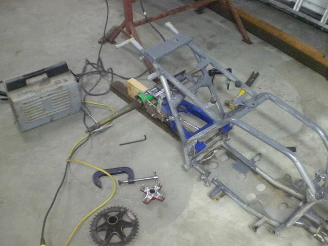

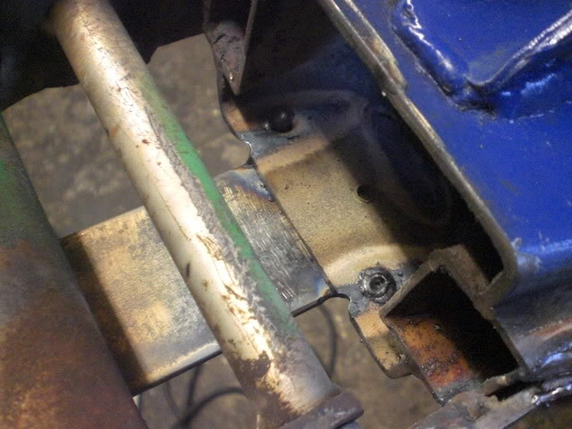

Just a few of the swinger on the quad. Was checking every thing is allined by eye first. I will be adding a support to the left side also, not going to be taking any chances.

Its coming along man, I'm taking a welding class and I have to say your welds look amazing! Anyone have any ideas on how its going to perform being a 4 stroke? I had a pocket bike like the one your selling. It was alot of fun, but then i grew 2 inches and then i started feeling like a giant trying to ride in a barbie jeep so i sold it for $100 US. what all do you have left to do on the bike to get it ride-able?

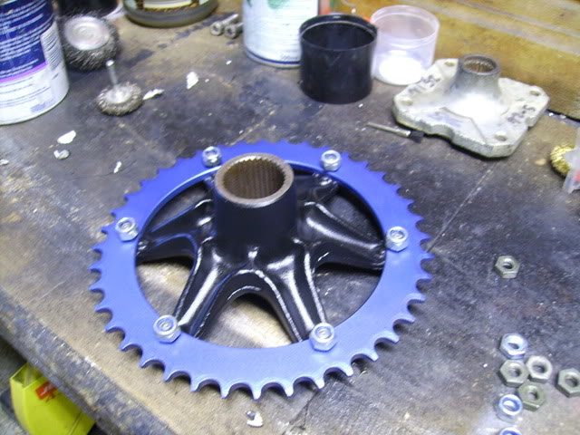

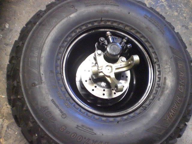

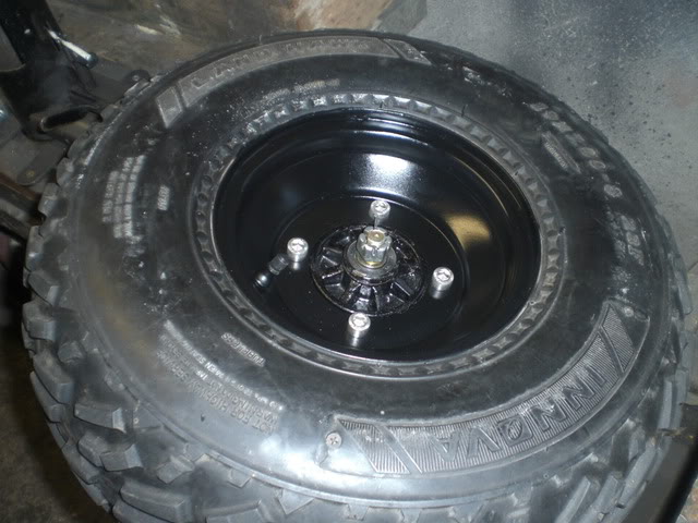

Very little left to do, just finish off the swinger, sort out wiring, and get a few bearings. Also need to buy a tensioner and mount it to the frame. There are a few more things to do, like buying battery and the hubs are causing trouble for the bolt pattern on the wheels been 4/110 and the blasters are 4/100.

I know people discourage this act but you could buy blaster rims and elongate the mounting holes 5mm each straight out from the center of the rim, that should give you the right bolt pattern. You would have to be very precise with them so you don't get high speed wobble tho. do you have a set of blaster rims you could measure to see if its possible? If not P.M. me and I'll do a little number crunching and see if it could be done. Hope it works out for you so you can sell it and get a blaster. If you have any questions about anything and need sizes I will be more then happy to measure it for you. then use google to convert the measurements so you understand what I'm talking about...lol

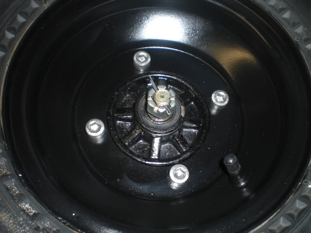

Thanks High tech, but i think i will go with a set of conversion hubs.
Started on the front wheels last night (12am-2am) one has serious rust and wont seat great with the pressure down after seating, so time for some fab work on that.

Will get pics of front wheels up later on.
