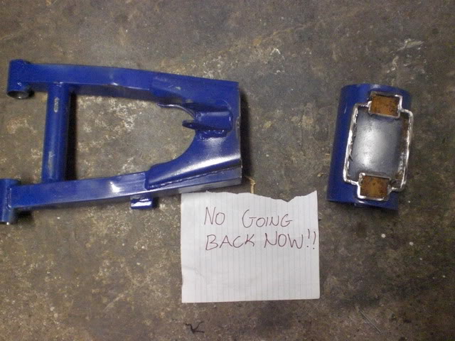

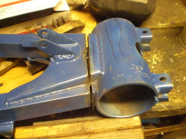

Im thinking of a few ideas.
: Take off the origional carrier holder, add supports of 6mm steel and secure 99 carrier in place ( sounds noobish, its just hard to explain.)
: Getting a 99 swingarm and cutting the china one at the joint to frame, and using the joints from china one
Have other ideas but not alot of thought gone into them yet.
Any suggestions are appreciated.
