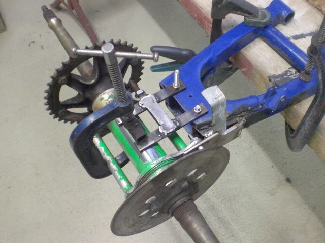

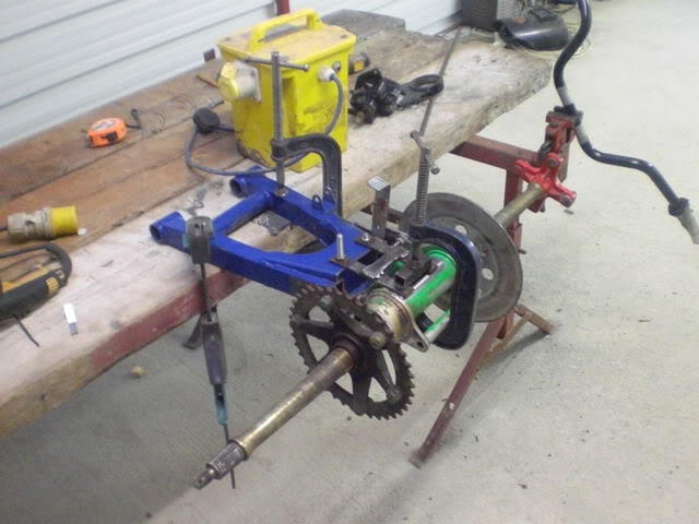

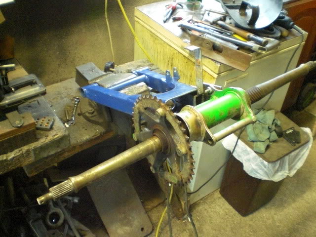

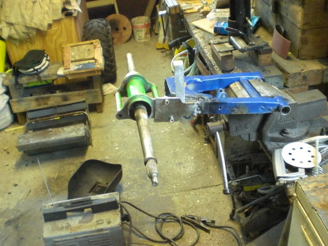

So heres what im at at the moment, bracket made up for RHS (disc) out of 6mm steel, the carrier will be bolted to it, hopefully getting the LHS done up during the week. Its tacked in place at the moment, too allow for adjustment. Im welding with 6013 and im aware of the quality that is needed for the welds here. Since the swinger is angled i had to add a piece (previous post) to level it out and easier welding. It is also extended from the origional. Mentioning the tension in an earlier post (scott) i will be using a blaster tensioner since the origional tension idea is gone. Im sticking with the 40 tooth sprocket but may change the driving one, not too sure what it is at the moment.

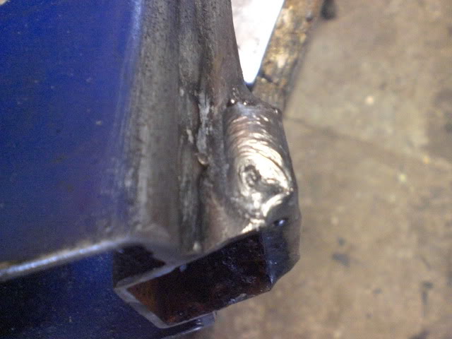

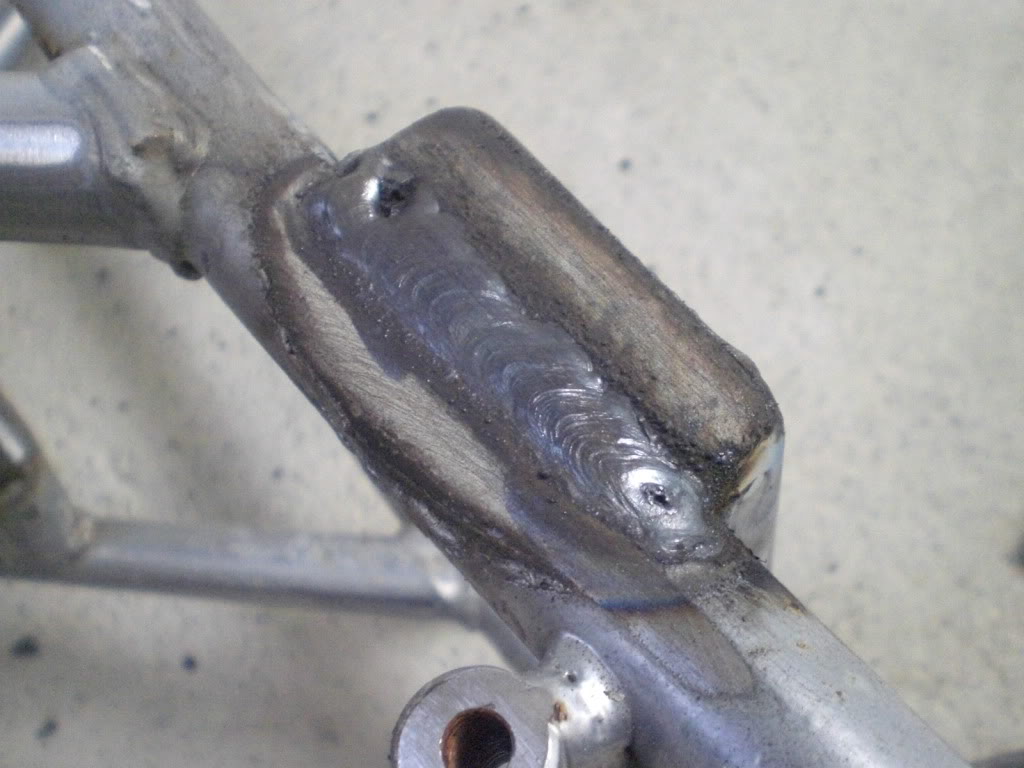

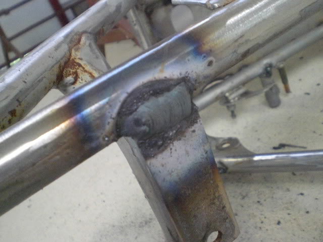

Taking a brake from the swinger for a little while. Re welding the frame now, since china man done such a terrible job.
Some of the welds

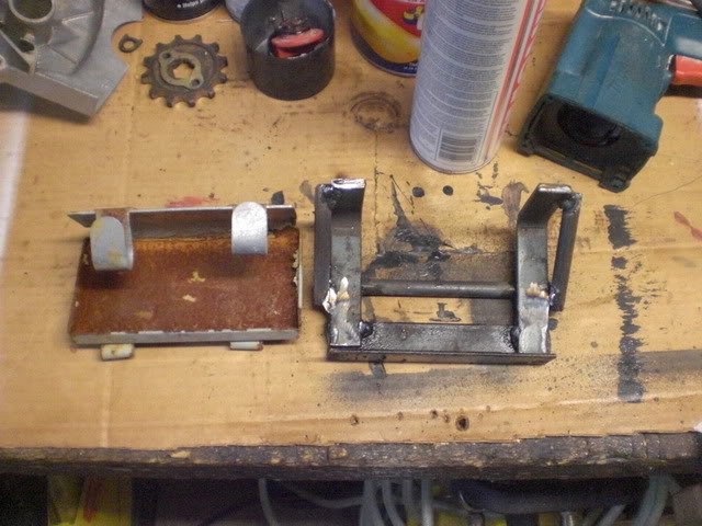

All welding done on frame, made a new battery holder in under an hour.
I'm a little confused on the swing arm. are you just going to bolt the carrier to the old swinger? think that will hold? I know it is bolted up on the blaster swinger but it is done in a much stronger way. I was thinkin you would just mate the two swing arms up to each other somehow.
ok i was just curious. thought that was what you were probably doing. just didn't want you to kill yourself tryin to ride it like that lol.

Hey Kieran, I'm still watchin. Things get busy when school starts up again, you probably noticed how slow the forum got and very abruptly too. I finally got to spend a few hours on my build this afternoon and most of it was wasted time. After welding the supports for the hydraulic rezzi, I realized that the exhaust needed to go through that spot so I had to cut it all off X( . I'll move it lower tomorrow and hopefully post some pics. By the way, nice welds I:I I wish I could get mine that clean all the time.
