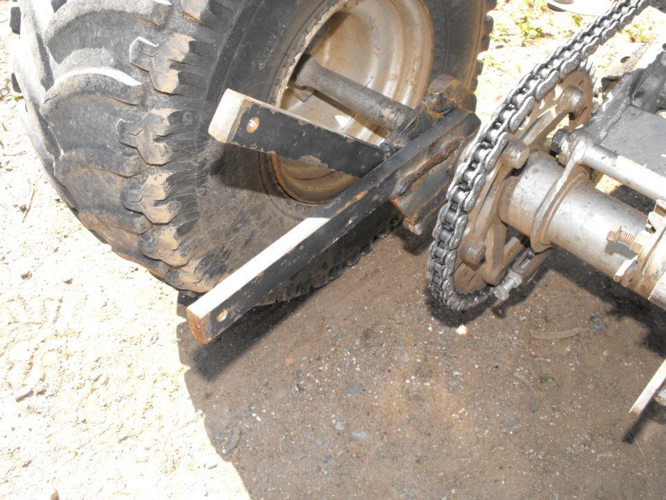

Progress came to a quick end when I met my maker in a stubborn axle nut. I found what might have been the largest wrench on the east coast and no luck, especially after bending the axle prying up on it !!! I guess it's time to price a replacement axle.....Worst part is I still need the damn thing off to get the old axle out. Actually started cutting into the nut tonight until it got too late for the grinder screaming.

FREEEEDOM ! I cut into the nut, broke it free, and finally got the axle out. New axle is enroute to my house and scheduled to be delivered today !!! I:I It's a stock banshee axle and I'm excited about the wider stance...my only question is.....Should I still use the 2.5" spacers in the rear with the wider banshee axle? Too wide????? Front has 2.5" spacers only.

I would use spacers still with banshee axle. It doesnt make it much wider at all.
Thanks for the info guys ! Axle is in, just modding the brake caliper and rotor spacing to make this work. Hopefully I'll have it ready for a test ride tonight. I'll post pics when done too !
So here are a few pics of the progress since I got it. Stock axle, stock with spacers, then banshee with spacers.
