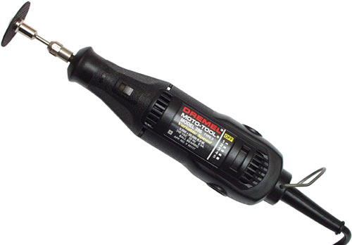

i use dremel and things like this i dont know the name in inglish

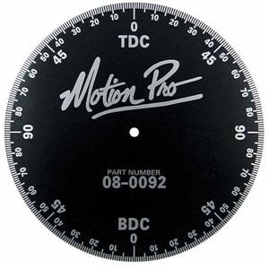

and i use a degreewheel from motion pro
