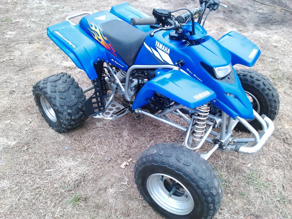

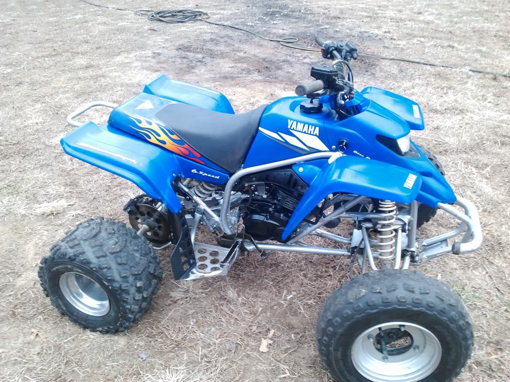

So back on topic. I took the bike for a ride today. Starting getting a lot of white smoke. I could tell from the smell that it was gear oil. The motor did run good though. Either my repair wasn't worth a sh*t or I missed a hairline crack. Either way I need to come up with some cases. Jaysblaster is trying to hook me up with them. So it looks l will be breaking the motor down again. That just means I get to port the cylinder a little better. My 6 inch carbide bit should be here next week. I guess I'll do the timing mod too. Fun, fun, fun! Here is a pic.
