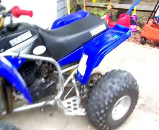

so i changed out the oil and put in type F atf.
Also pulled spark plug, the gap was like 0, so i set it to .028 according to the online manual... is that right?
Also, went to try and start it, and here's a video of what i got. when it runs it like backfires when i jump on the gas, wont stay idling just dies out. but here you can hear it backfire trying to start....
almost starts, backfires at 00:23
This is weird....
After that post i went out, and mixed the gas 40:1, closer to the previous owner's 44:1 and it started right up and ran OK with very minimal backfiring
Could it be that they way the quad is set up i need to run 40:1 or so to keep it running???

It could be the way the other guy had it jetted, have you looked at what size jets are in it yet? Could also be the fuel/air mixture screw.
i havent looked at it yet, i dont really want to get into taking off the carb and all that. I'm one fo those.. Might as well... guys. Like.. If i'm tearing off the carb, i might as well.... upgrade the carb, put new reeds in etc etc.... you know hahaha
but im guessing he jetted it out to go with the bored out cylinder and pipe and sh*t :)
40:1 seems to run really good, and his 44:1 ran no problems
