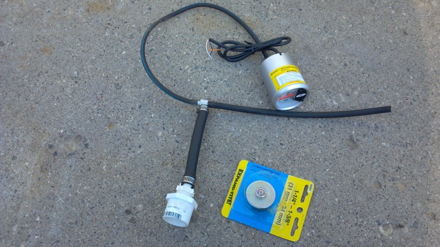

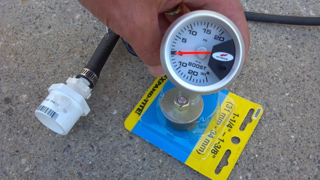

Got off my butt and built me a leak down tester..After digging through my tool boxes,I found everything other than the PVC and freeze plug so hit Home Depot and Autozone..Now I gotta get off my lazy butt and pull the clutch side cover off then see whats going on...

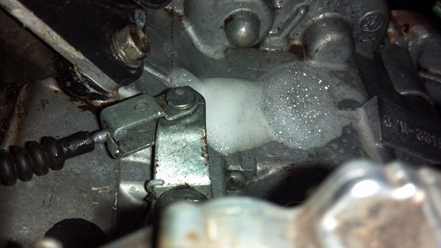

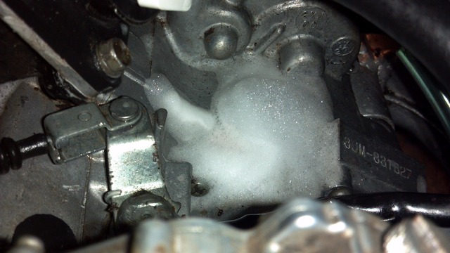

Soooo,I started the leak down test..Pumped it up to 7psi and with in 2mins,it dropped down to 4 1/2psi..Sprayed soapy water all over the case and leak down tester connections..Had zero leaks at the tester connections BUT,the only leaks are at the top of the case halves..I plan on pulling the engine tomorrow but before I do,I need to know if thats why its sucking crank case oil??If not,i'll pull the clutch side cover off and spray soapy water on the crank seal and see what happens..Heres 2 pics and you can see how much it bubbled from one pic to the other with in 30 secs,took 2nd pic about 30 secs after the first pic..

yes thats why it is sucking crank case oil. you may need to completely take the engine apart.
first off your clutch side crank seal is leaking. thats how air is getting into the transmission and out the top where you found bubbles. also burns oil that way
and secondly, there should not be a leak between case halfs. you will have to pull, lap and seal those again. which will take some time
Unless you have your trans breather whole plugged I don't see how a leaky collar is gonna push through the case halves.
IMO you need to split the case.

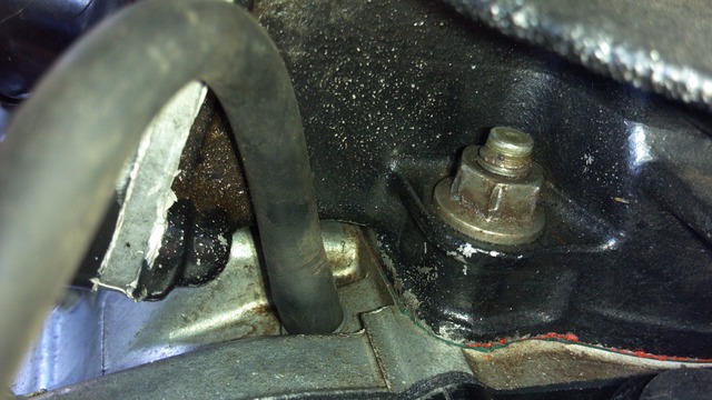

If you are talking about this breather hole,I had to block it off to run the air leak test...

There should be no reason to block that. you can do what blaaster said and put that into a cup of water and then do a leak down test and if you get bubbles your crank seal is leaking. If you do that and no bubbles you need to split the case.
