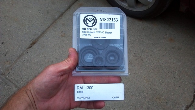

Whats the easiest way to get the seals out??Im used to car front/rear mains and they have a lip so you can use a flat screw driver to work em out..
Only found one youtube video and the guy used a flat screw driver..He tapped it between the case/seal and worked it out which IMO isn't a good ideal because it puts scratches in the case where the seal sits..
Whenever I do front/rear seals on cars/trucks ect,I always put a paper thin layer of RTV around the outside of the seal before putting it in..Do I need to do the same with theses seals?
The seal kit I bought is a set so should I replace all seals while I have the side cover off or is the crank seals the only ones that allow crank case oil into the cyl??
Seals and flywheel puller showed up yesterday so all im waiting on is the Yamabond which I hope shows up Monday..
Don't use rtv on the seals. They are tight enough when going back in. They won't leak around the outside of the seal. You can use a small screwdriver to get those seals out. As for replacing all the other seals, you can do them now or later. If they aren't leaking, no sence in changing them

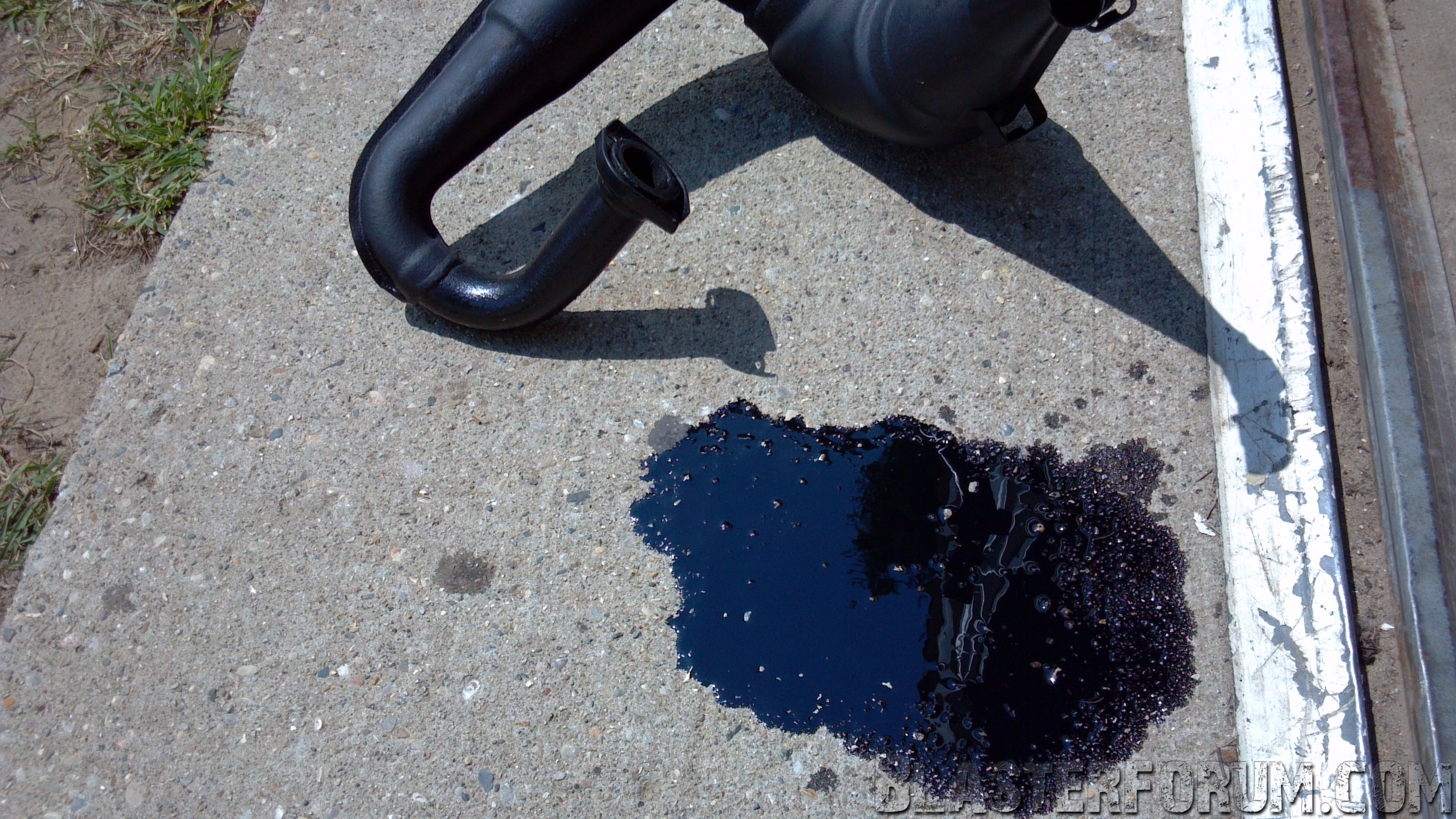

Took the pipe off and a bunch of oil poured out of it..Was more than this so now im wondering if the engine was burning whats in the pipe..Had enough in it that im sure it was sucking a little into the cylinder..Still going to get what I need for a leak down test but im also cleaning the hell out of the pipe then putting it back on just to see what happens..
