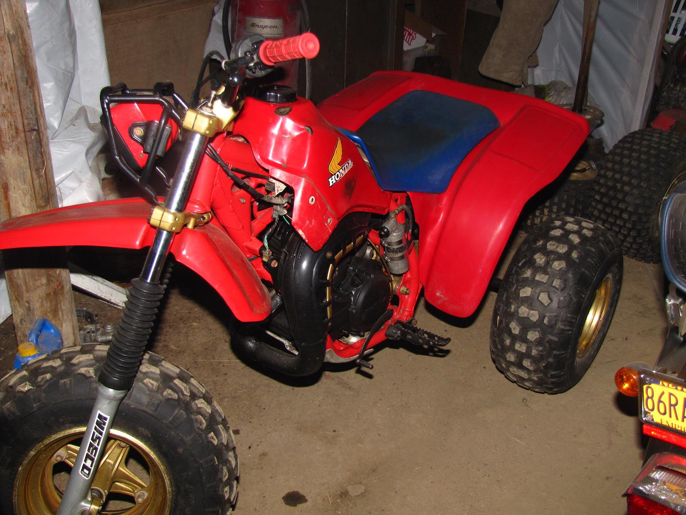

My 250R Fooler Collection

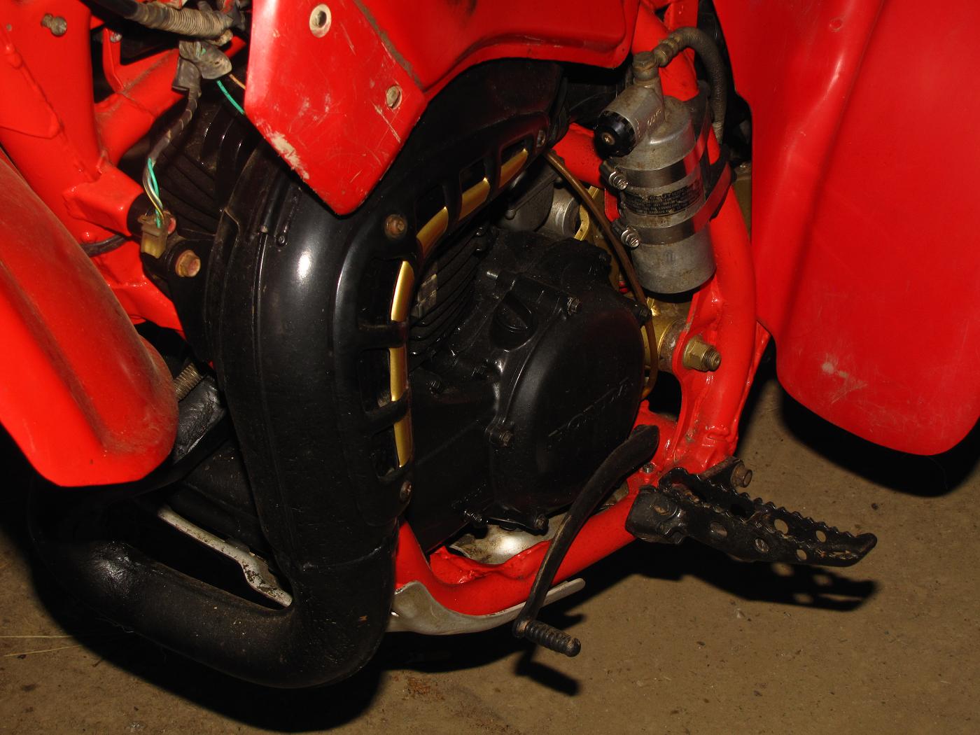

well known mods are as follows
Mugen 360cc motor
Sprock Mill work and bench testing
Mugen Head pipe and Ritcher Privateer race exhaust
32 tooth sprocket (Rear) 15 tooth (front)
+4 HR crank
FMF Modified reed cage with milled inlets and outlets for far superior petal flow.
Vintage DG 1/4" Torque spacer
Mikuni Flatside carb
Open Element UNI Air filter
1/4 turn twist throttle
18" rear tires

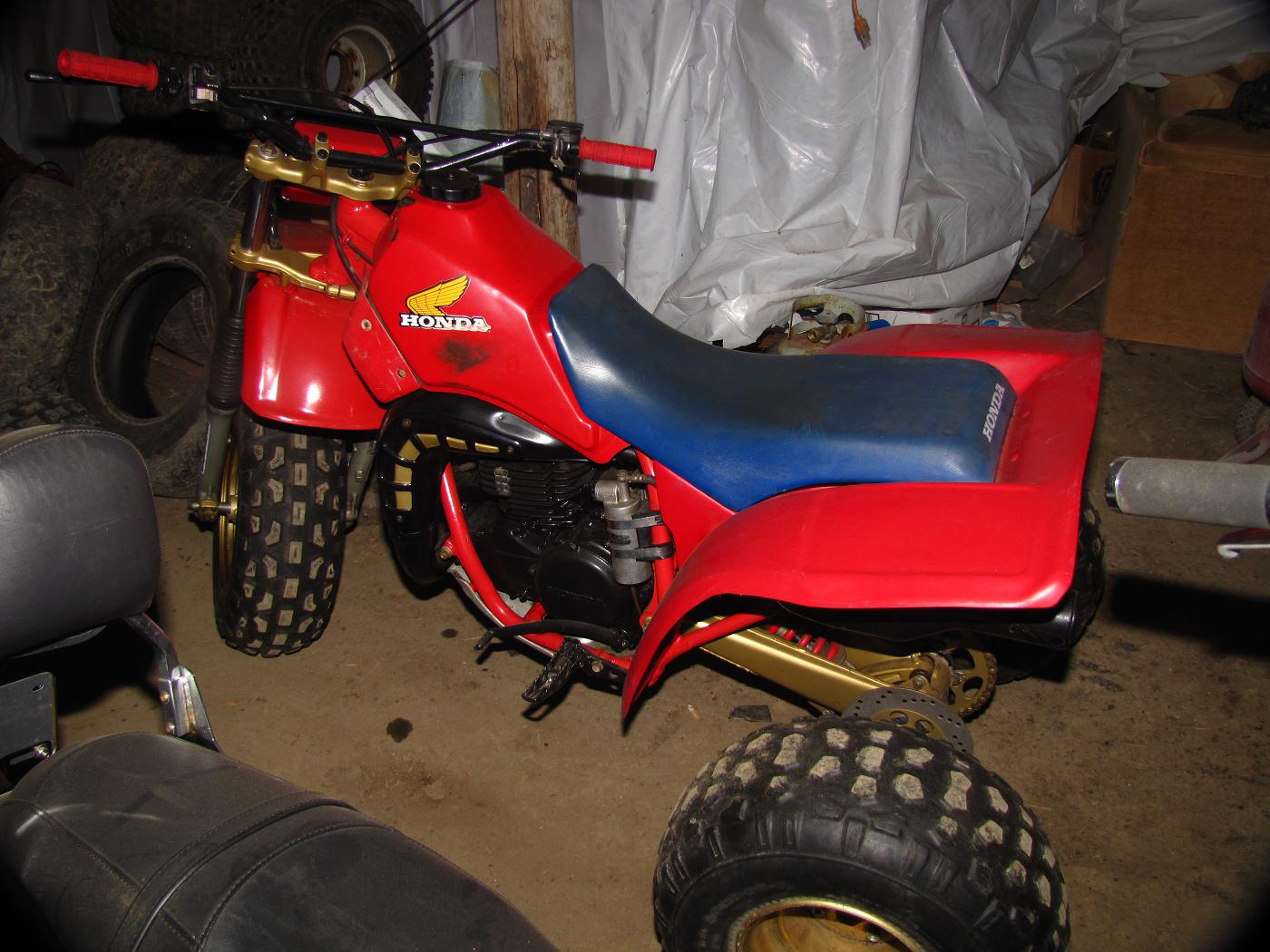

For power take off's:
Lowered 5 inches in the rear, stock up front
+4 NASA rear axle
85 Liquid R hubs (add's 1" per side)
And the ability to ride this thing the way it was supposed to be.
I think with a +6 swingarm, I could really let this thing loose. I don't think the machine would stay planted if I hammered it wide open out of the hole..I would be eating handlebars almost instantly.
